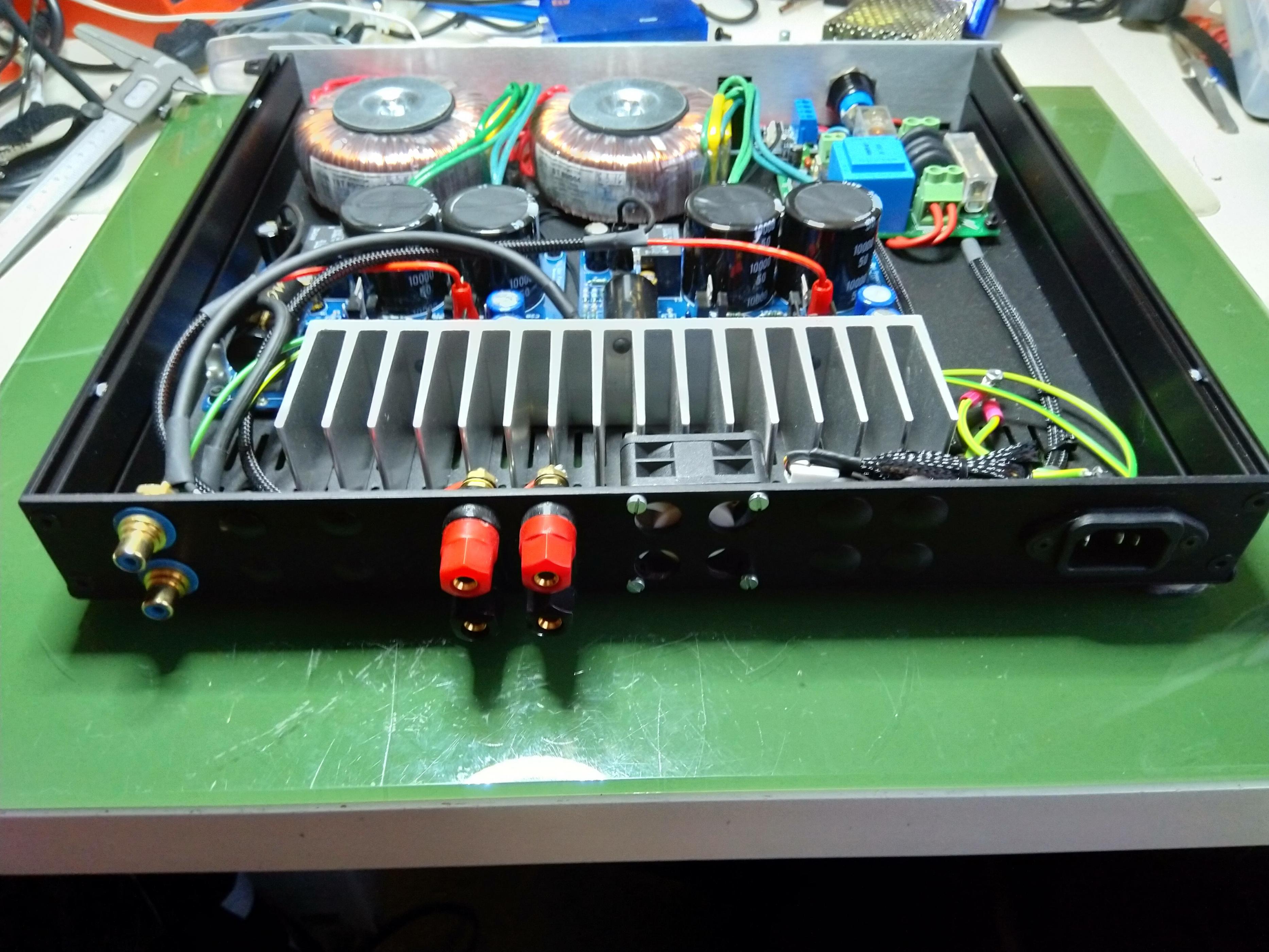

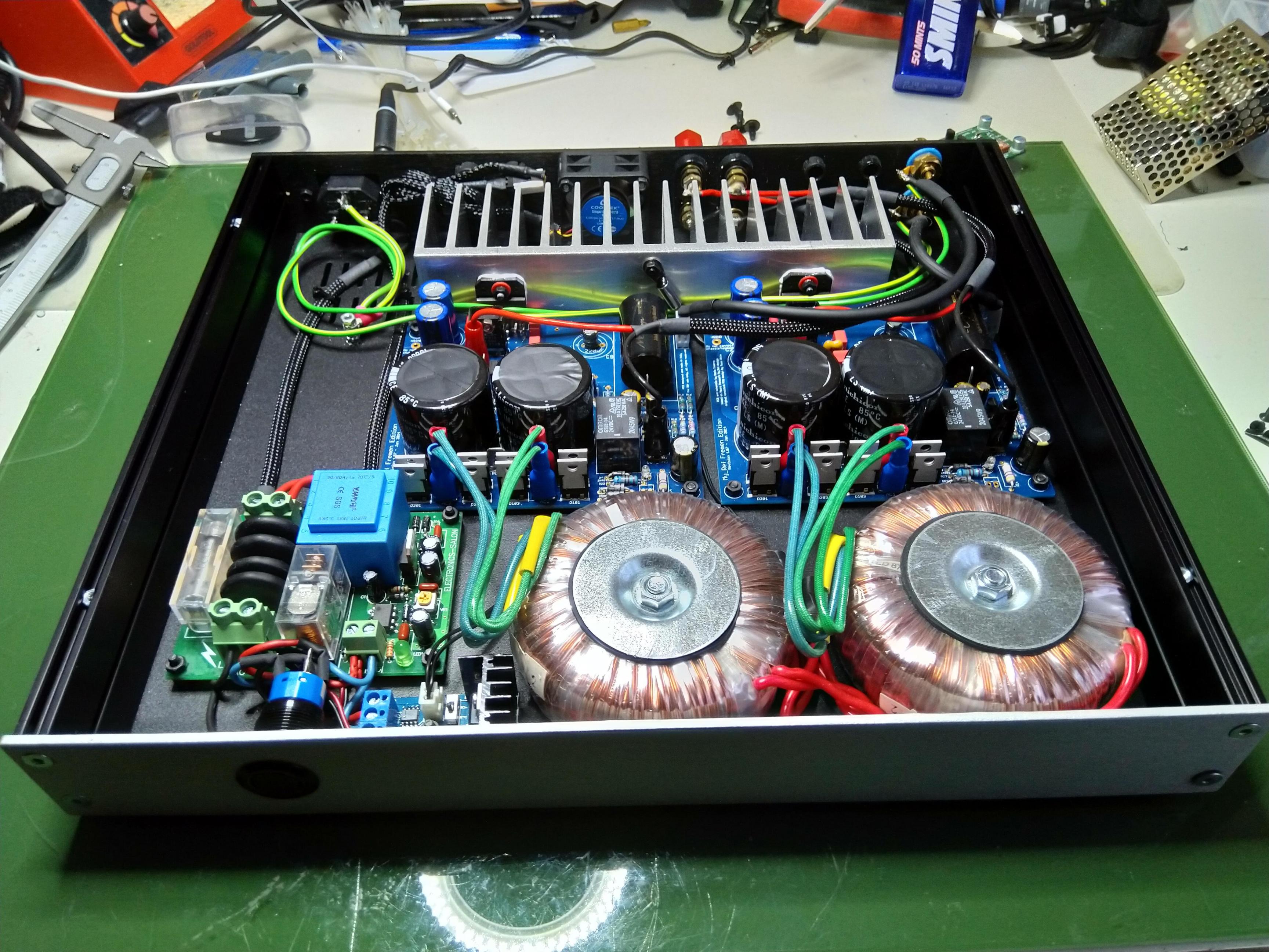

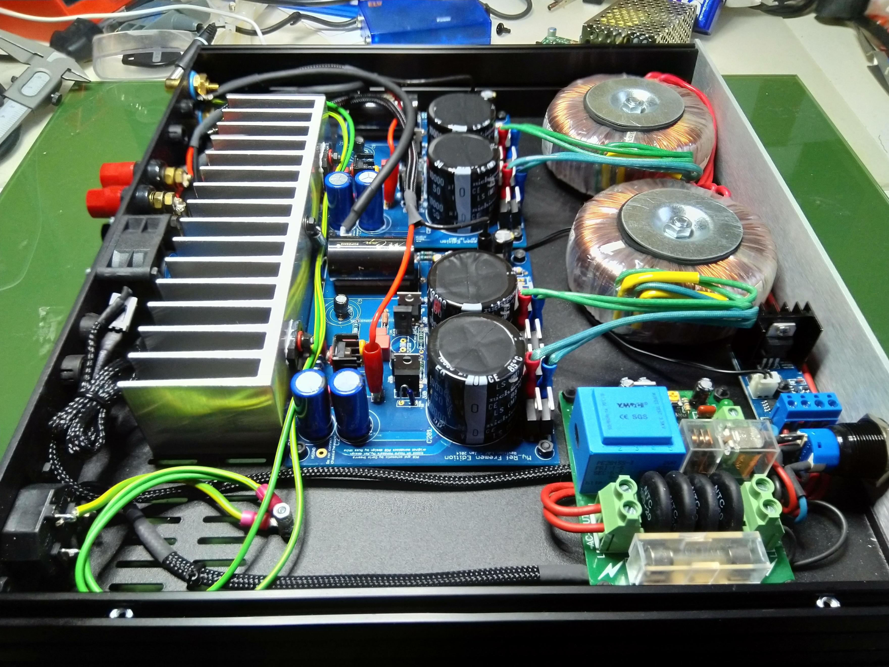

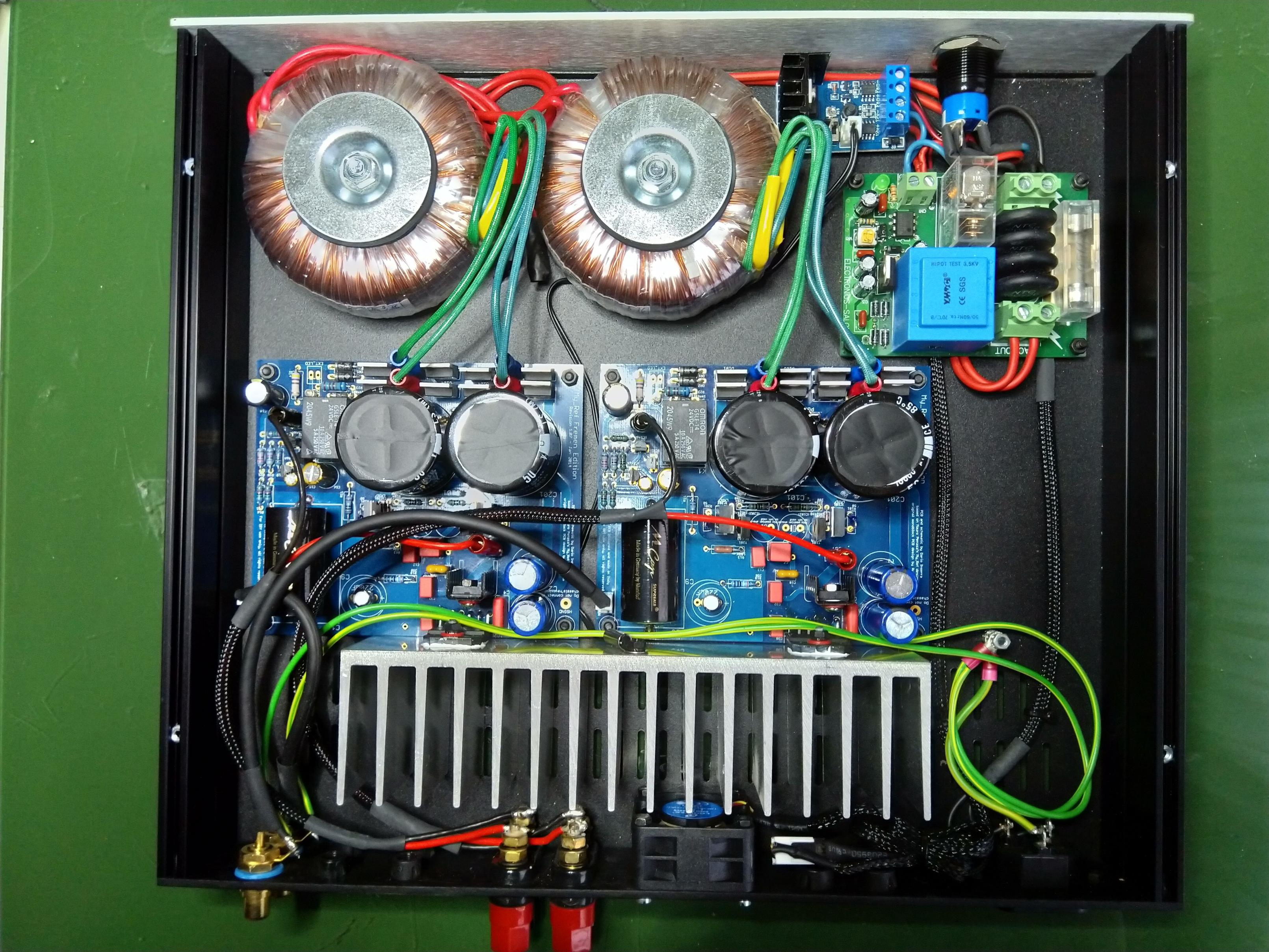

My build
Here some pictures of my My_Ref build.
I use for all my projects the Hifi2000 - Galaxy GX34x chassis, so I have to make some compromises.
But it works excellent!
Yep, a 40mm fan and temperature controlled.
Heatsink <35 degrees fan off. Above 35 degrees it gradually increases speed and at 55 degrees it runs full speed.
