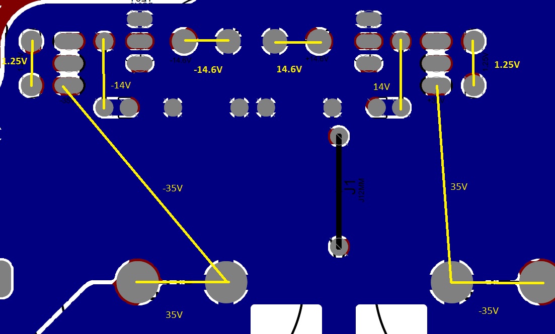

Bob, both ,modules behaved identically till yesterday. Everything was fine (only reversed q1 which I fixed).
Only odd value was 22 v instead of 35 , and while measuring it I could short poles with multimeter. Now on that board relay is clicking and dc offset shows presence on 4 v on output.
I know I should be more careful with everything and it is not making your help any easier .
I did not connect boards yet because I was not sure how 22 v value was bad to the assembly.

Regarding short on another board-
Dario mentioned if dc offset is high I need to replace lm318.
Plus one of lm317 is getting extremely hot, I ll swap it for another one.
Do I need to check anything else to make sure other components are fine ?

So, correct me if I'm wrong:
  1. Initially both boards measured 22V on LM317s input and one had a reversed Q1
  2. You replaced Q1, still 22V
  3. After shorting one of the LM317s that boards started to measure 35V but you have seriuos DC on output.
I'm missing something...

Ok. I powered board to check for sure if smoothing caps are 35. And they are
I checked all values.
Parts from *100 side measured: 1.26 (1.25) 22.7 (35) 14.1 (14.6)
Parts from shorted *200 side: 0.327 (1.25) 33 (35) 3.6 (14.6)
In a mean relay stabilised and stopped clicking.
I checked dc offset and what a wonder - it bounced from 35 mV to 2mV. So I waited a bit to cool it down and powered it again - dc was 3 or 4 V and got down and down with every click of relay.
So do you have these measures?

Dario, i was measuring 35 v between lm317 legs. If I measure it between leg of cap and lm317 it shows 35 v on good side and something like 70 vdc on shorted.
Update- I m wrong- I measured 70 dc on wrong pole- if I put meter on correct is shows 35 on shorted side.
