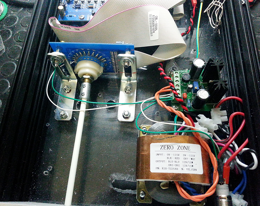

Hello, i use a Clone note as passive preamp/volume control for my setup. It performs very well upstream of My_ref FE amplifier, first of all it sounds very transparent and clean at any volume. I requested 10k impedance to Uriah.
BUT i suggest using a battery power supply for it, otherwise getting a TOTALLY silent preamp could require a bit of struggle. A single 9V or 12V battery with decent capacity should last for weeks - if not months, as current absorption is very low.

Luca,
Do you have pics of your Clone Note implementation? I still need to build mine. What power supplies did you try before settling on a battery supply?

I have few pics, as my house has been struck by earthquakes at the end of october, just 2/3 days after i finished assembling my Clone Note, so i couldn't take pictures of the final state.
The attached pictures were taken at work in progress and with 12V linear power supply.
N.B. If you opt for linear power supply, connecting LDR boards' grounds to Pot board's PS ground is a must to avoid hum at higher volume. No need for it if you use a battery as PS
Nice! Thank you! Nice r-core transformer. Sorry to hear about the earthquake. Hope you and loved ones are okay.

I purchased that r-core transformer (and many other) at James Wu's Hifi Store, in Aliexpress:
https://www.aliexpress.com/store/800514
or here: http://www.diyerzone.com/
They build very good custom hifi transformers using Japan-made high quality silicon-steel sheets and OFC copper wires. Quality is very good for the price, absolute silence even for high voltage ones. You can contact them via Aliexpress and request whatever transformer you should need.
