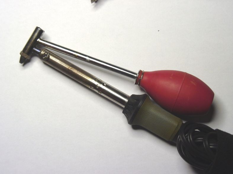

That's the answer I was looking for. There was a streak of the alloy/solder that smeared on the board and I wondered if holding down the part with tweezers while using a small tip vac/air nozzle was a cleaner process. I was considering modifying this tool, but it may be overkill. I'll have to practice some more.
