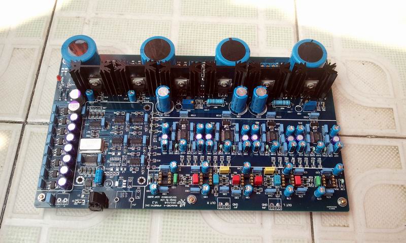

My WM8741 x 4 with DSD Project
I got a WM8741 x 4 DAC main board and I2S/DSD card.😀
Now, I want to connect them in hardware mode, so that it can decoding PCM / DSD file which is smoothly selection by footbar2000 🙂

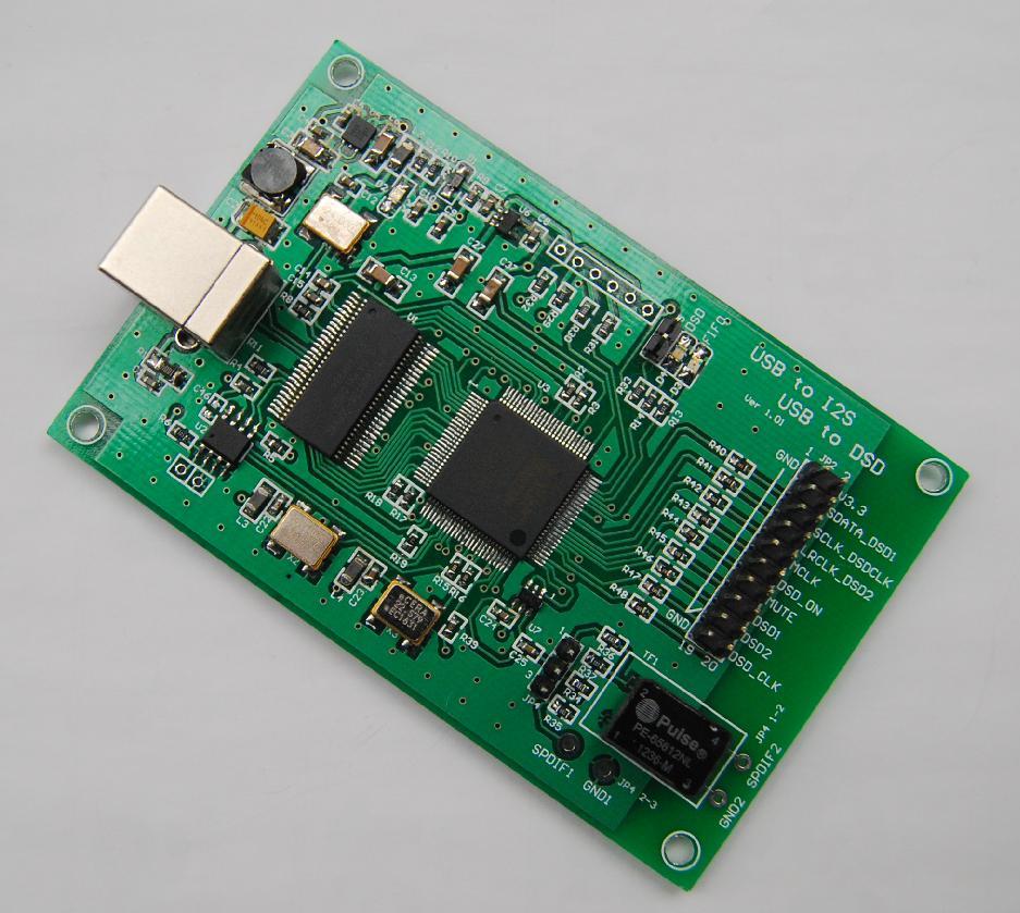

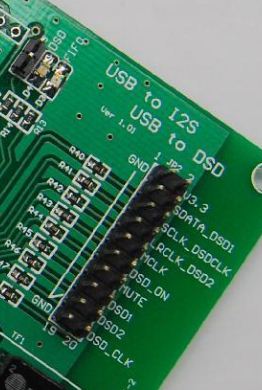

ref. to I2S/DSD card, the spec. which provide from manufactory.....
Technical parameters:
Input: USB2.0, high speed interface
output:
1) S / PDIF 75 ohm coaxial output
2) I2S
support sampling rates (PCM):
1) 44.1 KHz
2) 48 KHz
3) 88.2 KHz
4) 96 KHz
5) 176.4 KHz
6) 192 KHz
7) 352.8 KHz
8) 384 KHz
sampling rate support (DSD):
1 ) 2.8 MHz (DSD64) (DoP, ASIO native DSD)
2) 5.6 MHz (DSD128) (DoP, ASIO native DSD)
3) 11.2 MHz (DSD256) (ASIO native DSD)
4) 22.5 MHz (DSD512) (ASIO native DSD )
support digits:
1) 32 bit I2S output
2) 24 bit S / PDIF
output compatibility:
Mac OS 10.6 or above, Linux, Windows 32/64 WASAPI, ASIO, KS, DS drive
recommended player: Foobar2000 etc.

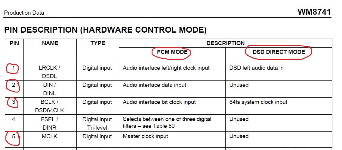

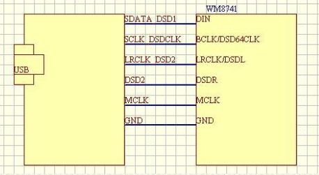

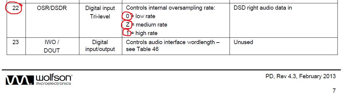

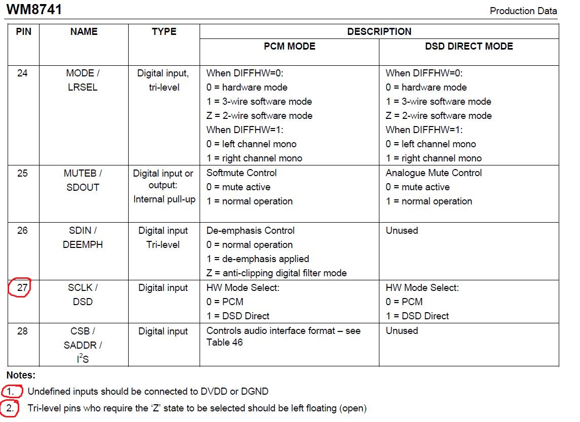

Double check with WM8741 datasheet.......
I found that must need those data input.....
Let's go..... try to connect them.... hope it is work.
