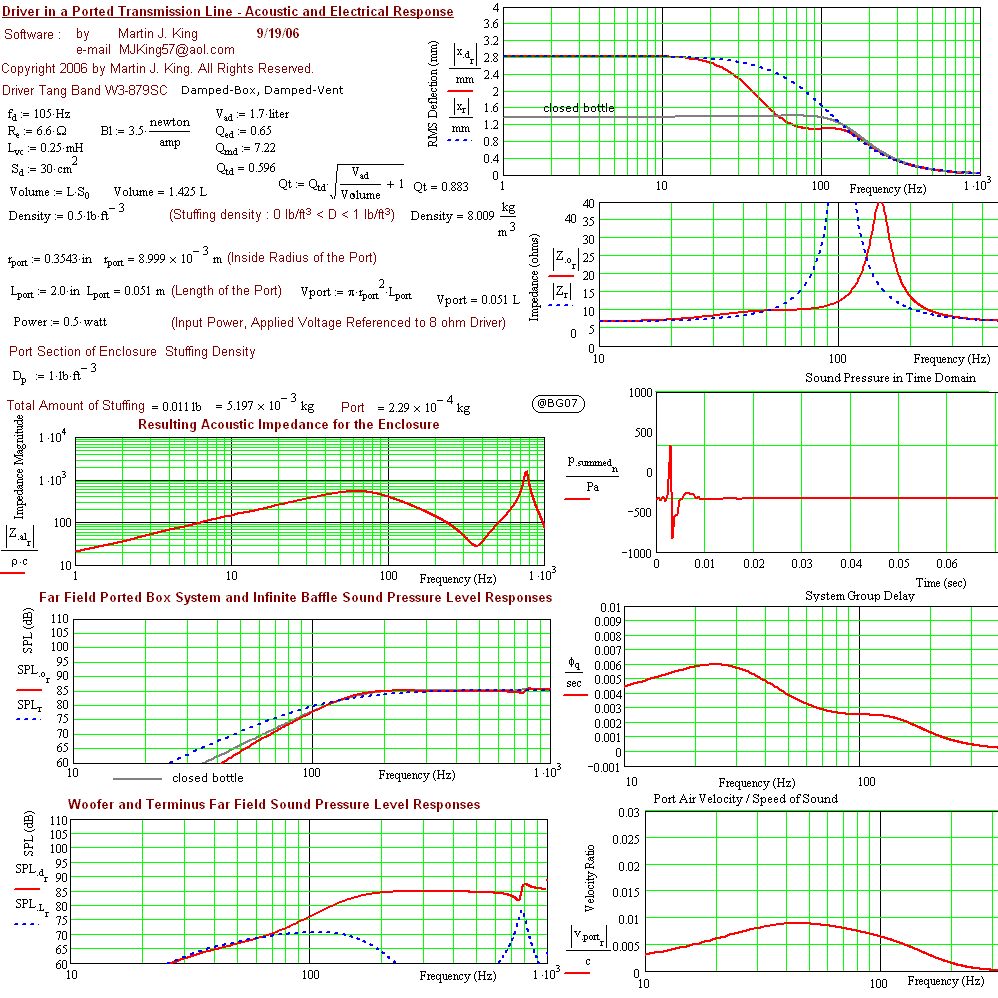

Hate to hijack, but did you use a notch filter of any kind?
I'm using the W3-879SC is a 2.1 computer setup and right now, they don't have any type of filter, and I'm having trouble finding other projects using these drivers.
They sound good, but I'd like to have a optimal setup if it has been designed.

Great ingenuity on your part. I love the curvature of the rack.
How do they sound without the corks?
I would think that they would act like mini transmission lines if the ends were open to the room air.
