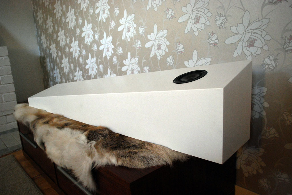

following the cnc crisis, i have started building of the lammed version of my qwt design:
the 'stepped' lams im using to build my speakers. each one is 25mm thick, with the depth of the section diminishing 6mm with each new section. this is the bottom-most sections of the box. there will be a large amount of solid MDF at the bottom of the box and this is advantageous to stability. This should also be conducive to providing inertial resistance to low frequency movement, coupled with spikes should provide good LF 'tightness'. ply would be used if i could get some decent enough and didnt think it was wasted in this app.
these 2 pic show the lams im using to house the crossover in. there will be 5 lams like this in total yielding a space of about 5"x5"x5" fot the crossover components to sit in. when nearly all lams are assembled, all but the last 10 or so, the sides, baffle and rear panel will be glued to the respective edges. this is provided of course that the edges are level enough. if not the belt sander may have to come out of retirement! the last few sections will be glued directly to the other lams AND the rear panel , since they would be too thin to do otherwise.
the exterior cladding may be good ply, if i can get some, or failing that MDF or butcher block counter top,although the latter is a tad expensive....
