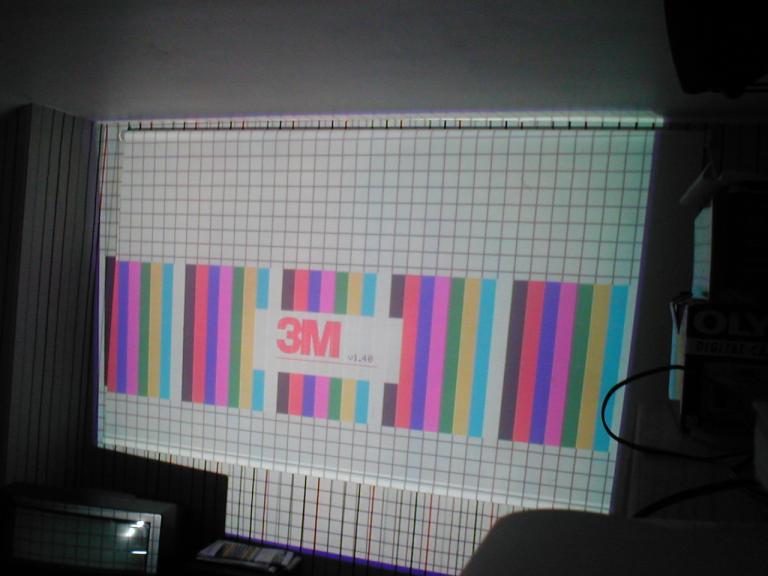

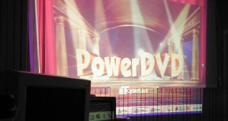

I'm using an Elite 6000 OHP.. thanks kikking out 7000 lumens
and a 3M Panel dDunno what type.. its not mine 🙁
Anyway thought I'd share my images with you all.
...Oh... I do have a question... movies play ok... IE they fit on the screen, is ther anyway of making the windows desktop fit on the screen?

Great Job!
Mick
Good going!!
This may seem obvious, but you will either have to move the OHP closer to the screen or get a bigger screen - NEARLY all OHP's do not allow you to zoom the image to fit - most DVD movies will look okay as they are 16:9 ratio, and so use a lot less of the screen.
Some graphics cards allow you to adjust the on-screen image size - you might want to check out free downloadable shareware called "powerstrip" - this might allow you to do the same.
