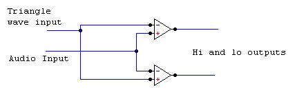

Hello SFX , i have gone through ur schematic , it looks very different as far as comparator is concerened . i think there is no need to get inverted Triangle output because using 2 comparators one can still achieve out of phase hi and low outputs
PLZ Glance on my circuit.
PLZ CORRECT ME IF I AM WRONG.

The previous Post applies when , we dont want to implement Crown's BCA topology.
In my case i dont want to use BCA Topology , thats why i have suggested that modification.
Secondly, Feedback is not present , can we say that THD levels are well below 1% without feedback or Feedback might be neccessary to reduce distortion as it requires additional error opamp.
AT last U said that BCA requires in Phase signals , if this is correct then the lo and hi inputs of individual gate drivers must be tied together and therefore there is no need of inverted triangle in case of half bridge operation. Only one comparator will do the job.

For the whole audio band, 250 kHz is enough. The professional Crown amps also have only 250kHz. If you have a close look at the BCA principle, you will realise, that the effective frequency is 500kHz.
Nominally, both PWMs are on at the same time, at 50% duty cycle, so they cancel each other out.
The output voltage is proportional to the difference in duty cycle between the two in-phase PWM signals. So you'll get a short pulse at the beginning, then both are on, so the result is 0, then again a short pulse. The base frequency doubles, but all active parts run at base frequency.

I also don't really like my VGnd solution, but I didn't see a better way for this specific amp. I wanted to have a singe power supply (well, I ended up with 2, one 12V regulated, and one 35V). My trafo just didn't have a balanced +/-5 secondary. My next amp will be some bigger, multichannel amp, and I'll by the transformer for it, so it will have proper balanced supplies. My main problem was coupling the Audio input to the circuit - it works fine over the capacitor, but at power on, there is some potential on the input, until the cap is charged. Not very nice... Also, I will design a PCB for the next one, so I can have a Ground plane, too.
And why dual supplies for the output? Mainly I wrote so much about it, because people kept asking about it. I also like my bridge design, that's why I made it. Nevertheless, in a multichannel amp, it's probably simpler to invest more into a dual supply, and save at the output stage. Afterwards, you can still bridge the outputs, if needed.
1.) no signal
____----____----____----____
output:
____________________________
2) positive signal
___------___------___------___
_____--_______--_______--_____
output:
___--__--___--__--___--__--___
good, ey? Shame that it's patented...

sfx said:Hi Timo,
Thanks for your tips. I'll definitely have a look at the Wave Generator you suggested. Could you please check the link to the schematic? It doesn't seem to work.
The advantage with inverting the triangle instead of the signal is that you can use on modulator for many channels, you only add more comparators. Doesn't really matter in my design, though... it basically came from the fact that I used this Quad Opamp for the modulator, so a spare opamp was handy, and very close to the triangle output... it gave a nice and compact design without too many interwoven signal paths.
1.) no signal
output:
2) positive signal
output:
Regarding the driver, I think my solution with discrete FETs is ok. The IR2112 have matched delays (30ns, I think), and the signal paths to the gates are extremely short and of equal length. The MOSFETs are all the same - I just assume they have similar speed. Apart from that, the timing is not that critical, since deadtime or shootthrough doesn't exist in this design. The only thing you will maybe get with mismatched delays is a slight DC offset, but I couldn't find any in my prototype. I'm a big fan of BCA - nothing can go wrong 🙂
Felix
PS: yeah, my little submarine is absolutely interesting! Here's a link, if you're interested: click here
The case of the amp is of course not from this one, but an old one from our bigger sub: bigger sub
As a manufacturer i will not use BCA topology because i.e. will be a cheating, which i dont like.
with regards
ampman

absolutely right, I'm not going to sell any amps I build, I only build them for myself (you can never have enough amps 😀 ). Don't get confused by my little website, the flashy appearance was more a joke, because I was bored 😉
I totally agree that it is wrong to try to sell BCA amps without a licence. Personally I'm not a big fan of the concept of patents (I know, I know...), but that's how it is. At least we can still build it as hobbyists, which is good 🙂
Primarily this is a do-it-yourself forum (at least the name suggests so...), so, if not otherwise specified, I assume these comments are from non-professional hobbyists. Don't get me wrong, I don't mind professionals here at all! There is always something to learn around here, especially from pros.
This was the first amp I ever built, and I am happy that it worked straight away - unfortunately I don't know it's THD. I've done THD measurements with my PC already, but due to the bridged design, I can't really measure this amp. If anybody can tell me how I can measure it without having a proper ground, I'd be very happy to do it. I'm curious myself...
I can't comment much on classical class D design. I did some initial experiments on breadboard with 'classical' modulators, and quickly realised the problem with deadtimes and zero crossings. Then I found this thread, built my amp after the ideas circlotron posted here ages ago, and was happy ever since.
Nevertheless, I once had an idea how to circumvent shoot-through completely in a classical topology. But I'd first like to rethink and try it, before I post absolute nonsense here... it's just an idea, so don't get too excited about it.
The HIP2100 look indeed nice. If they are indeed cheaper than the IR2112, you totally convinced me 🙂
Felix
