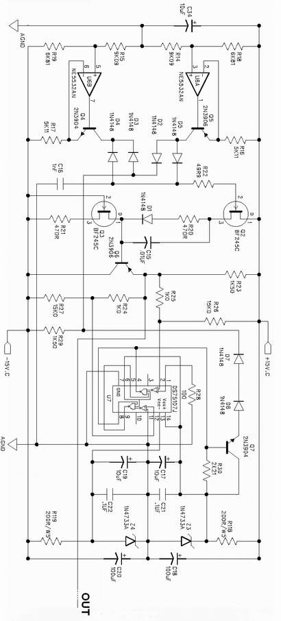

Hi all,
BTW, I have decided after much though that I can very easily convert my circuit to full bridge. Then concerns over PS pumping from DC offset (200mv without adjustment pot) and low frequencies will be gone. I hope to post it soon.
Hi all,
Hi all,
OK, I have decided that I can easily use my style of p2p circuit construction with the bridge circuit by stacking one IR2113 on top of the other😱 The lower mosfet driver supply and the signal input supply will be common and shorted together by the two pins. The bootstrap supplies will be separate. The four mosfets can be very close together.
Hi IVX,
I think I see where the LM319 goes. Remember also, that it is limited to only 36V besides of the maximum current rating of 25mA.
Hi IVX,

<Maybe some PNP level shifters with parallel coupling Cs for speed would do the trick.>-just add cap! good idea also works perfectly - i checked simulation. THX Charles! 😎
Hi IVX,
Maybe capacitors across the gates of CMOS are not really needed in DT circuits. The simulation shows very little jump in voltage with a 1N4148.
Here is a question. If the output has a 1.5% difference in amplitude between the + and - peaks, does that mean there is 1.5% distortion?
Best Regards
Best Regards

<Maybe capacitors across the gates of CMOS are not really needed in DT circuits.-ok, maybe, but resistor for adjusting must be 100-200k, it's always worse protected from EMI. Don't touch such gates of CMOS by scope probe however.
< If the output has a 1.5 % difference in amplitude between the + and - peaks, does that mean there is 1.5 % distortion? -
maybe it's a DC offset?
I wanna find any idea about discrete driver solution, especially voltage shifter from low side to flying high side(i was try bs108 n-mosfet .2A). Gate drive MAX5048 (12nS@1.5/7A-1nF ) probably.
Best regards.

< If the output has a 1.5 % difference in amplitude between the + and - peaks, does that mean there is 1.5 % distortion? - maybe it's a DC offset?
That was one of my thoughts until I tried it with the input at 0 volts. What I determined is that the current mirror was the cause. Instead of adding a resistor in series and a capacitor in parallel with the the base / collector connection of the control side of the current mirror to keep it more at constant current output, I removed it from the circuit. I don't want to just add more parts whenever there is a design flaw. I usually backstep to find a better way.
<I wanna find any idea about discrete driver solution, especially voltage shifter from low side to flying high side(i was try bs108 n-mosfet .2A). Gate drive MAX5048 (12nS@1.5/7A-1nF ) probablyBest regards.
I considered a small mosfet like that driving a low side mosfet driver. It is a possible experiment. I think the pull up resistor on the gate can be bootstrapped instead of connecting it to the positive rail.
If it can be sucessfully bootstrapped, that could make a big difference on rise time because the pull up resistor could be much lower in value.
Best Regards.
