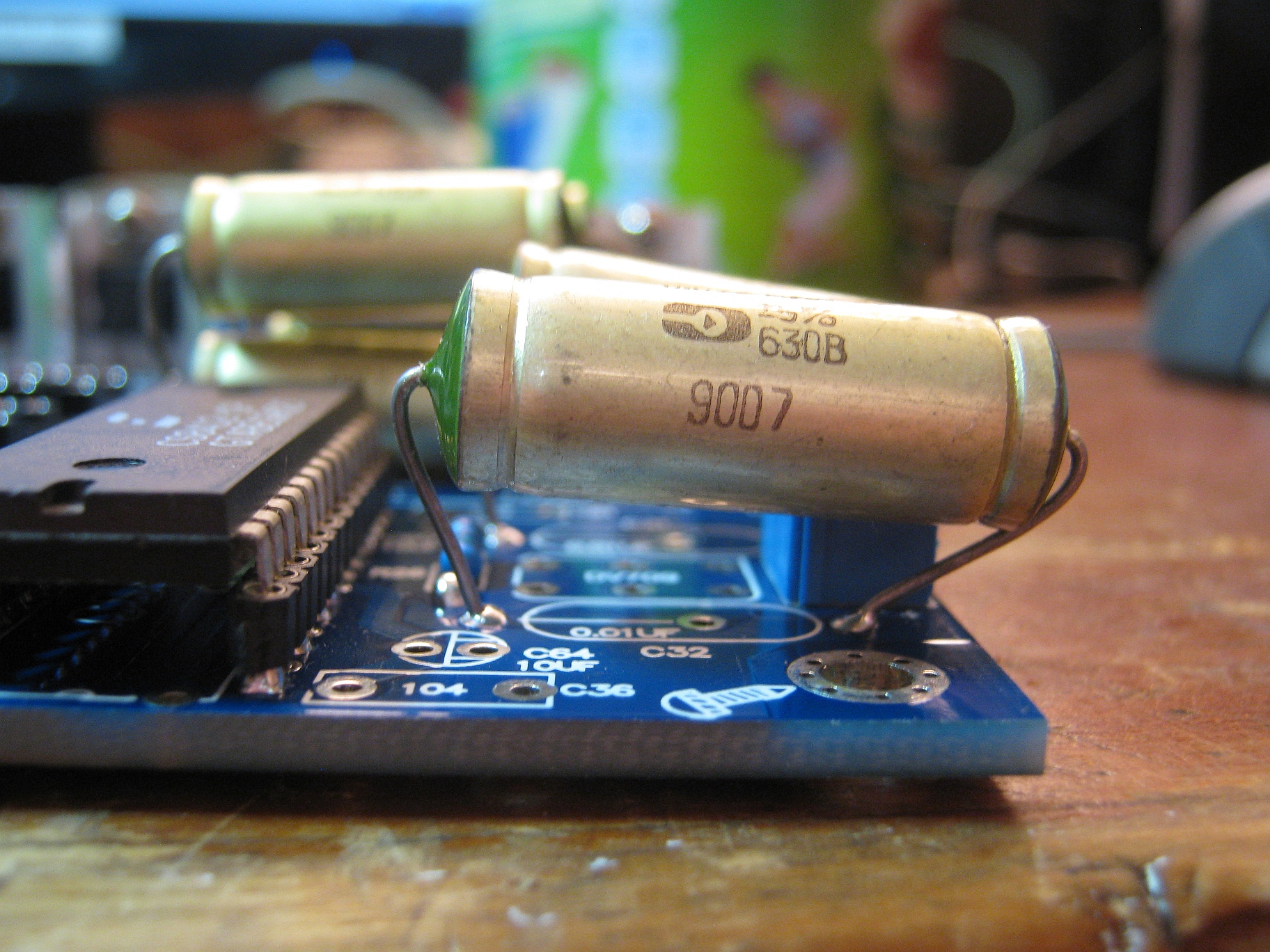

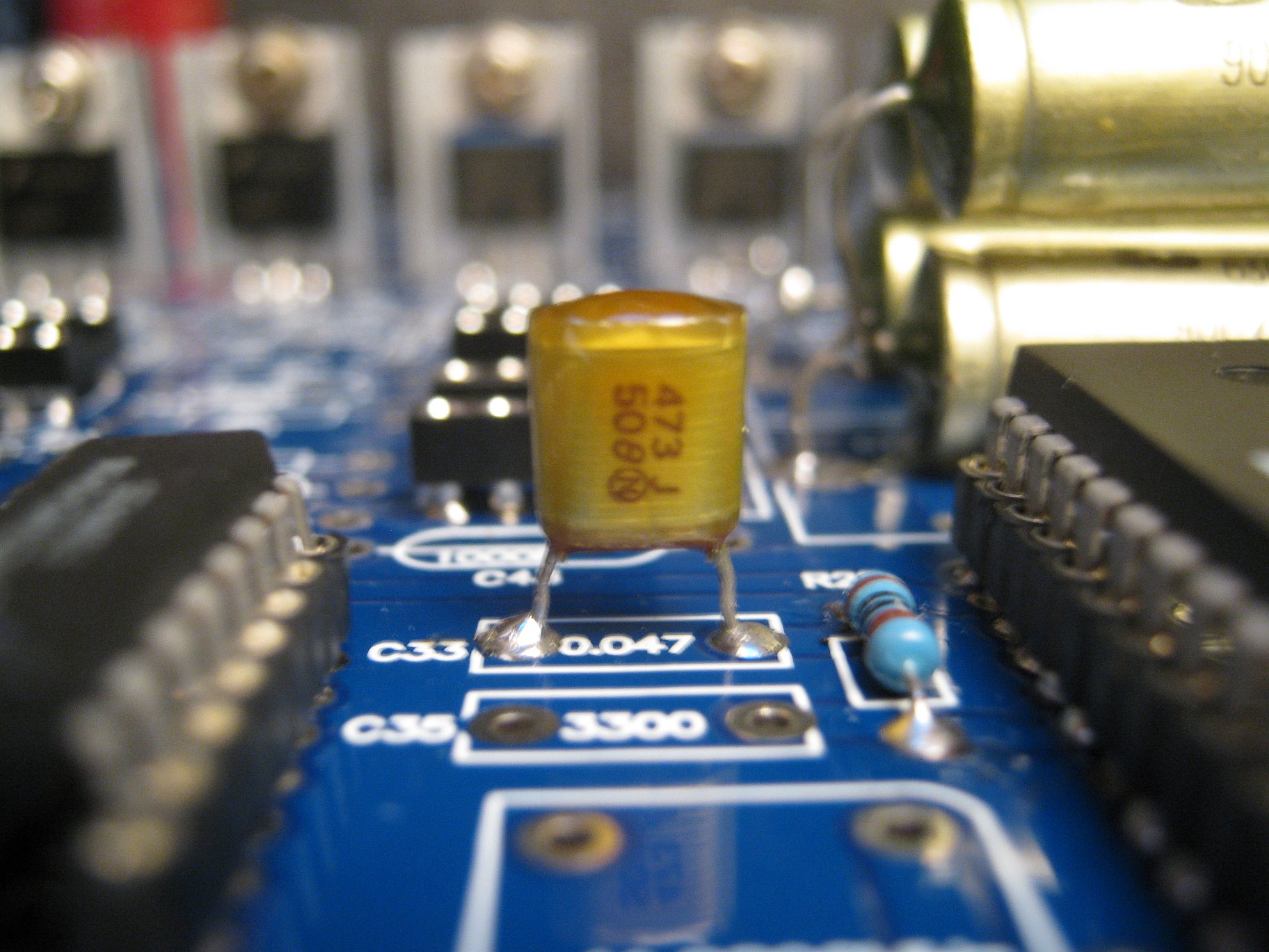

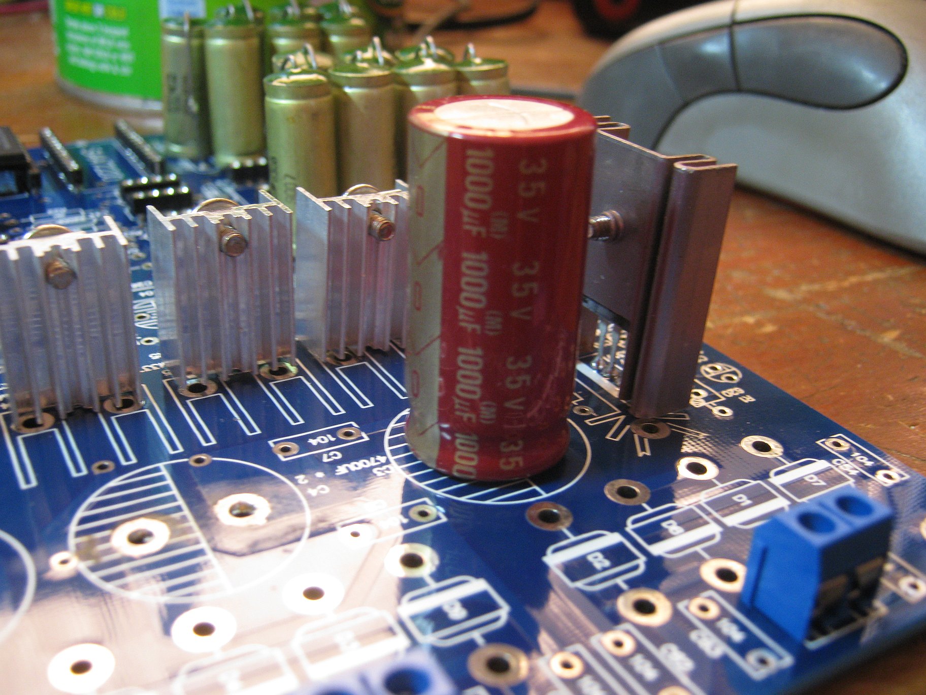

Decided to pull the 6800uF Panasonic caps out and replace them with whatever Elna Cerafines I have left, I only have 2x 1000uF 35v Cerafines so i'll use those where they can do the most good, in the TDA1541 power supply section (Pos Bus Q7/Q3/Q4 & on Neg Bus Q5/Q6 on Windings 12vAC & 15vAC) May not be enough capacitance and I'm aware of that issue. will measure voltages once running. I've read that LM317's/78xx's prefer a bit of ripple anyway/work better.
Pics of things done today.
One thing that I want to mention, this board is pretty much completely reversible back to its new condition, the PCB is SO THICK that you can solder suck the capacitors out, use some Goot Wick to remove the rest of the solder, heat up the pad and then use a tissue to wipe down the board and the area around the pad and the pad itself will be returned back to its original starting point, if you like cosmetics and like to keep your PCB boards clean and like to be able to clean them up after you've done a good job and make them look good then this is the PCB board for you!
Installed some resistors.
For some reason can only seem to find one Elna Cerafine, I thought I had two of them, I must've lost one of them somewhere. 😱 Anyway I put the one that I could find into the circuit. Will have to source 3 more of them which I'm not happy about. I'm sure the other one is around somewhere.
I added jumpers to replace the DV transformer.

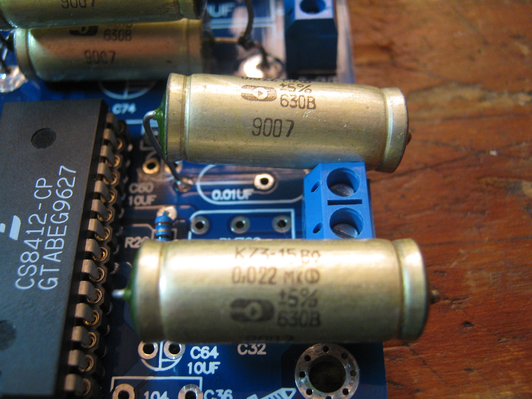

I also added 2x 0.022uF K73-15 caps to couple the SP/DIF input into the CS8412.

I have already agreed to use 0.470uF MKT Films.
However I have 0.022uF K73-15's in there as decoupling caps at the moment, we can start from there and move onto the MKT 0.470uF Films. Then move onto Polyester or Paper in oil.
I also want to buy some 0.47uF K73-16 capacitors to try the PETP caps out in a higher capacitance value for decoupling caps but they are proving to be difficult to find.
Then after that I can swap out the 100uF Elna Cerafines for Black Gate 100uF caps.
Will also be trying out the 22uF Russian k73-16 PETP caps for coupling purposes. (I'm expecting them to be epic).

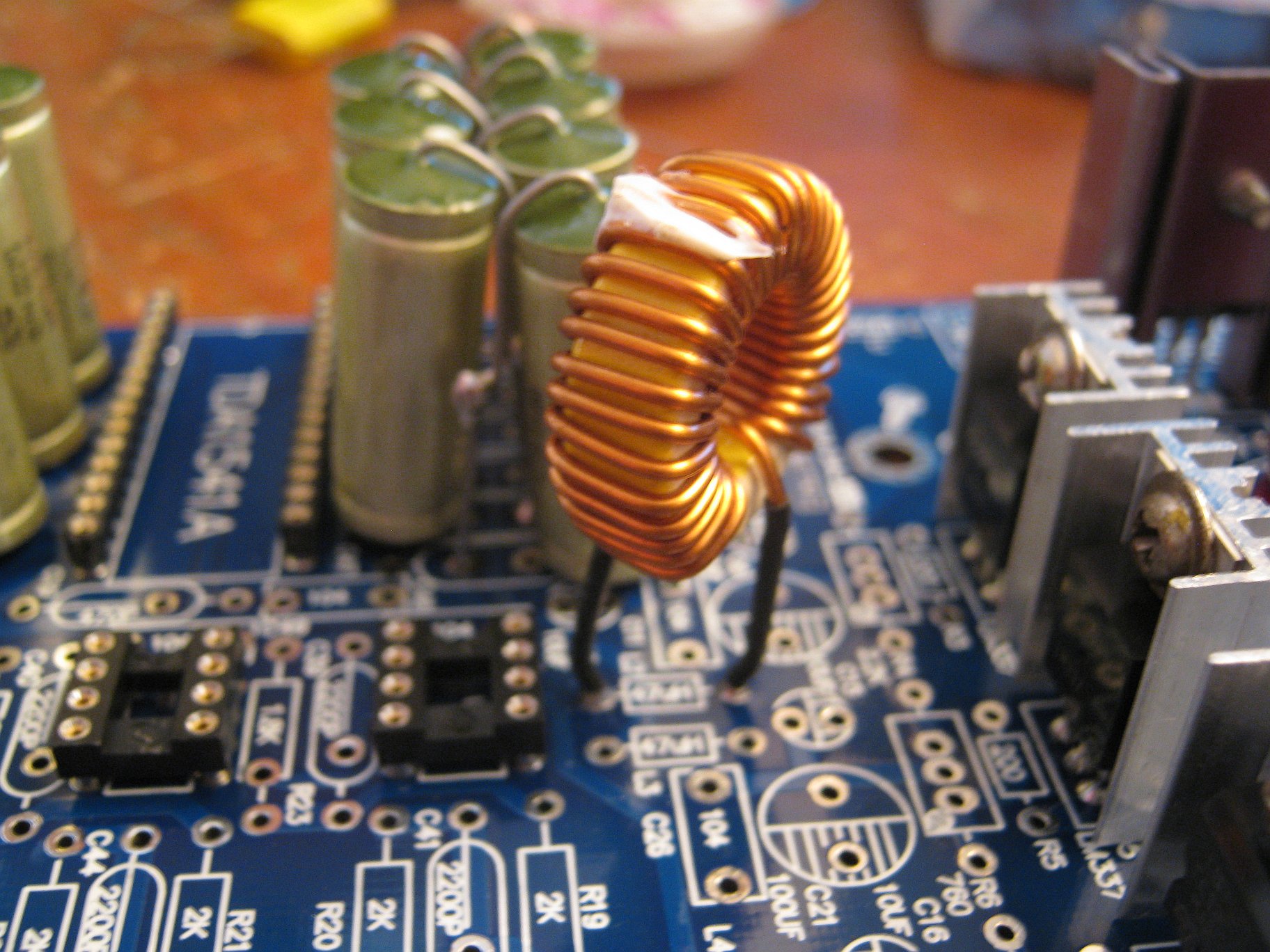

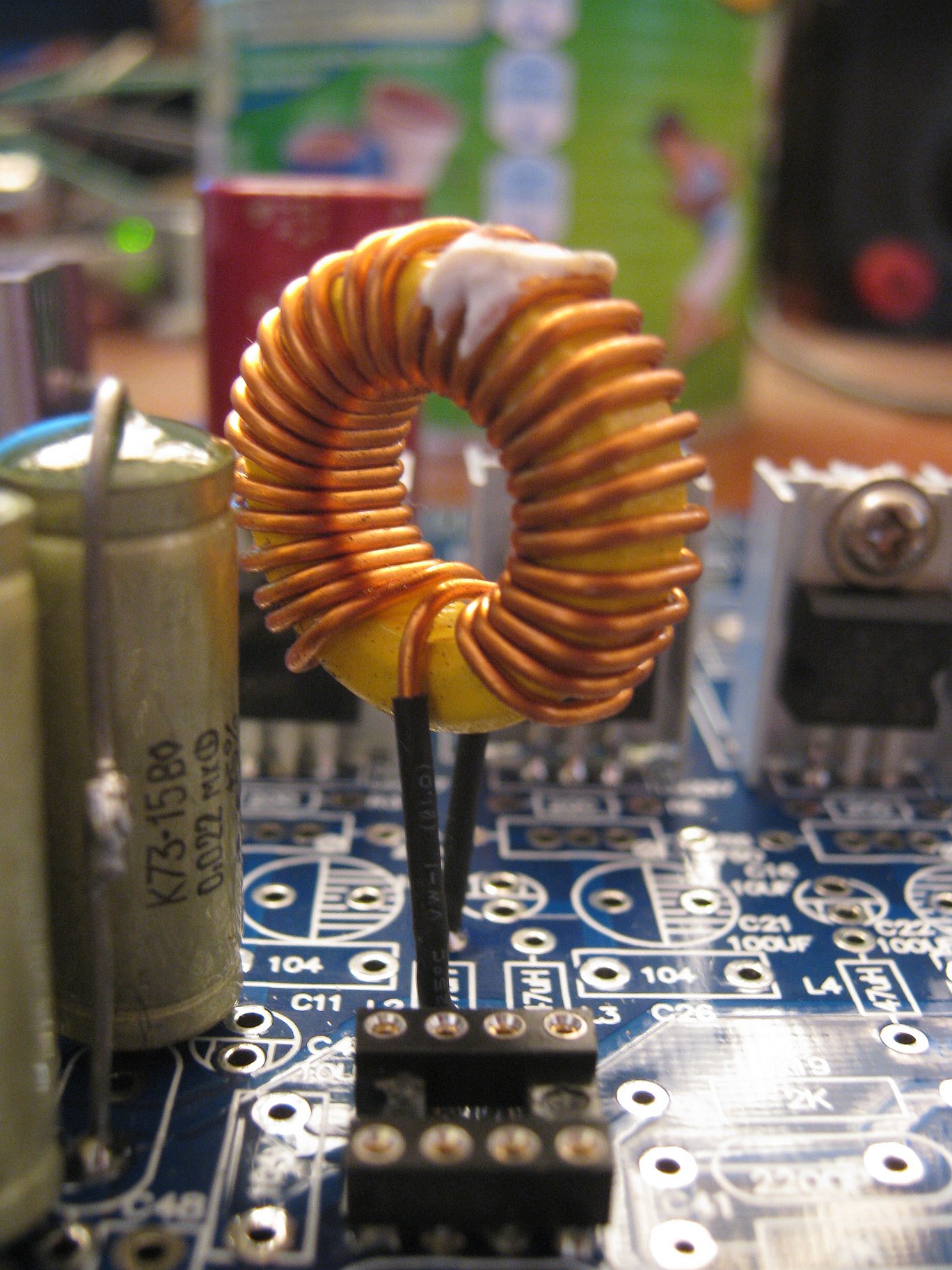

Put a massive high current Differential Choke on L2 (Q6 -15v Bus for TDA1541)
Ohms reading on each solder tab is 000.4 Ohms, I don't know anything else aside from the fact that it came from an ATX PSU.
Using this calculator:
Toroid Winding Calculator ? 66pacific.com
I've figured out that its 27 turns and is approx 2.6uH using a Yellow T-30 Size Iron powder core.
I do have another ferrite core which is much thicker but about the same diameter, may need to get some new copper wire online and wind my own high inductance core.Turns required: 27
INDUCTANCE
Desired: 2.6 uH
Calculated: 2.6 uH (101% of desired)
CORE
Part number:
Freq. Range: 3 to 50 MHz
u: T-30-6 (Yellow)
AL: 8
36 uH/100 turns
