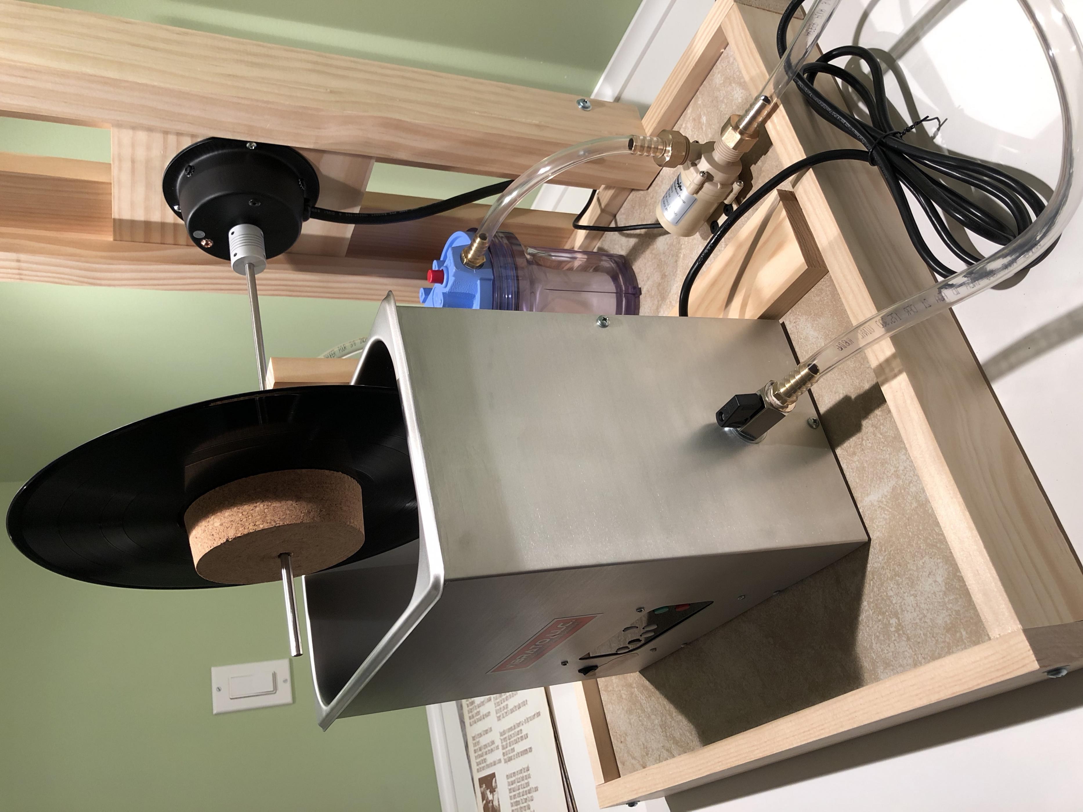

Dear all,
I've discovered some strange, dark spots on the bottom of the bowl, where the transducers are installed (on the other side). My machine is still in experimental phase (a year ago or more...) but has already several hours of operation. Some time ago I noticed only one slight spot (the one which is now the strongest one) and by accumulating more and more operation hours, now I've got these spots on all the transducer's fixing points. If you touch them it feels like a very fine sanding paper (like 1000 or more). I suppose it is a kind of erosion.
Anybody else experienced something like this?
njjano:
The spots are where metal studs are welded to the tank and the transducers are then screwed onto the studs with epoxy.
This does look like the beginnings of "cavitation erosion", which will eventually lead to holes in the tank.
For these more powerful 40khz frequency ultrasonic cleaners, a thicker gauge tank should really be used, such as 22ga or 18ga, instead of 24ga.
You may be able to lessen the appearance of the dark spots by cleaning the inside of the tank with stainless-steel cleaner. You may even try "Soft Scrub", provided you clean out all the residue and use the stainless-steel cleaner afterwards.

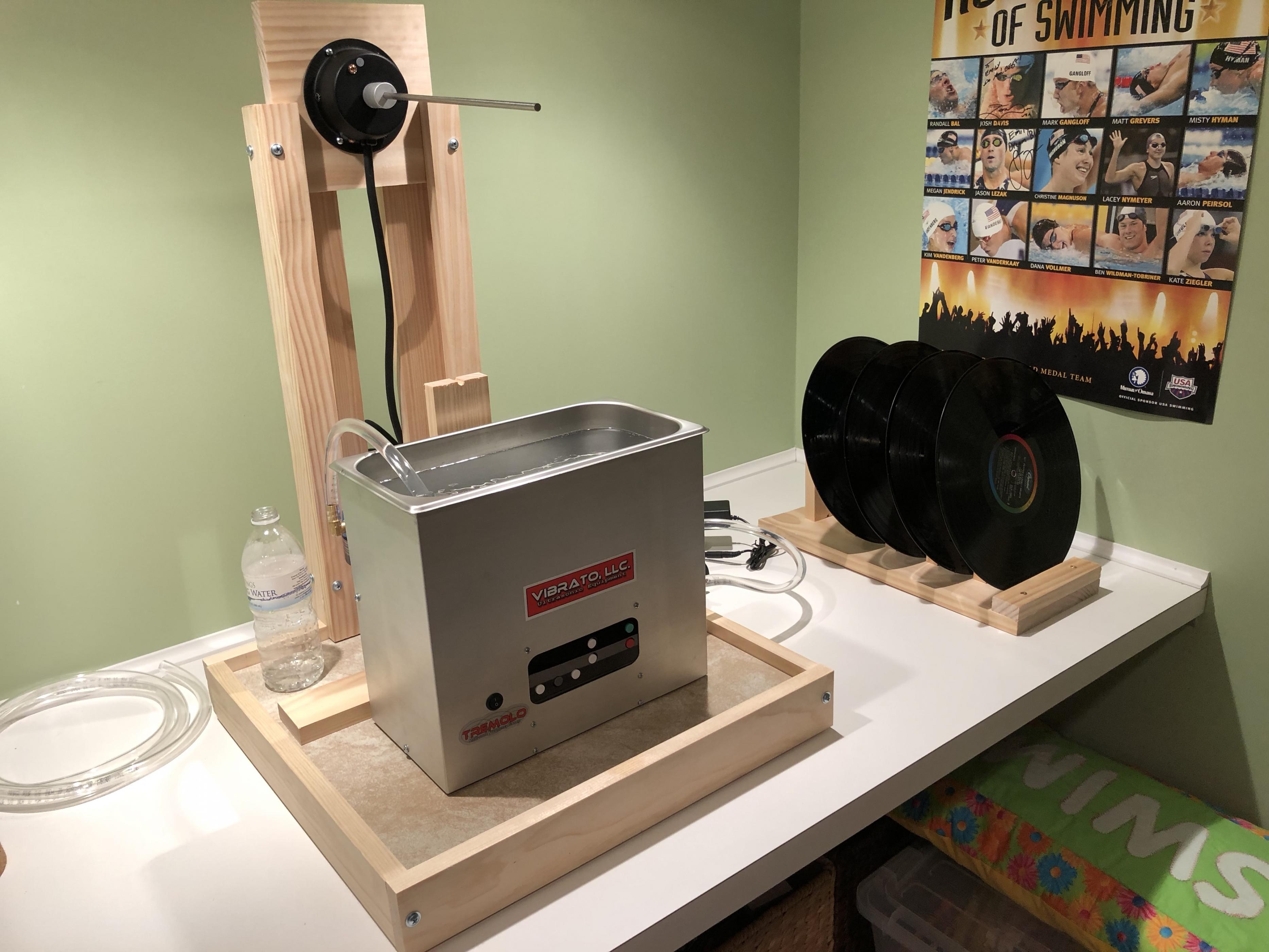

I've read through quite a bit of this thread, but there's so many conflicting views, options, etc, I was hoping someone would be kind enough to quickly summarize and clarify a few points for me.
My plan is to keep things as simple as possible while still achieving the features that I want.
I just want a small tank that can clean one record at a time, and I plan on using either Tergitol 15-S-7 or the blend of Tergitol 15-S-3/15-S-9, whichever is less expensive for me. I will use deionized water.
Is 40, 60, or 80 kHz better for cleaning? In terms of the cavitation size, it seems any will work, but I see some people insisting higher is better. I noted that the higher the frequency is, the more uniform the cavitations become, instead of happening in random spots in the bath.
Some really push using the heater to increase solubility of contaminants. Is this necessary when using real Tergitol?
For cleaning the one record at a time, which tank/brand would be best? I don't want to spend a lot on the tank, a little cheapie would be best.
I see some people mentioning "tide lines" and other left over debris. How do I avoid this?
Are there any tanks that are very narrow so that I can use a smaller amount of solution and not have to bother with filtering it? Or would this introduce too much variable heat and warp the record?
If so, what is an inexpensive 1 micron filter and pump that could be used? Also, if this is truly removing built up contaminants beyond just dust, etc, then the filter isn't going to remove things like oil - will this be redeposited, or will the Tergitol keep it viable for 20 or so washings?
Finally, how many rpm's/rph should the motor be doing? And then, for how long should it be left to run?
Sorry, if these have been answered before. I'd just like to see what the general consensus is since I've seen so many answers. Thanks to anyone who takes the time to help.

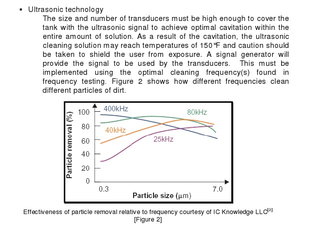

Alliexandras,
I'll offer my thoughts on several of your questions.
• Higher frequencies clean better for the particle sizes likely to be of interest in record grooves on LPs. This is supported by research. See the attached graph, which shows 80khz is much more effective at removing particles in the micron range. At 2 micron, an 80khz machine will remove about 90% of the particles, while 25khz or 40khz machines at best will remove 60 to 70% of the same particles.
• Empirical and research results across hundreds of users cleaning different items suggest heat helps cleaning regardless of solution formulation used.
• Good research also shows distribution of cavitation bubbles is improved as temperature rises, and most importantly, that at higher temps, there is less erosion of parts you're trying to clean!
• "A little cheapie" will not give you good results IMO. At best, it will be compromised in particle removal ability since it will be a 25khz or 40khz machine, or a 25khz machine masquerading as a 40khz machine (see the first bullet). There have also been examples mentioned on the board of damage caused by cheapie machines. Not worth the risk in my opinion. But there will be people who disagree, as you have seen, since they might have rolled the dice and procured a machine that seems to work for them.
• There are narrow machines for rifle barrels and such, but they aren't any cheaper than the usual 6 qt machines. And therefore, why bother cleaning only 1 record at a time, when you can clean several and save time, and cleaning solution, in the long run?
• Do not plan on cleaning 1 record at a time, and just leaving your cleaning solution sitting around for your next listening session. It will get gross in a day or two. Deionized water gets ionized pretty quickly too by the way. Cleaning in batches is more efficient and saves time and money.
• Filtering is optional. It makes sense if you have a lot of LPs to clean. It then saves money.
• I am the original proponent of single revolution cleaning. Given a desired cleaning time of 3 to 4 minutes in the ultrasonic bath, which the literature indicates should be adequate for relatively clean items like LPs, that implies a 5 or 6 rph motor (assuming about ⅓ of the LP is submerged at any instant). A 1 rpm motor will only keep a point of the surface in the bath for about 20 seconds. This isn't long enough to remove most contaminants. That spot will then dry in the open air for 40 seconds. Another 20 seconds in the bath really isn't additive to the first 20 seconds in the bath. It's just another time period that's too short to remove many contaminants and they'll just remain on the record for the next spin too. Others are satisfied with the results they get at 1 rpm, so to each his own.

I agree with BB. I would like to add my experiences with the various frequencies with ultrasonic machines. I have several both 60 & 80 KHZ. I find the 80 not to be that great on really dirty records. While the cavitation are smaller in size the implosions are not as powerful to knock the grit off as a 60. However I might add that a very nasty record is going to require some physical intervention with a standard cleaner like a Knitty Gritty, VPI, Spin Clean, hand or such before running in a US cleaner. A record that has been treated well and looks clean would be fine in an 80 and slighty less loved record will do well in a 60 any thing else more likely need a multi pronged approach to cleaning. I use a distilled water and 99% isopropyl alcohol with 2 oz per quart. Vibrato LLC has some excellent cleaners or you may be able to find an early version Sonix IV on Ebay. The current Sonix ones are OEMed ones from China and are 40KHZ.
Thanks for the responses! I actually managed to find a Tuttnauer CSU3 (60Khz) fairly cheap, from a surplus, and I'll just buy a silicone rubber adhesive heater for it.
