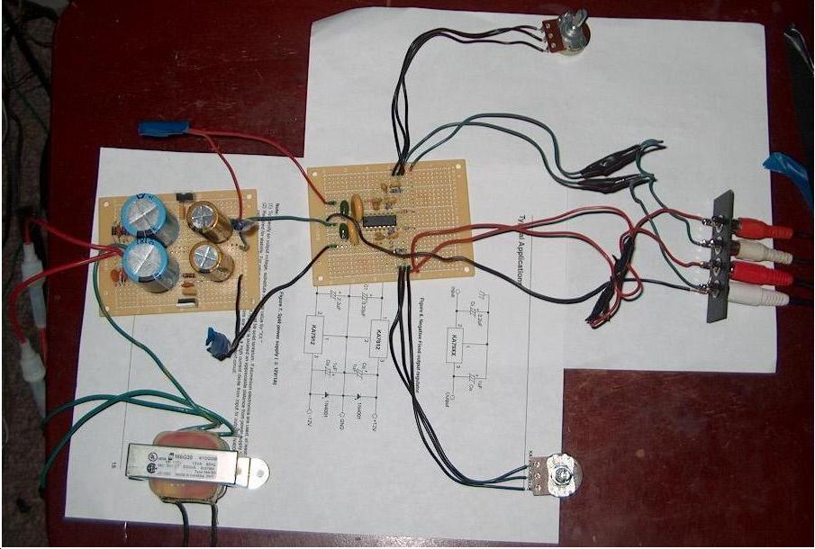

My version of a Slone preamp
from "The Audiophile's Project Sourcebook" page 65 fig 3.1. I omitted all the RIAA circuitry (already have a RIAA board) and just built the preamp section twice for stereo. the board on the right is the preamp and the board on the left is the psu (just in case someone doesn't know by looking).
for the preamp i used 2/4 of a TLO74 opamp chip, and just grounded the input pins of the two unused ones. all caps in the signal path are tantalum and all resistors in the signal path are metal film. level adjustment is done via the two 20K pots at the top and bottom of the picture (one adjusts left channel the other adjusts the right)
my assessment:
since the only measuring instruments i currently have at my disposal are a VOM and my ears, i apologize for not being able to give a more objective analysis and measurements. my opinion is it sounds very nice and worth building. highs are crisp and accurate, mids are clean and lows are powerful and smooth. no perceivable hum or noise or buzzing issues, so im assuming PSRR is very good. a very wide range of level adjustment is possible with this circuit, from off to making a receiver thats set on 1 sound like its on like 6 or 7 in volume.
this is part of a larger project that will also include source selection, tone controls, level indicators and a RIAA board all in one box.
all comments, suggestions, questions and observations welcome.

TBH from looking at the PCB and summarizing (havent seen the book) there isn't much going on here. An opamp based preamp is a pretty simplistic thing.
There are easy improvements to make - the first would not be using tantalum capacitors. Polyester are much better here for coupling purposes. If they are small value capacitors used for bandwidth limiting, polypropylene work very well. Stick with ceramics for decoupling.

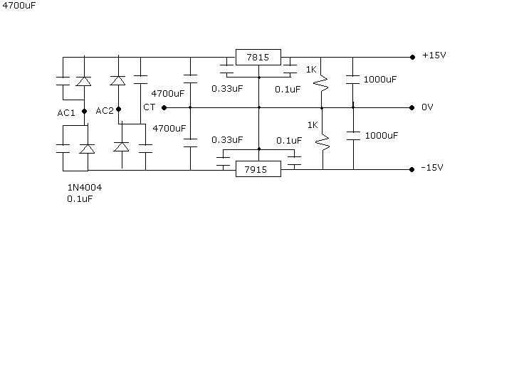

The PSU is easily improved - instead of using the 7815/7915 pair, use LM317/337 with the adjust pin bypassed by a 10uF capacitor.
The TL074 opamp can be easily replaced especially if you are only using two opamps - NE5532 works well, or OPA2134 if you prefer a FET based opamp.

Hi jaycee, thanks for your reply!
yes i know. this was really my first diy audio project building from scratch so i went for something simple. also i needed something like this because the signal from my ipod does a poor job at driving the input to one of my vintage receivers, hence the need for the opamp to boost the signal.
actually that was a typo. i used the tantalums for opamp decoupling, and in one place in the signal path where the schematic specifically called for it. all the rest are garden variety ceramics i had on hand, so yeah i realize theres much room for improvement here. if i decide to build a six channel version of this for my home theater, then i will definitely take your advice and invest in some boutique caps. but as it is and for what i'm using it for, it sounds just fine to me the way it is.

i have noticed something interesting this circuit does.
ground both inputs. turn both level controls to any setting you want, turn volume on receiver/power amp up to max. then, there is a very very slight mains hum in the woofer. i mean its so slight i have to actually stick the side of my head into the woofer cone to allow my ear to detect it. but sure enough, its hum. heard hum enough times to recognize it the instant i hear it. unfortunately.
whats confusing me is this. after disconnecting my circuit from the mains, the hum continues unchanged until the filter caps in the PSU discharge through the bleeder resisters enough to turn off the opamp ... which in my case is about four seconds. then the hum goes away completely.
so in other words the hum isn't coming from the trafo, because it continues when the primary is unplugged from the mains. it can't be being injected in the power amp or the rca cable from the power amp to my circuit, because the hum stops when the circuit is shut down.
so whats happening? regulator noise? hum pickup by the grounding system or some component on the circuit board? i mean this problem is barely noticible and is undetectable (to me) other than in the condition i described above, so its not like im in a hurry to fix it or anything.
just curious as to whats making it behave like that.
just switched to all sheilded cable for external signal lines.
situation unchanged. perhaps use shielded cable for the lines to the pots too? just figured i'd see some sort of improvement if i was on the right track.

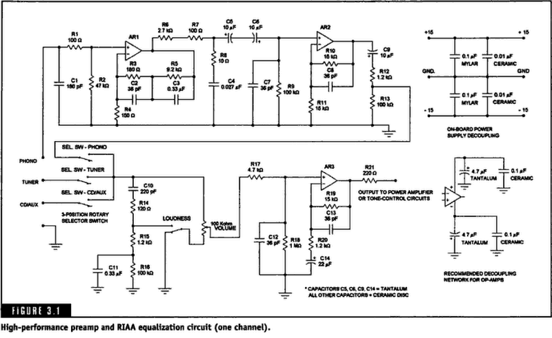

I attach schematic, so people can follow this project better.

i thought the 317 was an adjustable regulator? i was going for a +/- 15V split supply hence my reason for using the 78/79 series so could you explain why 317/337 is better here?
LM317/337 has a lower noise output than the 78/79 series, especially when the adjust pin is bypassed with a capacitor. They aren't much more expensive, and there is only minimal extra work in using them, so it is worth it.

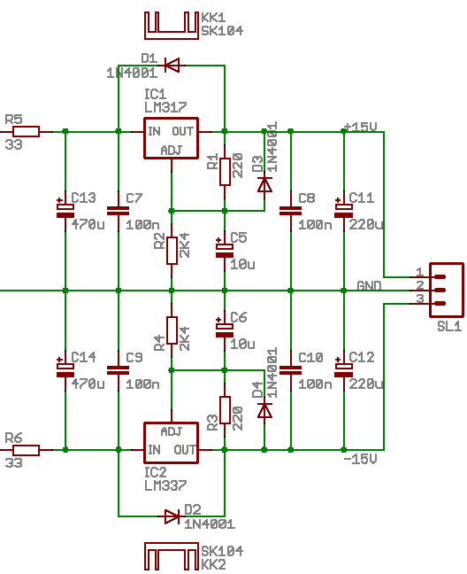

also very good to know about the better noise performance of the 317/337 series regulators. whats the normal way to set these up? wire them up like a normal adjustable regulator, then 'adjust' them to 15V (or whatever you need) then measure the resistance you have the pot set to and replace the adjustment pot with a fixed R? will research PSU's that use 317/337 for fixed supplies for design ideas, thanks.

just to clarify, i did not implement the RIAA section of schematic lineup posted. iow, i implemented the bottom part of the schematic only, not the top, so my comments apply to that section (preamp section)
You can calculate it. Look at the LM317 data sheet to see how. It doesn't have to be precise, eg 14.8v or so will do, and the negative supply doesnt have to match exactly either. "close enough" is good enough 🙂
I used 220R between out and adjust, and 2K4 between adjust and ground, with a 10uF capacitor in parallel between adjust and ground.
Here's how mine works. Before the 33 ohm resistors on the left is connected to the power supply for my LM3886 based power amp (+25 and -25v supplies with 2x4700uF capacitance per rail). You would replace this as appropriate. I'd probably stick 1000uF per rail before the resistors, and decrease the resistors to say 4.7 ohm 1W devices.
