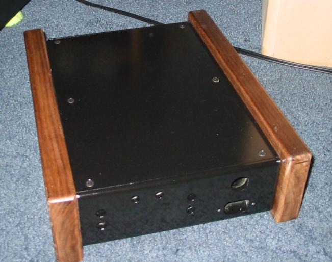

this looks like a great place ...
... to post my new case!!
i didn't wanna waste a thread on this, so this looks like a great place to sneak in a pic of mine. sorry the picture isn't that great. hard to get much better with the black.

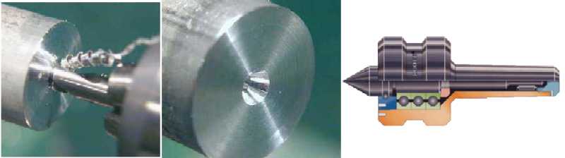

Centering drill or Center drill is a common name here in the US. The tool, while convenient for creating a pilot hole for larger drills, or even small drills to keep them from walking around, takes its dimensions from its use in the tailstock of lathes. One would put a piece of bar in the jaws (or other work holding piece) of the headstock of a lathe and the center drill in the tailstock. Fire the machine up and use the tailstock to push the stationary center drill into the rotating bar, creating a small hole with a specific chamfer at the center of the bar. Remove the center drill and replace it with a live or dead center in the tailstock to steady the work from that end. It is practically mandatory for many lathe operations.
Attached is a pic showing the center drilling operation (bar rotating, drill stationary in tailstock), the resulting hole/chamfer and a diagram of a live center, which will fit in the chamfer left by the centering drill. Now that you see the application, think of how many items you have seen with that little chamfered hole at the center. . .
Sandy.
Very clear explanation! Thanks!
I tried to put my aluminium plates in a lathe, to make this little chamfer, I don't know why but it didn't work 😀
I used the centering drill with the press drill instead

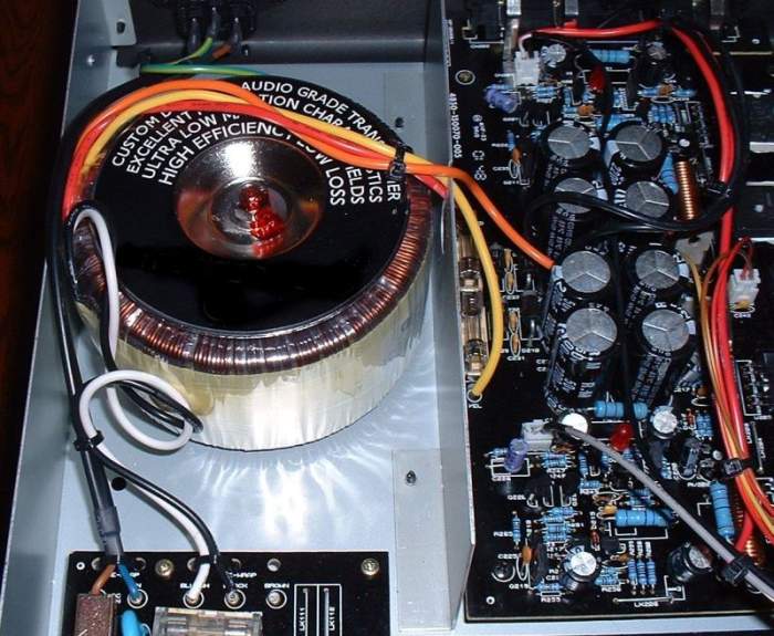

It's not the magnetic field I would worry about with a toroidal transformer. They are inherently very low magnetic field devices because of their very construction. This is not true for other types of transformers.
It's the electric fields that could cause an issue, and this is true with any transformer. You've got to get the wires in and out somehow.
I've heard of more than one commercial mfg that allows for the transformer to be rotated before it is bolted down to make sure they have the minimum noise possible.
I've attached a pic of a well regarded, well measuring, $300 integrated amp. I've airbrushed out the name of the company, which was on the transformer. There is a metal sheet that runs most of the way down the side between the transformer and the signal circuitry. This piece does not provide any kind of mechanical support, the way it's mounted isn't strong enough to do that. It's not a complete Faraday cage around the transformer but they must have done tests and this fixed some sort of problem. Notice that the transformer leads come out on the far side of the signal circuitry. This isn't on accident either I bet.
On the transformer is printed:
Custom Designed Audio Grade Transformer
Excellent Distortion Characteristics
Ultra Low Magnetic Fields
High Efficiency Low Loss
I hope this helps...
Scott

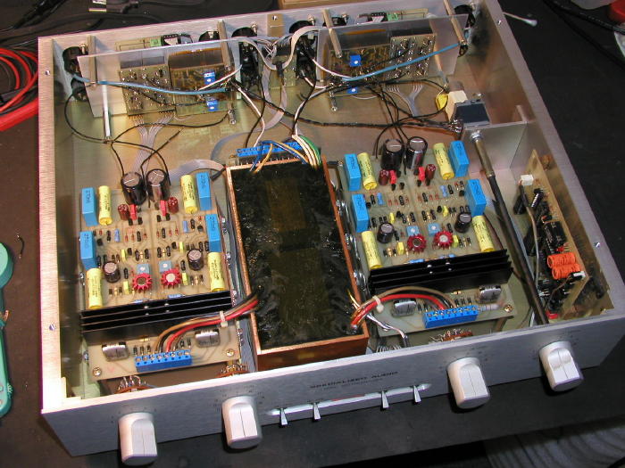

Peter Daniel said:
This is what I did in my preamp to isolate transformers. I've built a cage out of 1/8" copper plates and filled the space with epoxy. The AC connection is also done here on the bottom panel, right beside the transformer's housing.

Some questions about the last 2 pictures:
ScottRHinson: what's at the right of the transformer, in this amp?
Does someone have an idea why the shielding plates don't go completely from one side to the other?
Peter Daniel: how did you fix the metal spacers that are between the PCBs and the chassis plates? Are they screwed? How did you do that? (I can't see how you can drill a hole and taper in in a such thin plate)
