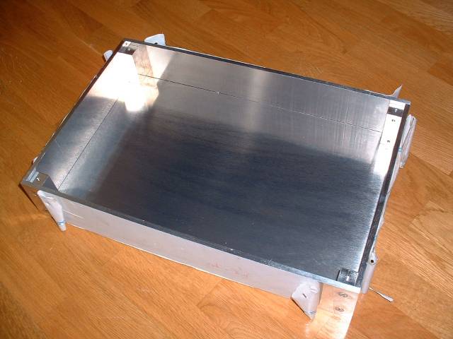

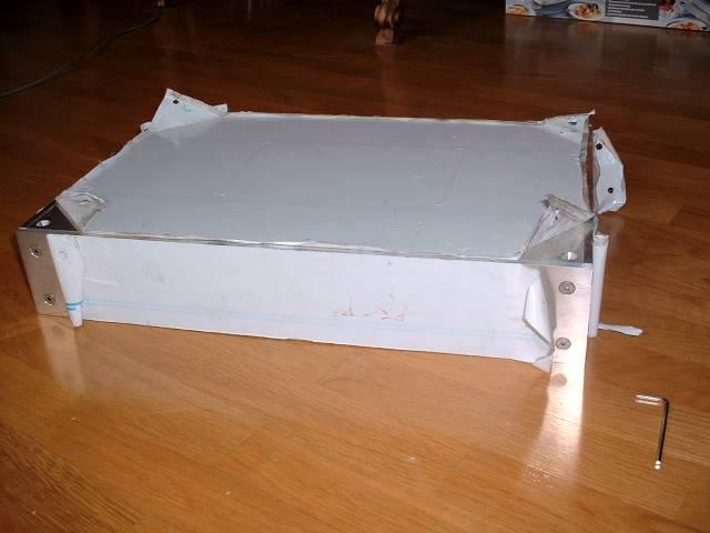

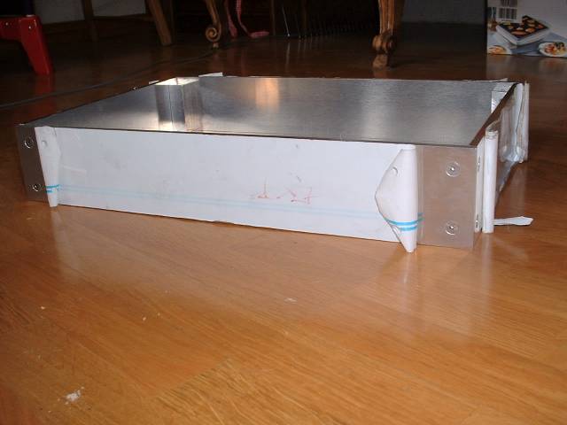

I'll let the plastic sheets over the plates until the chassis is completely finished. This will avoid scraches when I'll work on it.
Any comments?
Any comments?
Bricolo said:Any comments?
she is a beauty.

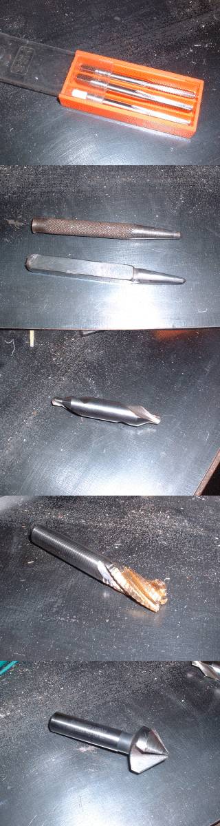

where did you get the aluminum plates and how did you work on them?
I bought the plates from a company that works with aluminium, near strasbourg
I drilled the holes with a (don't know if it's the correct word in english) stand-driller (a big driller on a stand). Holes are 5mm, with a chamfering for the screws
the "inner holes" were drilled with 4.2mm and then I made a M5 tapping
now I'm wondering how I'm going to place all my gainclone's components in it
should I place the toroid in the center, ant then each channel at one side?
or place the toroid in an edge or a side?

Keep up the great work and pictures. The name for the drill you were using is called a Pillar Drill.

Peter, any comments about my case? I know I'm still far from your artwork skills, but I'd like to know what you think about my first chassis.
The problem I've got with it (the only one for now):
the top (and bottom) plates are "inside" the others, not other and under. I did it because of aesthetics, this way when you look at the amp (in front of it) you only see the front plate, ant not the front plate with the left/right/top/bottom plates all around of it.
but I have difficulties to put the top plate off, it's strongly hol in place by the other plates when they are screwed

Very nicely done and there is not much to improve here. If the top panel is too tight, you might try to trim it a bit, with belt sander (if available).
This chassis style is very similar to what PassLabs use, the only exception is that top panel is placed over the rear panel and this helps to open the cover (and provides some extra rigidity)

Teach me some english, please 🙂 Online translators don't work for those technical words
what's the name for all those tools?

Peter Daniel said:Very nicely done and there is not much to improve here. If the top panel is too tight, you might try to trim it a bit, with belt sander (if available).
You're the man, Peter!
I didn't think about this solution. It's too late now, but I keep it in mind for the next time.
BTW, how is this pass chassis done for the bottom? The same as for the top? layong over the back plate?
Rarkov said:The name for the drill you were using is called a Pillar Drill.
Here, we would call it a drill press.

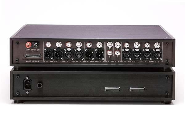

Peter Daniel said:Here's the rear view. That's a very clever and efficient way to built a chassis (if you don't mind using 1/4" panels, of course😉)
Thanks!
Mine is built the same on the rear as on the front, the pass one is far better
is there any advantage in having an offseted rear pannel?
