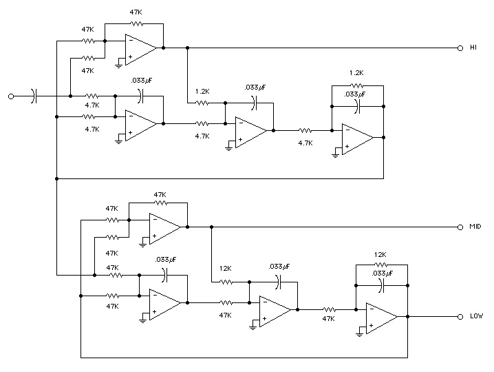

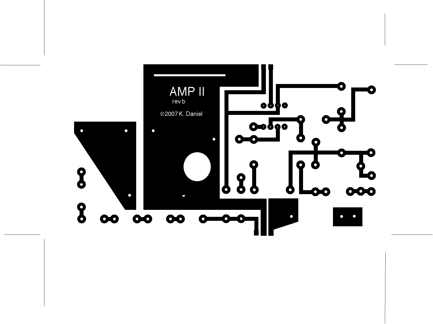

I had plans some years ago for a tri-amped class A super stereo, transmission line mid-ranges, ribbon tweeters, and a single sub-woofer. Prototyped it, pretty amazing. But I got sidetracked.
Pleased find attached what I found floating on my HD, consider it public domain, free for all.

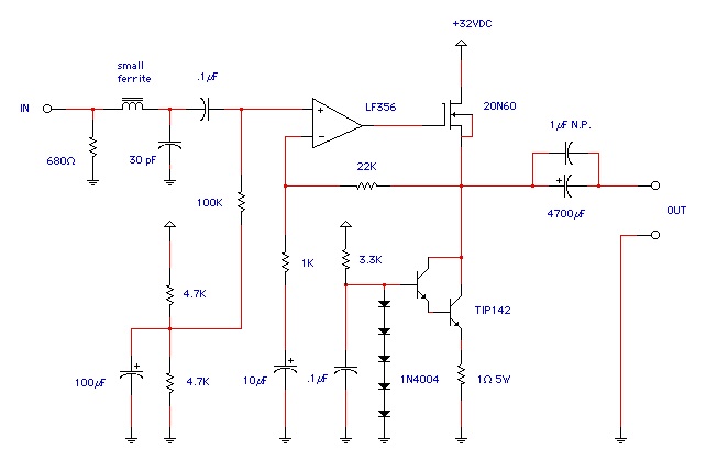

I'd be interested in any comments.
One note, the only rare part is the LF356 op-amp, do not substitute !
Not only is it extremely low noise, it was the only device I found that could handle the horrible MosFet gate capacitance due to it's unique output stage.
