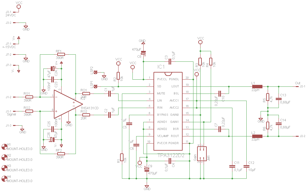

Hello guys, 🙂
I want to have some TPA3122 pcb's professionally made.
The TPA3122 is in BTL configuration and used in combination with a THS4131 fully differential opamp in order to perform single ended to balanced conversion.
Because I'm quite new to electronics I'd like to have experienced people to take a look at my schematic and future board layout, before I spend money on boards that won't work in a desirable fashion. 😉
Also: should I connect the power ground of the 24V for the amp with the power ground of the +-15V for the opamp?
The schmematic is attached. Thanks in advance for your advice. 😀

Möter said:The TPA3122 is in BTL configuration and used in combination with a THS4131 fully differential opamp in order to perform single ended to balanced conversion.

I just started a layout for this exact same thing! Mine is going to be slightly different; if it even works at all. If it does work, then I will have the board powered with a single rail for both IC's AND it will be DC coupled.
EDIT: BTW, why not use the TPA3106D1 instead? This way you only need one IC.
The only reason I'm trying the THS4131 + TPA3122D2 is because I have quite a bit of them.

That sounds really good, I was already wondering how to get dual 15V rails from a 24V supply. 🙄
I'm not using the TPA3106D1, because I haven't yet SMD soldered in my life, so I don't want to start with something more difficult than 0805 and SOIC packages (which are probably hard enough).

Well, without getting into a debate about Tripath vs. TI; the only major difference is this IC can handle a higher voltage. It can also be used with balanced inputs if so desired.
Note that these are mono, so two are required.

What is the chip you are using as the phase inverter chip in your schematic ?

I made new TPA3122D2 BTL boards, this time including a DRV134 to do single to balanced conversion. The DRV134 is running from the same single supply as the amp.
I like to try and use parts I already have if at all possible, so I went a little crazy with 1uF 100V X7R. There are 20 of them per board.

Also my question would be, why not use ...20d2, since it performs the same if not better and more power from it?
luka said:why not use ...20d2, since it performs the same if not better and more power from it?
Well, the only reason I messed with the 22D2 at all was because I have >100pcs of them and they are easy to play with since they are PDIP.
For surface mount package like the 20D2 I think the 06D1 is a better choice; like the board I made earlier in this thread. It doesn't require an external IC for BTL operation.
The above boards can swing ~11.5Vrms into 4R @ 20hz right before the over-current protection kicks in. That's around ~33W, which isn't too bad.
