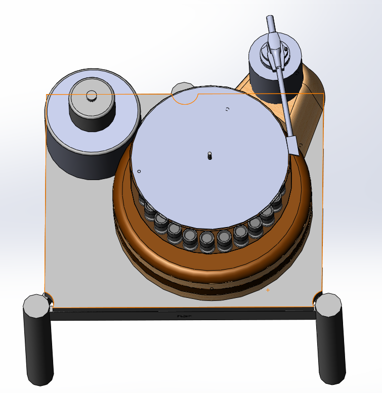

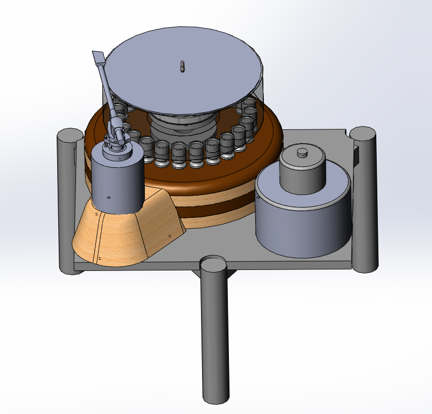

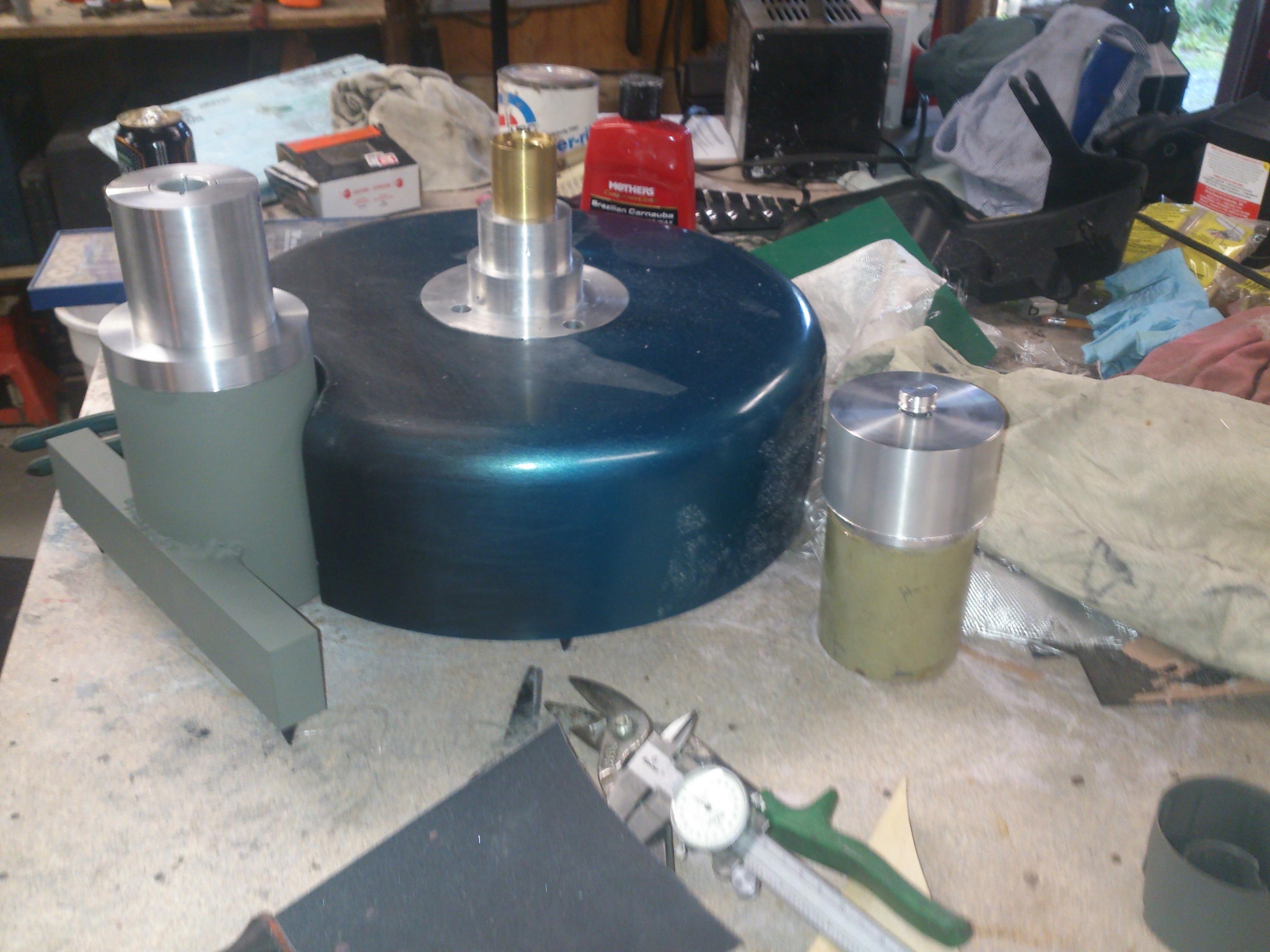

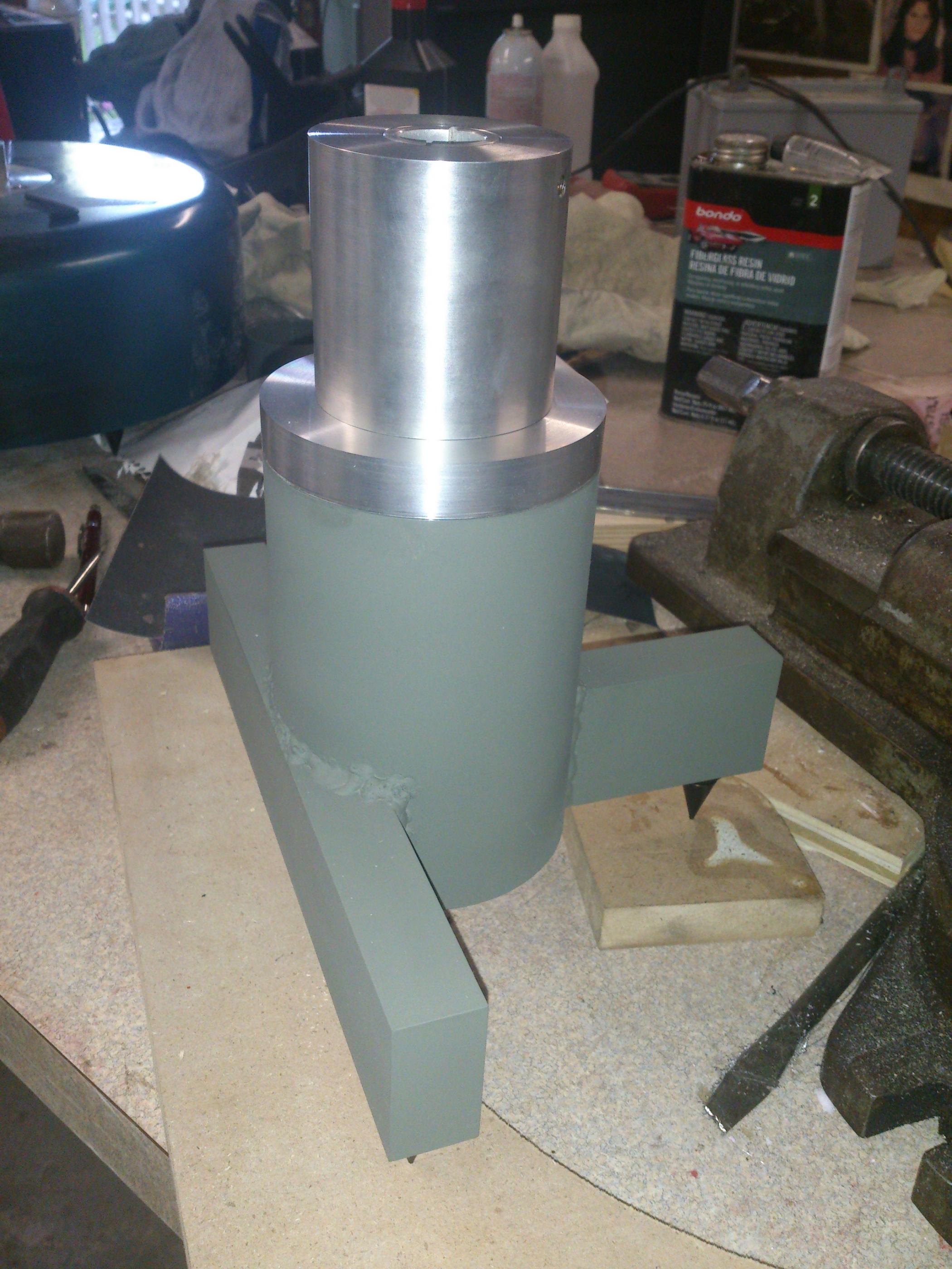

It isn't complete yet. I am stuck trying to figure out how to make an arm pod that is in proportion to the plinth and the needed 8" tall. I don't yet have an answer. I think it is going to be a 4" steel tube filled with sand and a fiberglass shell around it to get the needed bulk needed to make not look like a needle holding the arm up. The glass piece can also be filled with lead/sand to make the center of gravity of the whole thing more reasonable.

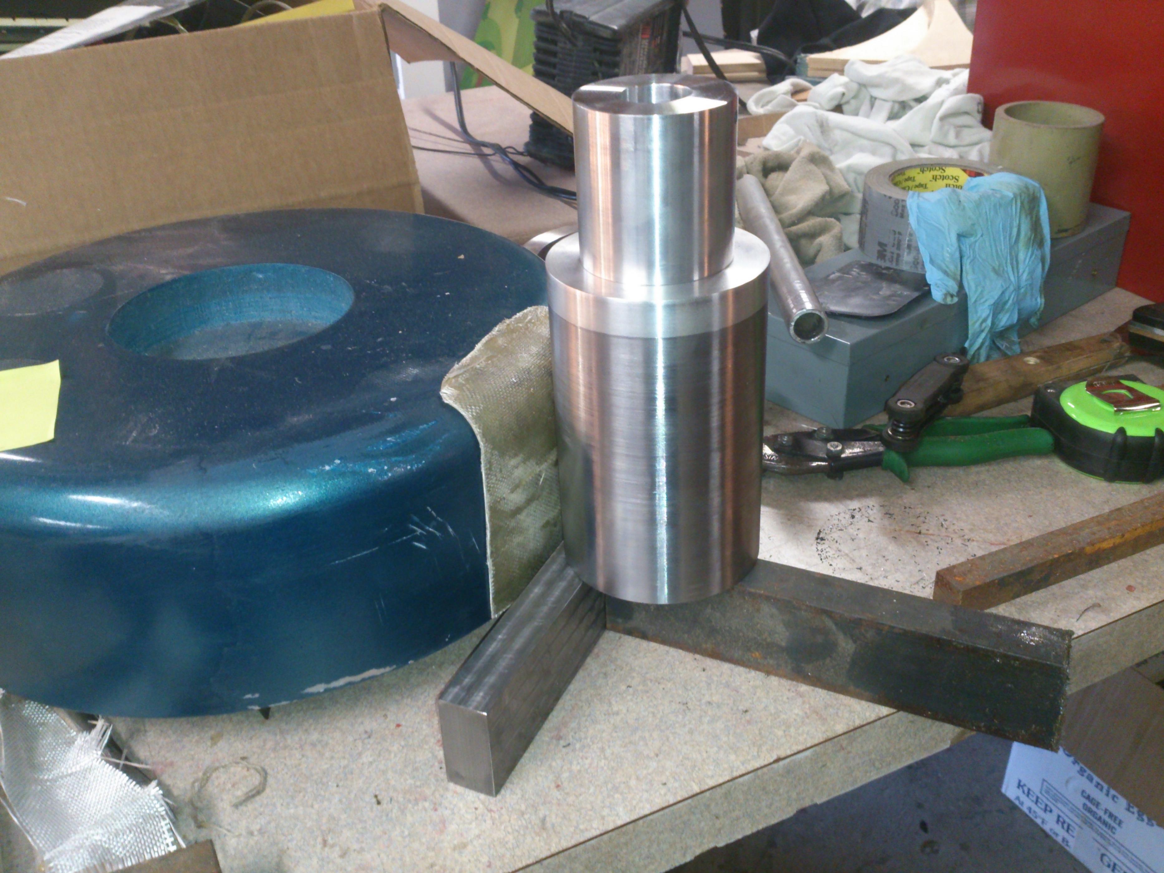

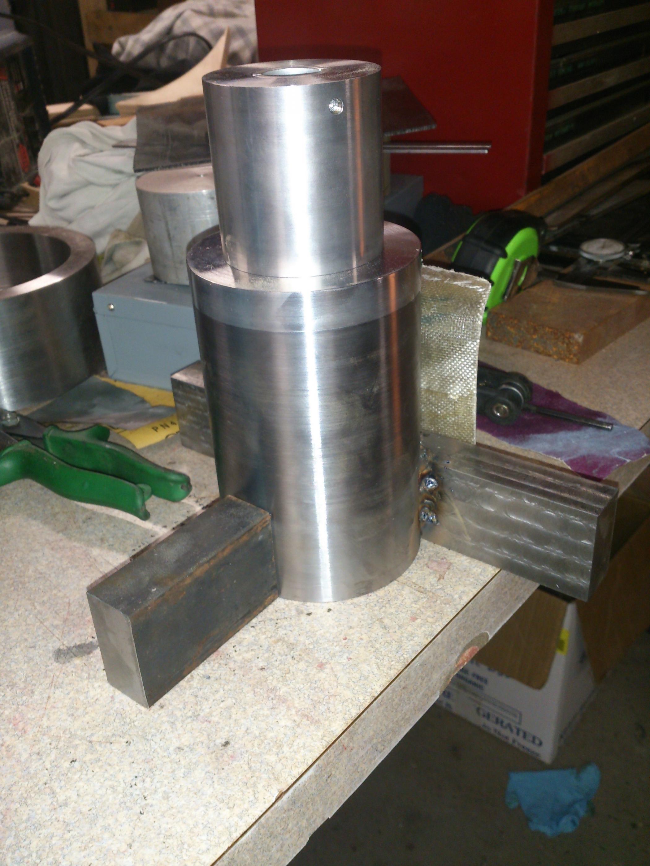

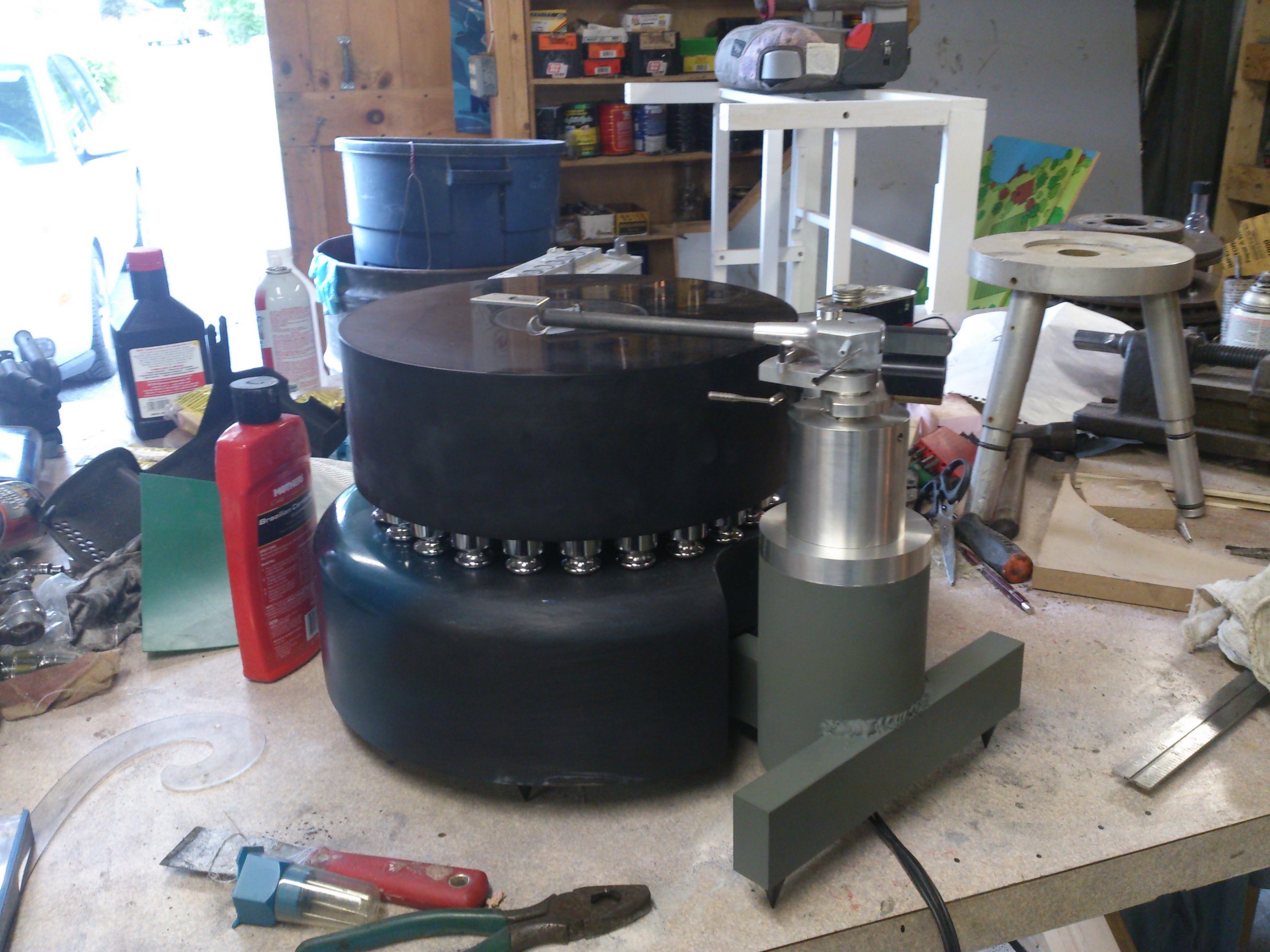

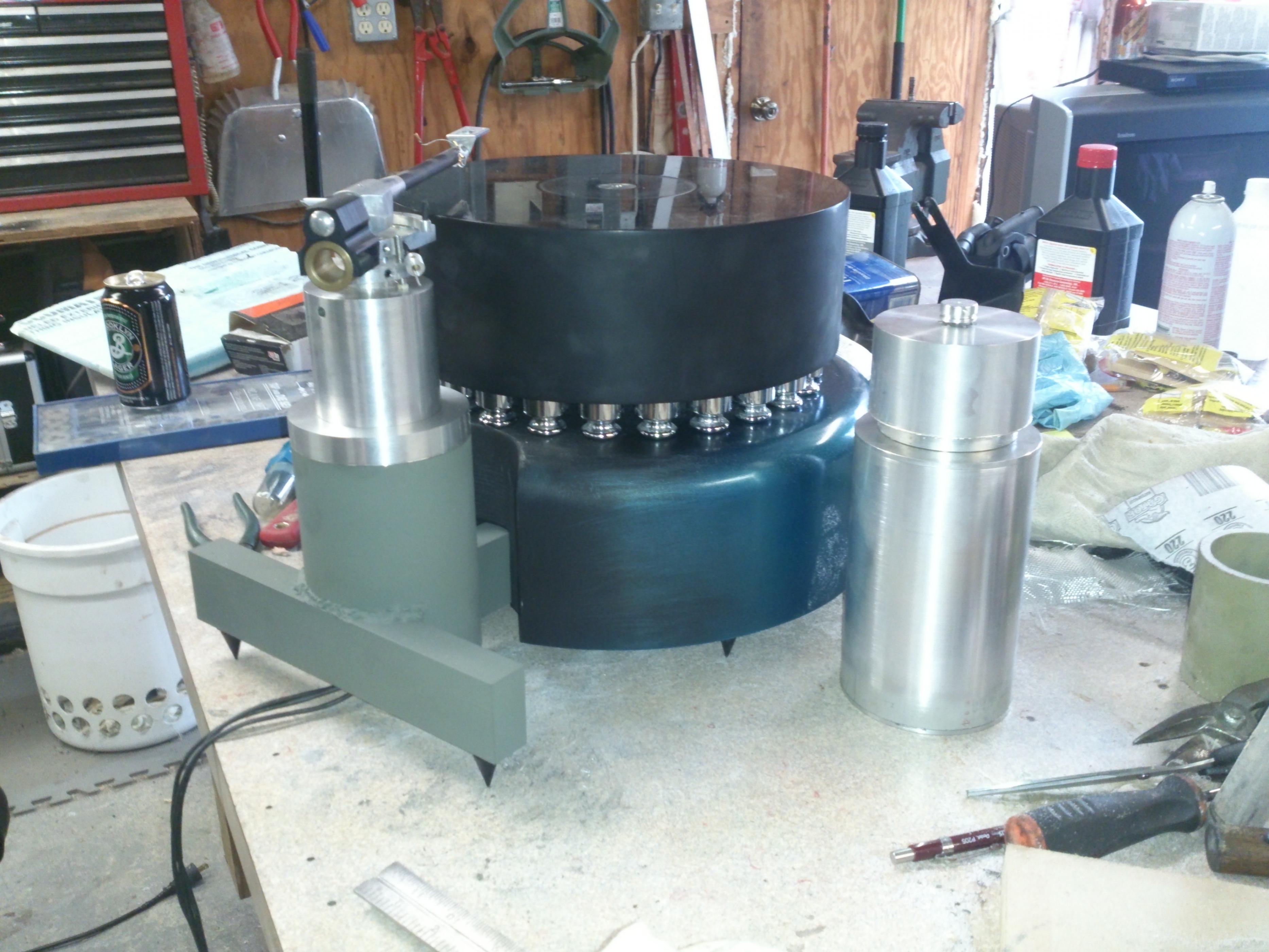

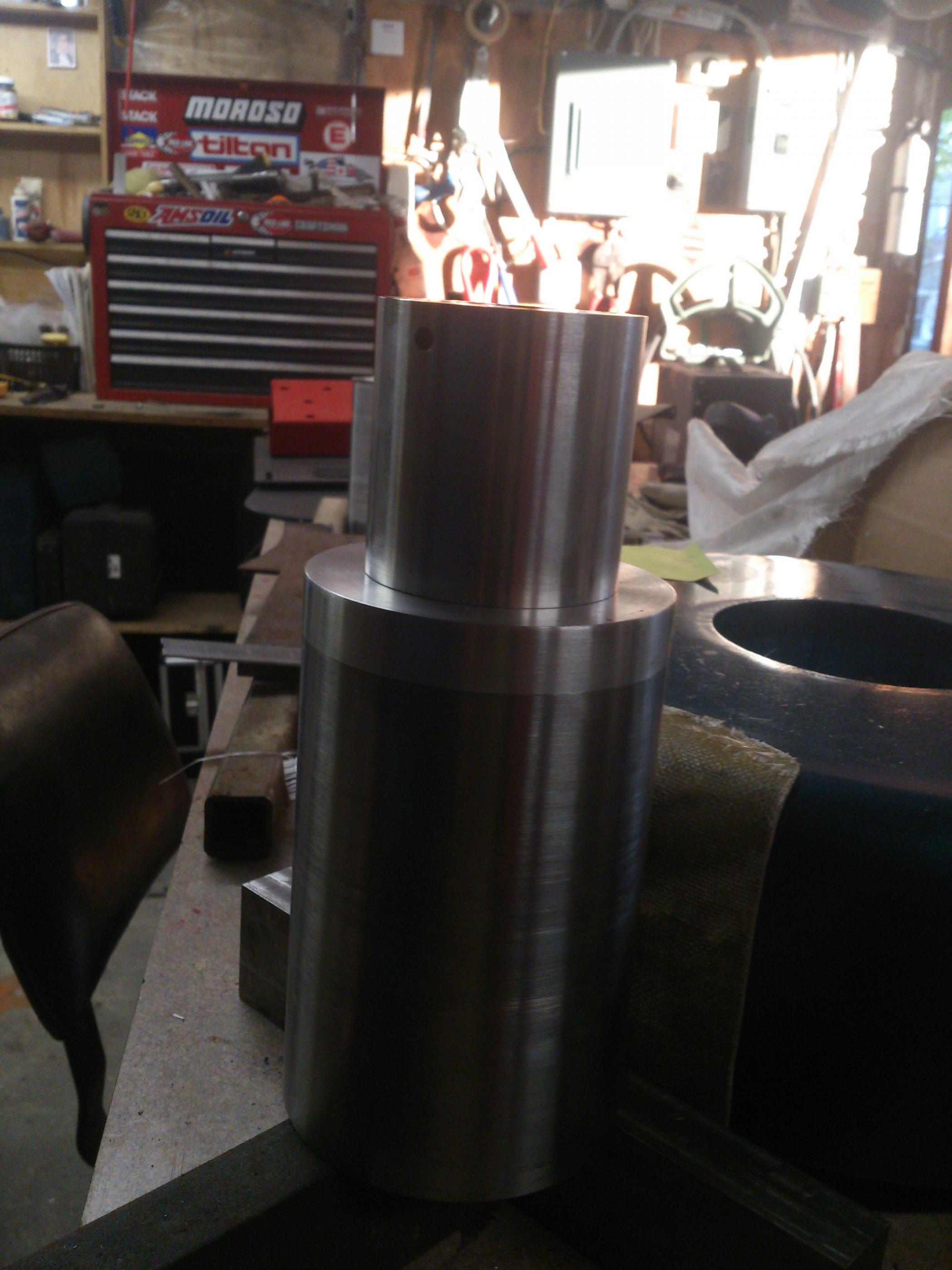

maxon motor in it's hunk of aluminum. mock up of the completed assembly in the garage. Still a bit of machining needed on the motor pod.

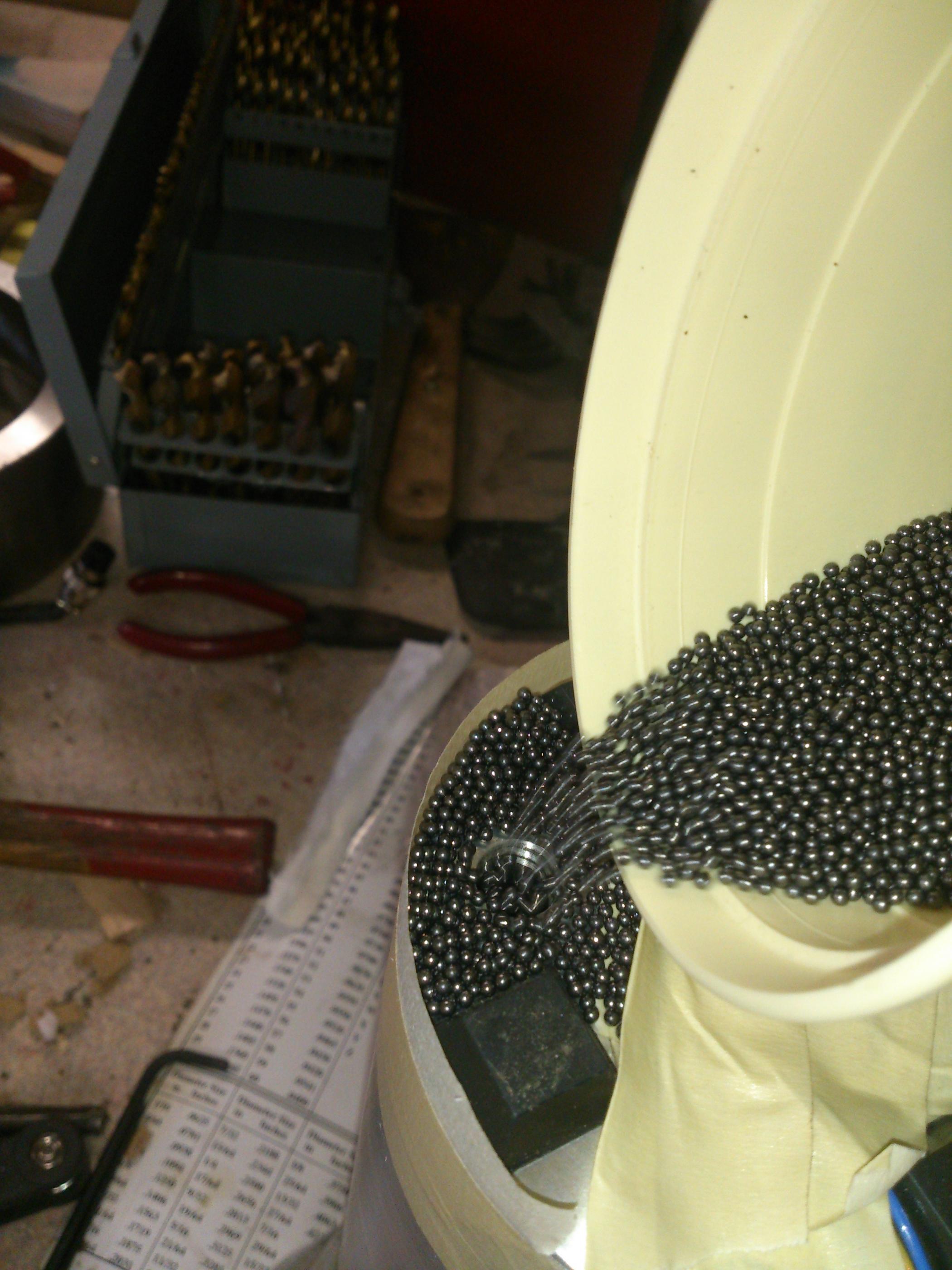

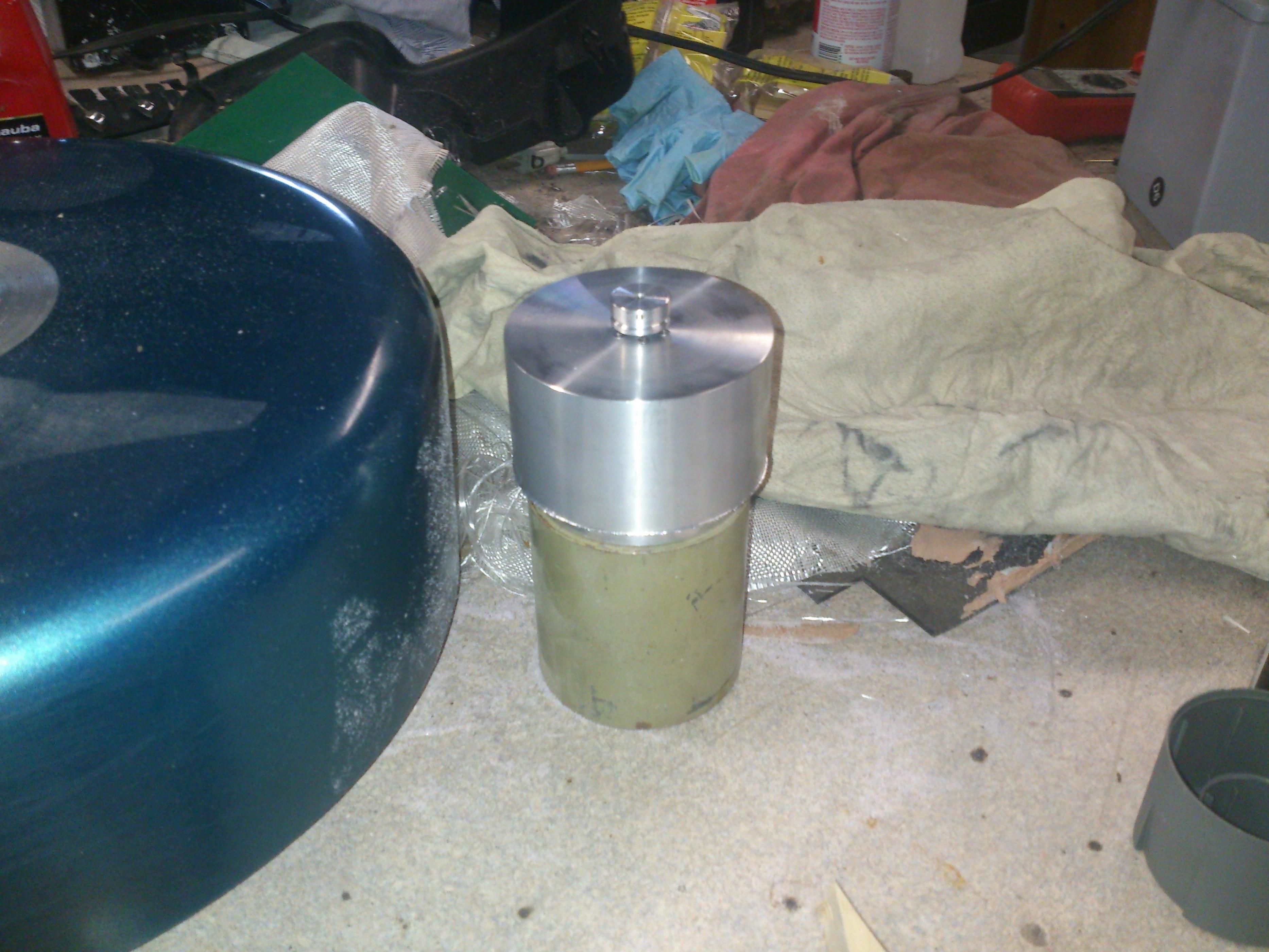

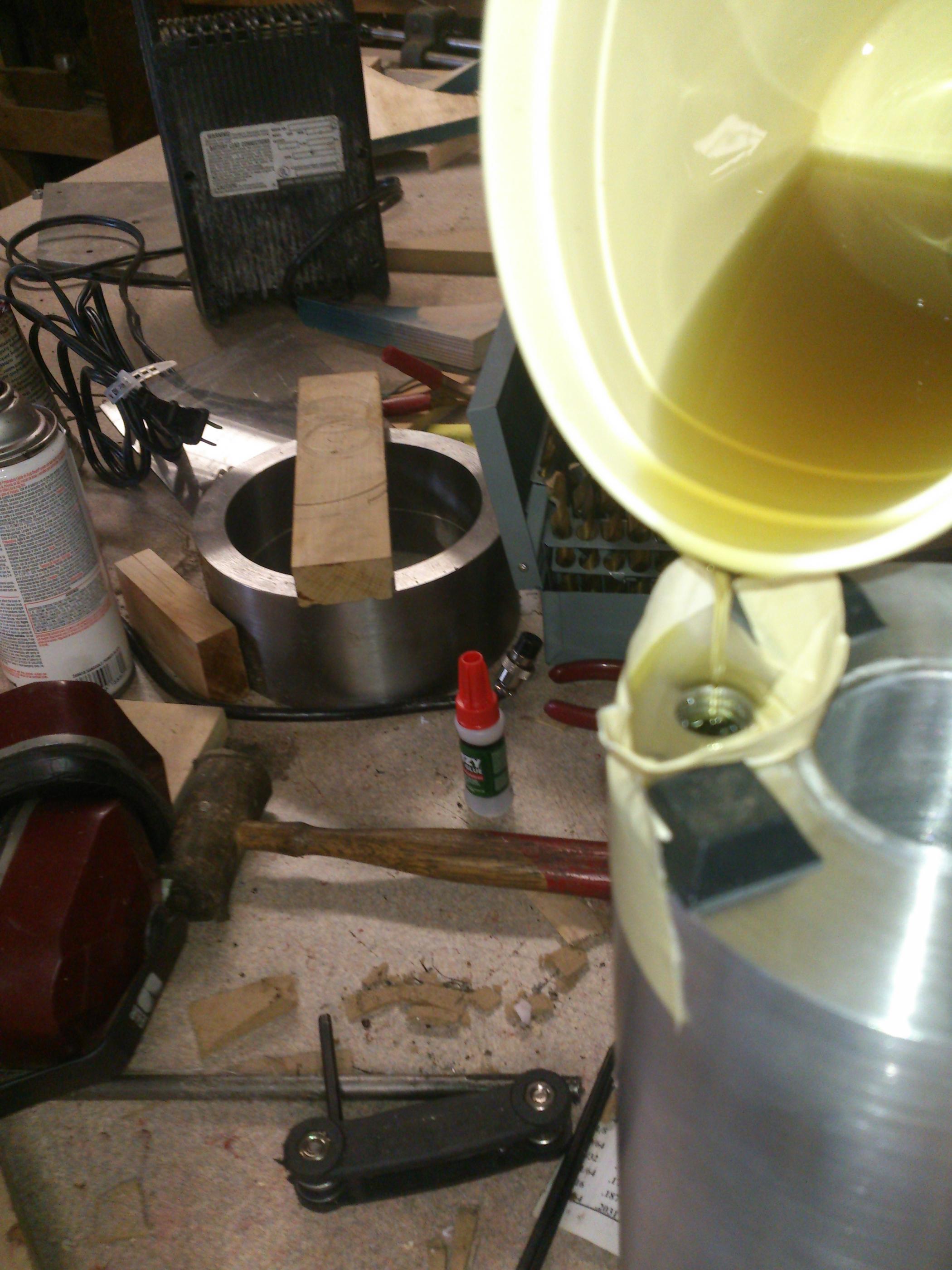

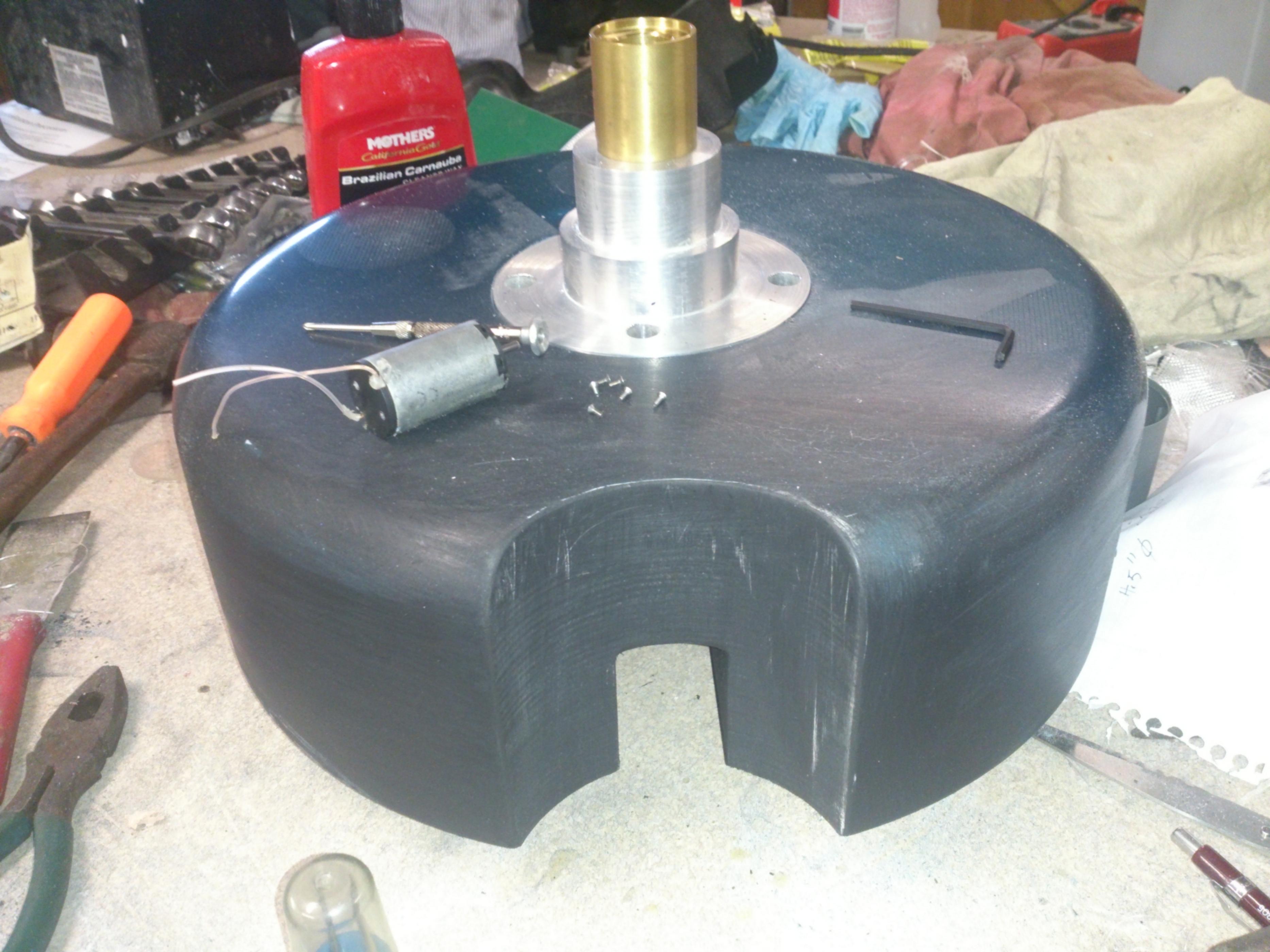

The first spin... using the motor stolen from my Musichall MMF. Speed was a bit off due to a slightly larger diameter platter. Motor pod getting a fill of lead shot and then some heavy weight oil to fill in the gaps.
I still need to get an updated pic of the finished motor pod with the Mark Kelly speed controller.

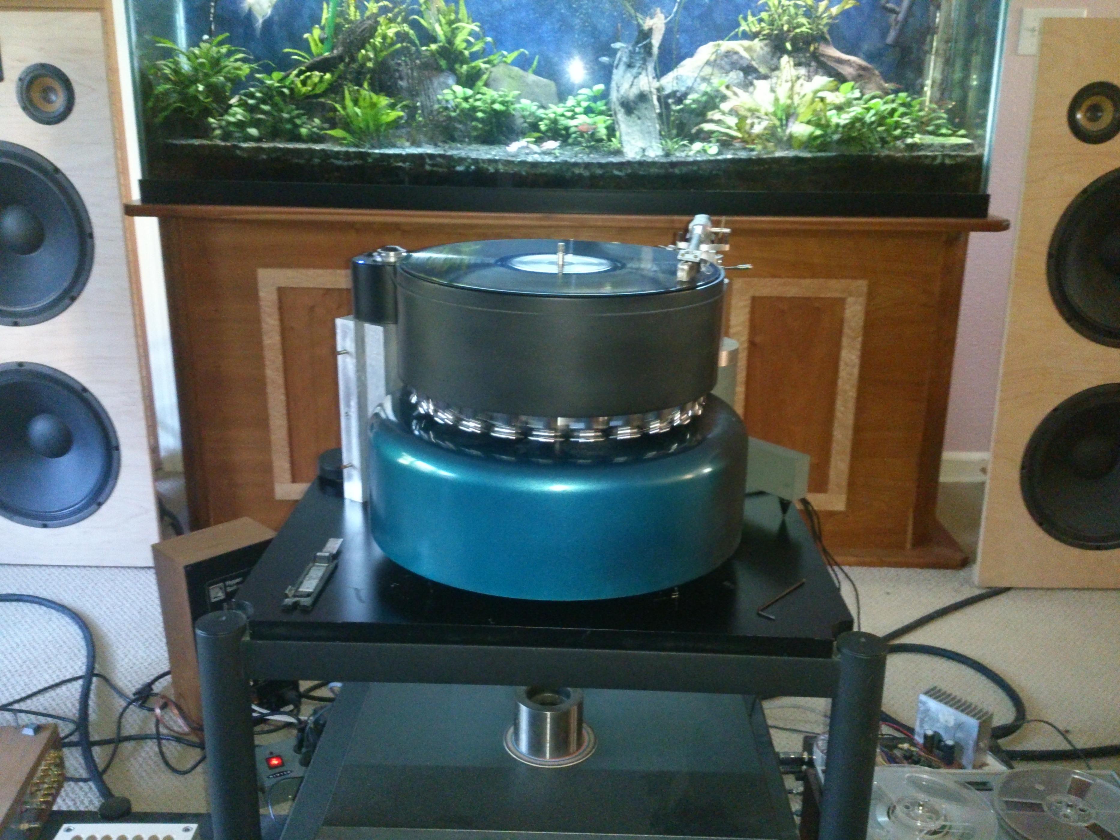

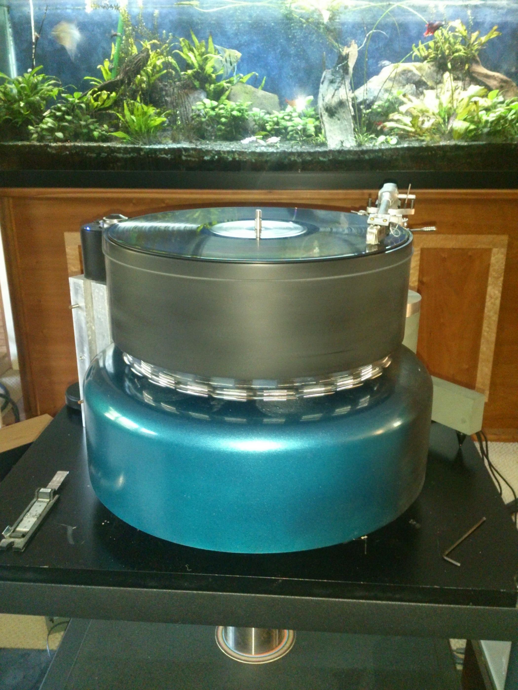

This is by far the best sounding table I've encountered. Dave is a very happy boy.

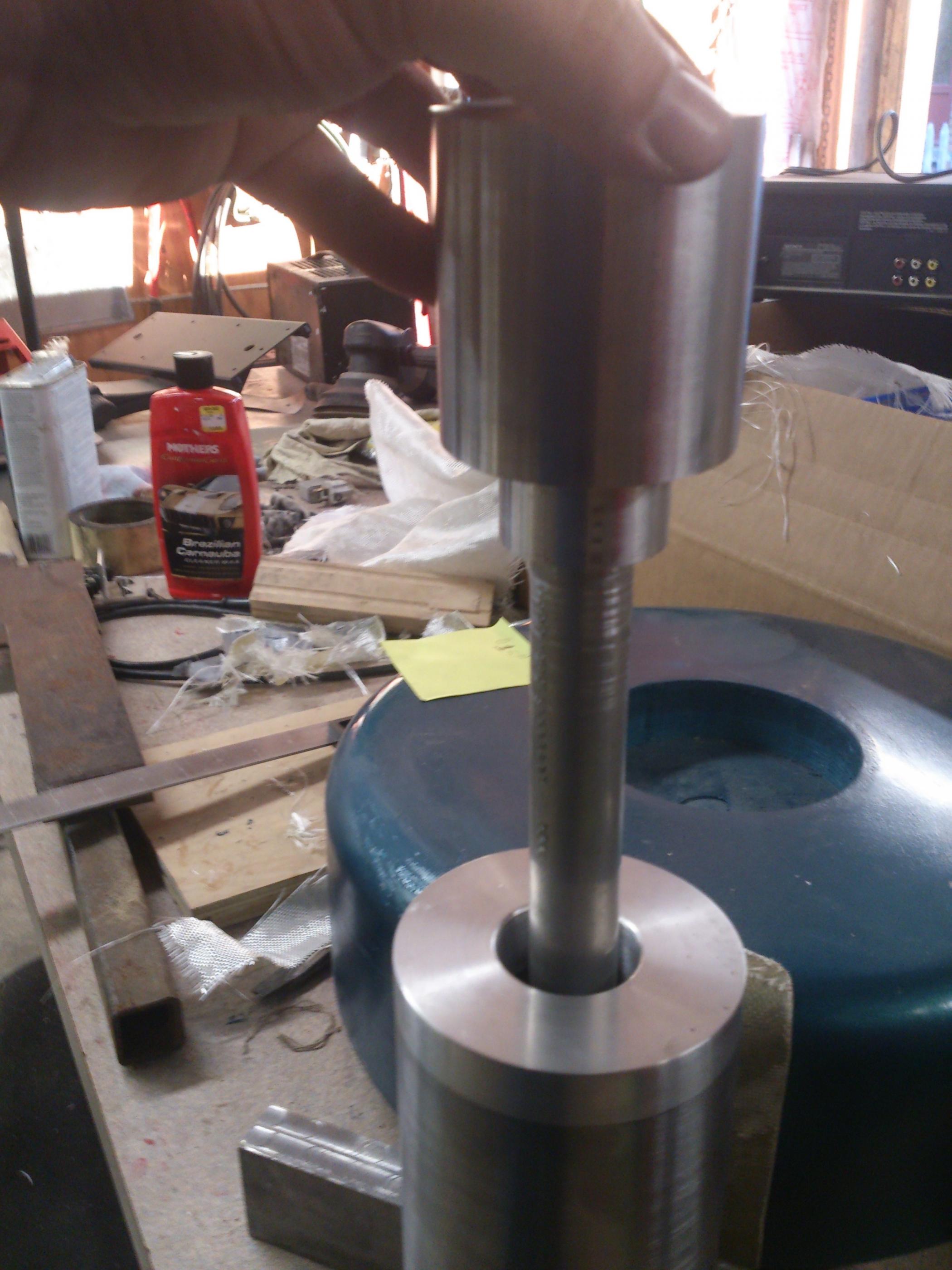

I forgot to mention that I used a pair of the biggest ring magnets I could afford to achieve some mag lev. By my calc, it should be lifting about 17 lbs of the total 38 lbs of platter weight. I figure this should extend bearing life and reduce noise.
