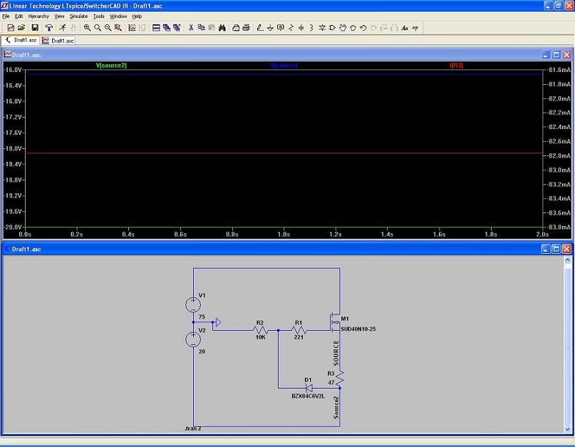

OK Folks, I am going to show my ignorance here and beg for mercy. Someone please help me figure this out. 🙂
I want to be able to calaculate the bias current out of the CCS and know how much power is being dissipated by R8 in my schematic.
If I am aiming for a bias of 80-100ma from the CCS (40-50ma per side) what value/rating should R8 be if R1, R2, R6, R7 are 1.5K.
Supply rails are +75V and -20V
The circuit function fine and sounds great with a R8 values of 27R but according to my calculations that means its dissipating 14W!!!!
that can't be possible now can it?
Also note that R5 is now 10K.
I am stumped. Someone please help me understand.
You can find my schematic here:
http://www.diyaudio.com/forums/showthread.php?postid=855588#post855588

V(R8) = V(D1) - Vgs where Vgs for the IRF610 = 4 to 4.5V typically
then
I(R8) = V(R8) / 27ohm
Assuming that the Vgs = 4V and the zener diode D1 is 9.1V, then
V(R8) = 9.1 - 4 = 5.1V
then
I(R8) = 5.1V / 27ohms = 0.189 A or 189mA
The power dissipation on R8 is then
P = I*I*R = 0.189A * 0.189A * 27ohm = 0.963 W
The entire circuit should only dissipate about 10W per channel.
Hope this helps.
Terry

The spice model looks more or less correct, except that it will grossly overestimate the power dissipation of the FET. One problem might be that you have substituted a different FET in the model. You can download an exact spice model for the IRF610 from International Rectifiers website.
One more question, It appears to me that the output impedance of the circuit would be 750ohms. Am I on the right track?
