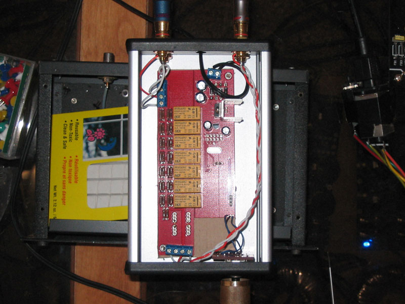

Hi,Russ White said:Ok Guys,
Between playing with my daughter's new toys and keeping my spouse happy I had a little time to design a small PCB for a balanced stereo volume control for Twisted XBOSOZ. It should work fine with anything from 5-20VAC power in the 20-30ma range. 🙂
The circuit is simplicy itself 2 Maxim DS1868 digitally controlled dual linear potentiometers which have a very good reputation and I have used them with success in the past (with a digitally controlled active filter) and a PIC12F675 to crontrol them. The rest are simply PS bits and interface.
The interface is a linear pot with center detent for balance, and a log pot for volume. The pots are read by the PIC's ADCs and the 8 bit results are used to calulate the channel volumes. There are no passive components in the signal path, just the two DS1868 which have very good SNR.
The board is small and simple, but it leaves the door open to experimentation.
Brian says we can do kits for these at a very reasonable price, and I am sure the PCBs will cost about the same as the Kookaburra.
Here is how it looks so far, remember this is still a work in progress. Any feedback is appreciated.
The PIC is on the bottom to use the copper pous to block some RF from the signal bearing devices. I have used this trick with success before.

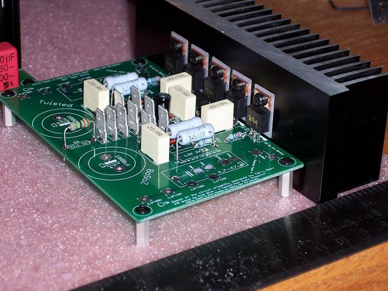

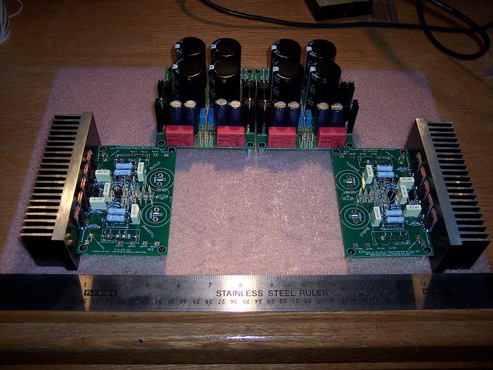

Here is my preamp fully assemble with a few caps omitted for a better view.
Notice how the Fets on the preamp are mounted to a 2" section of the "barred boss" aluminum heatsink. Works out very well.
The preamp and power supplies with 1/2" standoffs will easily fit into a 2.75" high case.
I am going to use a 16" x 12" x 2.75" case.

Russ good job 🙂
Are you guys able to get more of them heatsinks ?
Would be perfect for the group buy and have them screw holes drilled and tapped 🙂 I certanly would like a set 🙂

FET Spacing
Russ,
Measuring from the board it looks like the FET's are spaced about 39/64 or 0.61 inches apart. Could you confirm the spacing you laid them out at? I know it is easiest to mark the heat sink using the mounted parts, but that gets a bit awkward at times.
Thanks,
Craig
