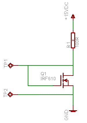

Brian,
I hope you did not follow your drawing. TP2 is tied to S and to ground. The way it shows, your meter is shorted. I suspect it is the drawing, not the circuit.
As for my request to get some Jantzen caps as you might have extras if they are optional for the kits, Parts Express is out of stock of them. I wonder why that might be.....😀
Craig

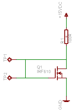

Ooops, you are right. Drawing was wrong. Here is the correct one.
