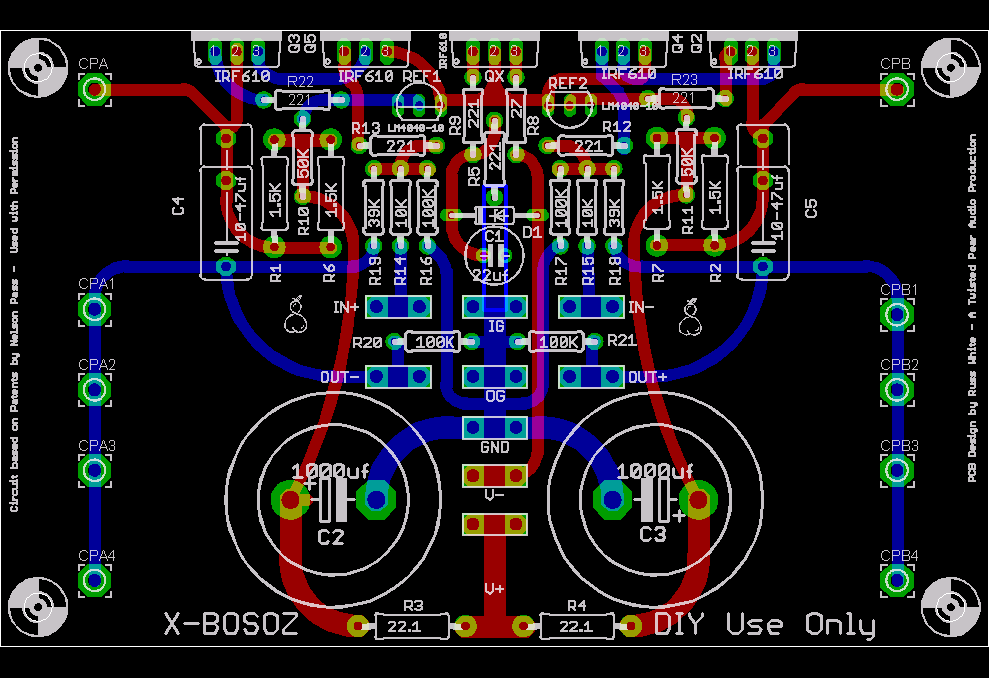

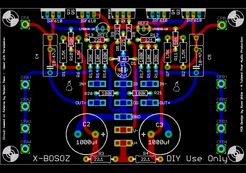

My Take on X-BOSOZ
fixed dupe traces
Also fixed a couple minor placement issues.

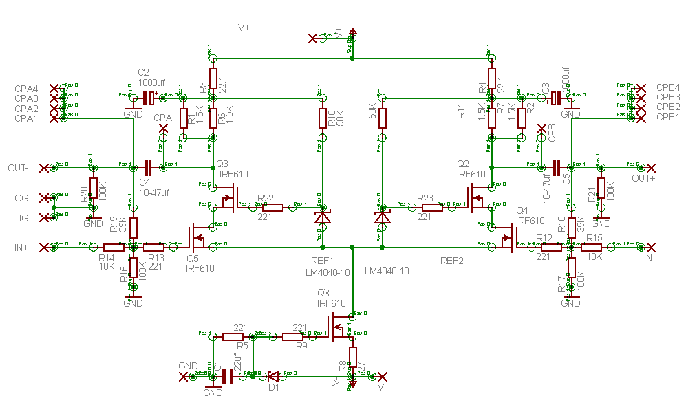

Request for help. 🙂
Hi folks,
First I want to thank everyone for their kind words and helpful tips.
Now I need a little help with this circuit. I am not sure about ratings of certain parts, especially the resistors.
Particularly:
R3, and R4
R1, R2, R6, and R7
It looks like the other resistors can be standard .25W metal film types correct?
Also what voltage rating should C1 be 100V?.
Also I plan on resizing C2 and C3 to be 25mm diameter and 10mm LS which should fit most common snap-in 100-200V 1000uf caps. Right now it is set up of 7.mm straight lead types.
Any help with these details from those familiar with the circuit is great appreciated.
Cheers!
Russ

Russ,
In my circuit, I used a single 1/2W resistor where you have split it to two resistors (R3 and R4). I believe you can use 1/4W with your circuit.
I used a single 5W resistor where you are using R1/R6 in parallel. For R1, R2, R6, R7 I would recommend 3W rated resistors as a minimum.
As to C1, its voltage rating will depend on the value of your negative rail voltage, which can be in the range of 10-20 volts. I don't think you will need a 100V rated cap there.
Lastly there is one set of resistors missing, which I included when I built my preamp, but missed including on the schematics. Q2 and Q3 need 221 ohm gate resistors in the connection to the voltage references. (My Bad :dead: ).
Otherwise it is looking great.
Cheers, Terry

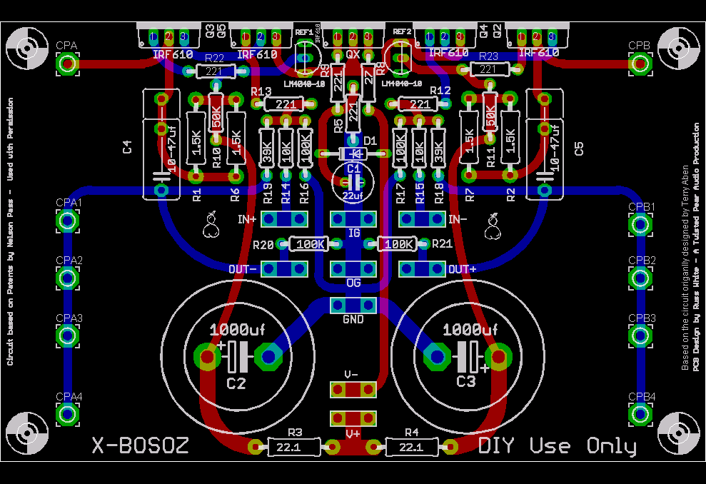

gate stoppers and another dummy question
Plan on using pots to control volume in mine. Do they need to be 10K? Seems that the input capacitance was high enough that a 10K pot was recommended to prevent high end roll off.
Have several 25K laying around unused. Hate to buy more to use here.
Also, output coupling cap selection. What is the range of dc seen here? If it is real low, may try to use some output transformers to do the balanced to single ended conversion. Prefer iron to caps where possible. Do not want to use both.
George
pic
Good call Terry. Hey, I was just getting used to the new picture then you switched back.
