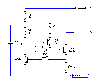

Adding the output stage to the driver stage is making the CCS for the driver stage slightly unstable... So, now I have to ask myself whether this could still be a problem when I finally make PCBs.
Dunno, hopefully not.
Actually, looking at some other designs I see that this should not be necessary... Also, I have so many clip leads and wires that I'm probably having all sorts of problems with my test equipment.
That's what I'm thinking too. In the meantime, maybe it would help to put a resistor at the output of the buffer to isolate it a bit from the wiring. Maybe a small capacitor to ground too, before or after the resistor.😕

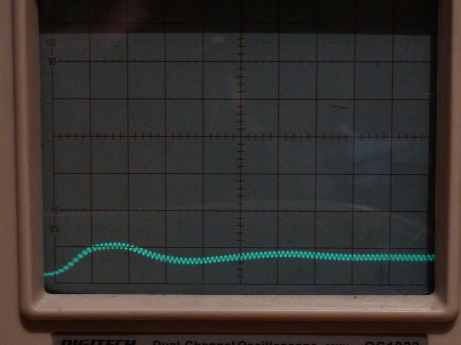

Thanks Godfrey, I tried the modifications you suggested. And yes, it does look a lot like where we left off 🙂 The following shots are where its performance now stands.
Boy do I have some cool scope shots for you 🙂

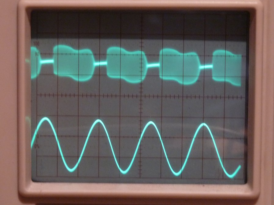

Pic 1 is the amplifier's 20kHz square wave output on the bottom plus the base voltage of the MJL21194 on the top. As you can see the square wave isn't too bad. But look at how fast that base voltage is moving! I zoom into the fuzzy part as much as possible (0.2uS) and it _just_ becomes apparent that there is a waveform there, but the period of the waveform is still much less than 0.2uS. So we are talking about tens of MHz oscillation.
I guess this is to be expected and is just the whole process of the CCS loop operating - sensing current, turn off, current drops, turn on, repeat, etc. But I have no idea how much you would expect to see and how much is excess oscillation. Looks neat though!
Pic two is the same again, but with a sine wave output.
Pic three is what the fuzzy bottoms of the square wave output actually are - baby oscillations. Again, very fast at 0.2uS/division. There's no way my inductance-rich lash up is going to help at those frequencies.
I guess this is to be expected and is just the whole process of the CCS loop operating - sensing current, turn off, current drops, turn on, repeat, etc...
That's pretty much how it works. There should be no oscillation at all though. It only happens when the circuit keeps over-reacting to changes in it's own output, as you described.
If you build the BJT version, I'd strongly suggest allowing for the extra resistor and capacitor shown in the schematic in post 61. Also, I just remembered (duh!) it's a very good idea to include a base stopper resistor for the MJL21194 - similar idea to gate stoppers for mosfets, but much lower value.
With them, it should be easy to stop the oscillation. Without them, probably not.

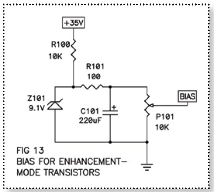

I'm also considering changing the bias control to the one shown below (from Nelson's latest creation). Seems to be a worthwhile modification to get a more stable bias voltage, though a higher value zener than the one shown would be required.

The bias scheme you showed looks good, so long as you remember to flip polarity since you're using a negative-earth arrangement. One Possible caveat: If your mains supply isn't as stable as it might be, you may be better off with the old circuit, which will tend to track slow changes in PSU voltage, and keep the output biased about half-way between earth and the "voltage-of-the-day".

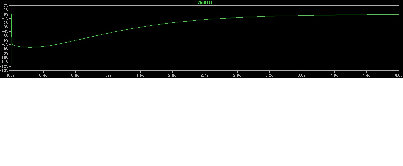

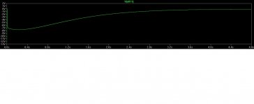

I have tried to sim the turn on transients - the speaker one is attached. Pretty nasty.
I also looked at the base and gate voltages and there are indeed a few possible issues. The Vbe of the transistors does go up to about 10v I think, which is too much, but it is for fractions of a nanosecond. Not sure if that is significant or not?

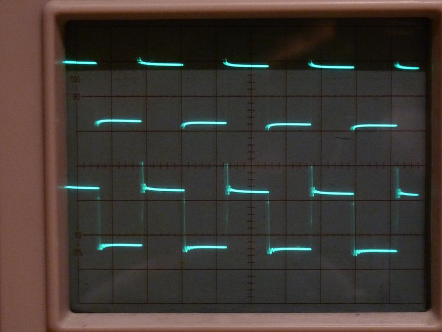

Got the PCBs back today and assembled one tonight as best I could with the parts I had available (fig 1).
Plugged it in...no smoke.
Adjusted the bias pot...output varied appropriately. Set it to just under 1/2 the rail voltage. Plugged in the sig gen and scope.

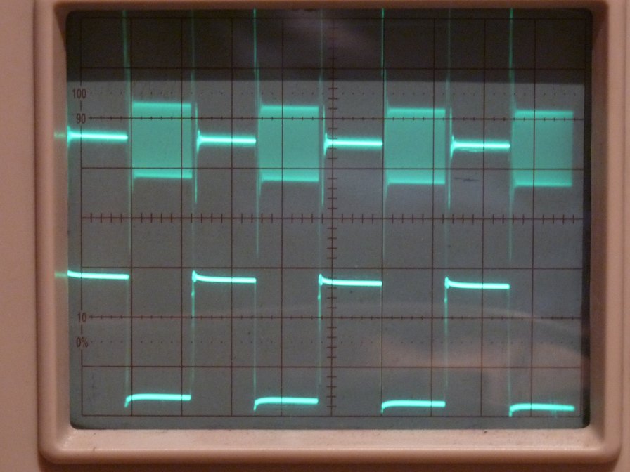

First the 20kHz square wave test (fig 2). Rise and fall times not too bad, but still quite a lot of ringing (fig 2 & 3).
I'm not overly concerned about the ringing though, as I'm fairly sure larger gate stoppers would prevent it - the waveforms on at the 240 fet gate is dirty whereas the waveform at the gate stopper is clean. It seems some oscillation is happening in the few mm of lead between the fet and the gate stopper...amazing considering how close I have them.
There probably isn't any point using larger gate stoppers though as audio waveforms would never cause this, right?
Anyway, it sounds quite nice with my little preamp. Pretty happy with it really. The treble is especially sweet sounding, but overall frequency response is very good.
