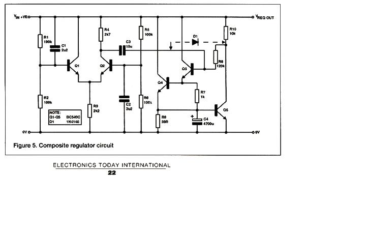

Re: JLH Shunt
AndrewT
This was in ETI in 1981? i think, SandtK can confirm on date.
I have previously search the forum looking for some reference to this circuit, without luck.
SandyK sent it to me a while ago,,,,, thanks again SandyK.
I have used the superreg's (in some form or another) for clocks and other limited current stuff and they work well.
I've tried the JLH in preamps, input stage of amps, cd buffer psu etc, It is very good.
Can anyone or has anyone seen a reference to it? (besides SandyK, a few weeks ago)
I wonder if it has been overlooked or dismissed for some reason.
and why, (might save me from the same mistakes)

sandyK said:I have previously mentioned the effectiveness of the JLH shunt in various threads.
If anybody would like to see the original ETI article, send me an email.

The year of publication is not known. The clipped out pages from my original copy of ETI, show page numbers only.
Perhaps the JLH website now has this information ?

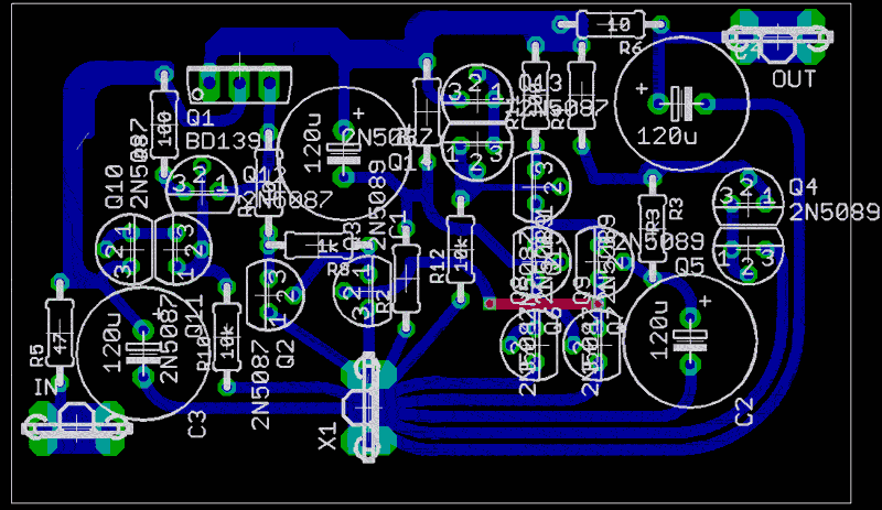

This nifty little circuit consists of a ripple detector, a constant current source and a shunt regulator. It's intended as a piggyback for a standard three pin reg like LM317 to clean up its output. It's capable of handling currents from mA to several A without major modification.
Parts are expected next week. Thanks for the input and greetings to you guys downunder!😎
sandyK said:... excellent results, even after already using the original design's regulated front end supply.
This design gives a marked improvement over the noise performance of conventional voltage regulators, with VERY low impedance past 100KHZ ...SandyK

According to http://www.tcaas.btinternet.co.uk/jlharticles.htm the article is published in Electronics Today International in 1994.
It's in post #8Originally posted by carlmart Did you forget to attach the nifty little circuit?...

Hmm … impressive simulated performance. Though I have a couple of suggestions to simplify the design:Cauhtemoc said:The second regulator is a cross between the POOGE and Walt Jung's super regulator. I use two transistors as a reference here as well, but I replaced the op amp with discrete components. I did not know how this would affect the performance, I mainly did this to lower the cost. The entire regulator can now be built for around $5.
1) Re-arrange the reference voltage from ground to output rail – this allows setting the current for the difference amp with a single resistor, and without the current being dependent on output voltage, and
2) Substitute the remaining current sources for J-FETs and resistors.
Attached is a drawing of the modified regulator. To complicate matters I have added a fold-back current-limiter.
KJ
The red line in the graph is ripple rejection for 5.4V output in to 100 ohm, reference to the db-scale (frequency sweep of 1 volt AC in the input). The ripple rejection is at about –170 dB up to 4K Hz. The green line is load regulation for 5.4V output loaded with 100 mA DC and 100 mA AC, reference to the VOUT/V-scale, modulated ACV is at about 15 nV up to about 5K Hz. This equates to a dynamic output impedance of 150n Ohm, and which is bound to be ruined in any practical implementation.KJ42 said:
KJ
I think I’ll scrap my previous experiments in this area.
KJ
