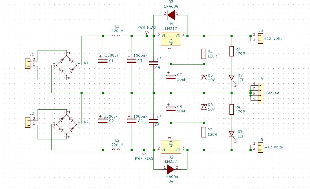

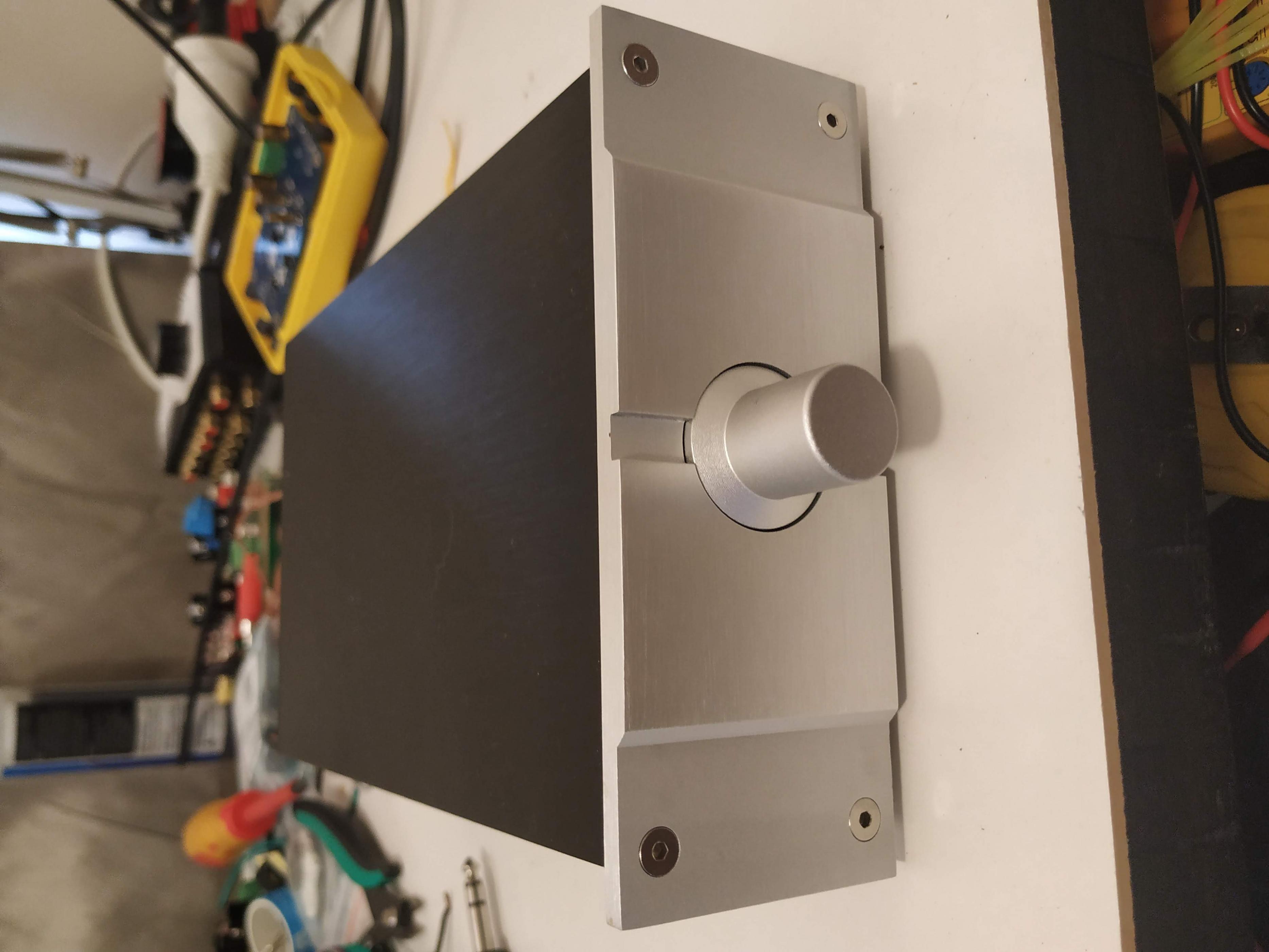

My take on LM317 / LM337 power supply PCB
I need a very simple, basic LM317/LM337 that supplies +/-12V at 100ma or less.
I really like some of the features here such as the CLC input filters and the LEDs that I can take off board to indicate power. The only 'improvements' that may suit my purposes is replacing the Zener with a potentiometer and being careful about what I use for C9 and C10?
Dan
attachment.php

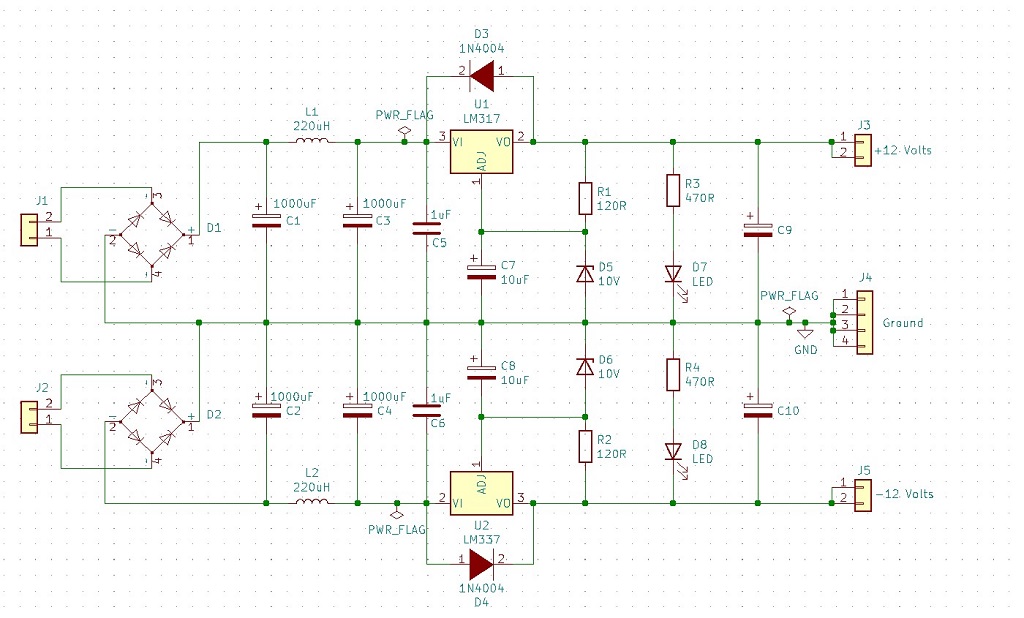

Not the only:
1. Add RC-snubber.
2. Be careful with L1/L2 DC resistance. The larger - the better. With a low DC resistance it may become ringing and things became worse. It can be even better to add some several Ohm resistance in series.
3. There is no strong need in C5/C6 (if there is C3/C4 present).
4. You may increase C7/C8 to 22/47/100 uF (but not larger).
5. I prefer to use general purpose electrolytic types at C9/C10 place and don't think about will it ring or not with low-ESR (low-impedance) caps (ceramics etc).
Not the only:
1. Add RC-snubber.
Size and cost makes the following my first choice for L1/L2.
https://www.mouser.ca/ProductDetail/Bourns/RLB0913-221K?qs=Rodu%2FvDoGwIMI82lSmllkQ%3D%3D
Dan
