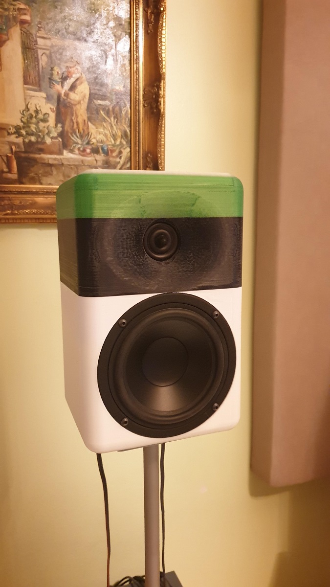

Interesting project. I would add a more complex internal structure for the full range to eliminate internal standing waves. Having done couple projects with spherical IKEA Blanda bowls, they required some kind of internal structure to avoid having a nasty resonance that's very hard to filter out at least passively.
On my 3d printed speaker I've gone for a classic golden ratio box with generous roundovers, but the internal shape is more complex with wave-like structure. Attached is picture of my project, 270x170x153mm speaker with 1" tweeter and 5" midbass. Like you, I think a filler between walls is a must with 3d printed speaker, the material alone has a horrible performance if you use just regular walls with infill. Resin or concrete is an interesting option, I am currently using very fine densely packed sand to fill the enclosure walls to provide mass loading, one speaker has about 1kg of sand in enclosure walls.
Have you done comparisons between different filler materials? Are you printing the enclosures from PLA?

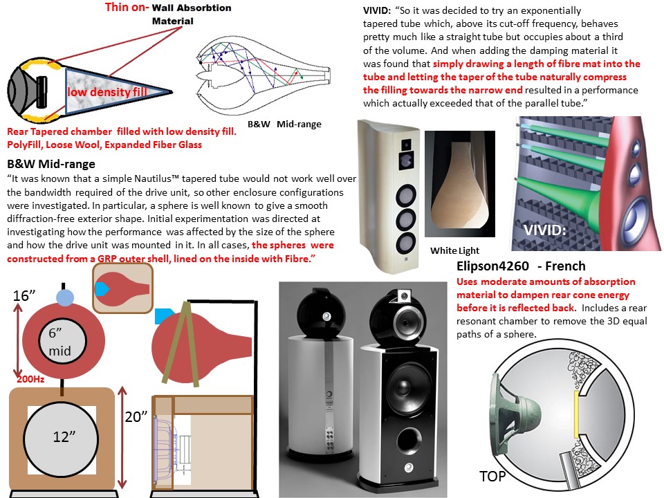

A coaxial speaker would be a good match for your larger sphere.
The French Elipson 4260 speaker uses a midrange sphere with a rear resonant chamber, plus some absorpton material, to remove the 3D equal paths resonances.

I've begun thinking about the path resonance issue, I think what I might try is mounting a squishy silicone sphere in the centre of the unit, with my theory being that every reflection should point at it, and the vastly different energy absorption should throw the waves out of sync. I may also try a dense foam ball.
The outside of the box is also important. I'm thinking that a tear-drop shape with an absorbent 'spike' at the back (180 degrees around from the driver) could help absorb baffle resonances where the wave would otherwise go full circle around the box.
In my mind, the rear waves clashing should create a null, like a cardioid mic, half my brain is saying that will stop stray waves and reflections behind the speaker, half my brain is saying 'just go as omni as possible' I think i might create a cone shape i can stick on the back temporarily to test this.
