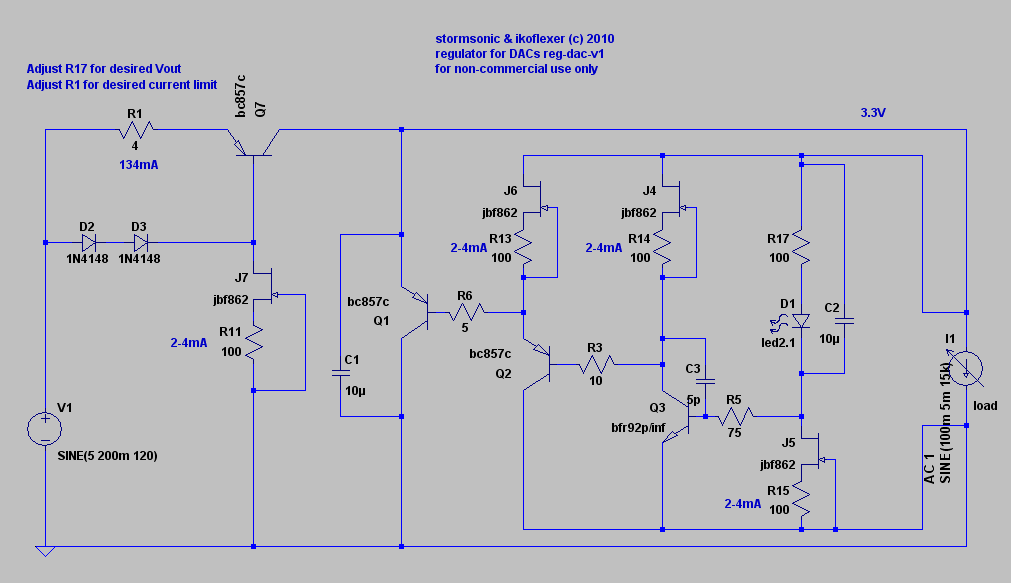

@Iko, is this your last schematic?
The trace from J1's source is going to J2's source instead of the drain. Fixed error
post1259,
Q2 & J6 should be fed from the supply rails, not from the measurement rails.
What voltage (Vdg) is across the BF862 when they are set to 2 to 4mA?
I think you should be using a low Vpinch off for some of these locations, particularly J5 and maybe J6.
Could you link or post the good one with no errors?
I don't have a link. Look back in this thread, and find the one I posted last and uses power mosfets for the CCS and shunt.
