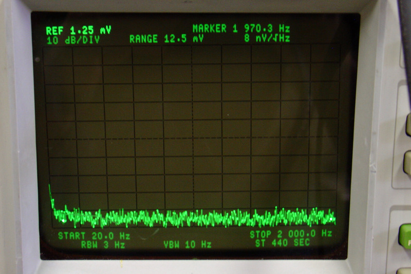

OK, I've been running again quite a lot of tests. Here's an image that might be of interest, regarding the noise. This is rev 5k positive, with about 11V output, 430mA idle current, a 33uF cap right on the output of the regulator. The load is a power mosfet biased to draw about 200mA DC, located about 7 to 9cm away from the regulator. Across the load there's a 47uF bypass cap. I put this here to make sure that people who bypass their loads with caps don't run into trouble. Up to 40MHz I could detect no nasty oscillations, even when I applied a sine wave to the mosfet thus making it draw variable current as well.

Oh, so I forgot to qualify this 8nV/rtHz figure. The spectrum analyzer gives exactly 8nV/rtHz with a 50 ohm bnc terminator connector at its 50 ohm input. So the regulator noise is not above the noise floor of the HP 3585A. Now I really have to finish the noise preamp to get any meaningful measurement.

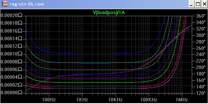

It has been discussed previously that running at higher current due to changes of gm of the MOSFETs the output impedance can even be reduced! However, no figures or charts have been given for comparison. Is your published impedance plot based on about 400mA you normally run?
I am wondering if you could post a few simulations with CCS run at 100mA, 200mA and 500mA so that users can make their choices. Perhaps even with lowish current the impedance of the regulator is still so low that wire resistence dominates?

Here Bill, something like this? I stepped R1 as 16R 13R 10R 7R 5R 3r 1R 0R5 which would give a current limit of 170mA 208mA 270mA 386mA 541mA 901mA 2.7A 5.4A respectively. The simulated output impedance behaves as you can see in the attached plot.
My worry wouldn't be that the lower current doesn't give one enough output impedance, but that higher current will easily lead to instability. I haven't done enough tests at very high current so I can't vouch that it's problem free.
