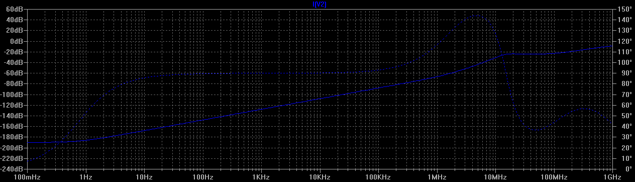

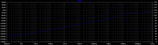

Have you taken a look at what cascoding does to the line rejection of a series (BJT) capacitance multiplier? Somewhere around -108db I think. However there is an alternative... We can increase OLG in the CCS.
Try this. Homemodder has used this kind in his amplifiers (in low power places), except with BJT output. J1 at the bottom can be made a resistor... This design is really limited only by the current source used and the MOSFET's Cjo. Even a simple resistor gives good performance. (sorry, PSRR graph was taken with a perfect 2mA CCS, the actual graph bottoms at -120db with the current Jfet CCS)
- keantoken
http://www.toshiba.com/taec/components2/Datasheet_Sync//66/7771.pdf
- keantoken
I got similar results without the ideal CCS. I've tried a lot of ideas in the CCS, cap multipliers, and gyrators. Just haven't posted them.

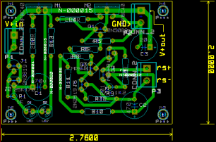

I decided to take time now to produce a proper PCB for v2, and stay away from other distractions. It's mostly finished, but I've been pulled away from it by various other things. It'll look something like this, still have to bring it up to date with release 5c. It's going to be 2.76'' x 2'' so it's not too large, but not miniature either.

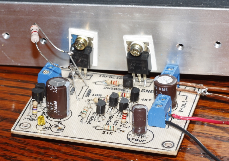

An update and a bit of good news. I've finished the pbc layout and built another prototype tonight using the board. The board is made around rev 5c posted before. I aimed for about 20V output, and fed it 45V DC because that's what I had around. The board has room for two LEDs, but I used just one because the voltage across it was about 2.1V. The following values I used in the real circuit:
R2 = 2K9
R7 = 470R
R9 = R11 = 15K
With these the output voltage was about 20V, and the current limit was about 500mA.
