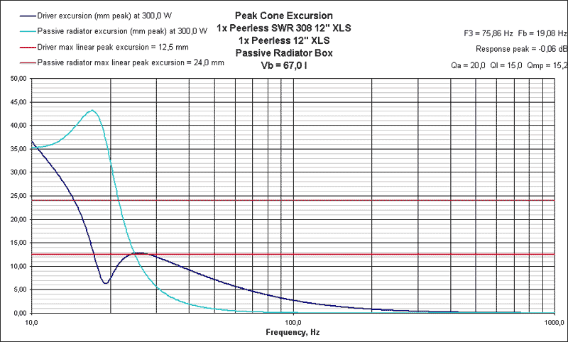

I am a newcomer here at DIYa so please bare with me if it's too obvious . I have just started my first project and I hope you will give some good critique and suggestions before I start the power tools.
I am going to build a subwoofer for my home theater. I have very good sound already and just miss the feeling of that very low bass from 20-65 hz that my B&W (NT 9) speakers can't reproduce convincingly enough.
I have decided to use a Peerless 12" XLS woofer (SWR308-830500) and probably the corresponding 12" slave (830548).
For the box I have come up with a 67 l. (2,37 cft) rectangular design with both driver and PR facing towards the listening position. The beauty will be powered by a 200W ZapPulse 2.2 unit from LC Audio.

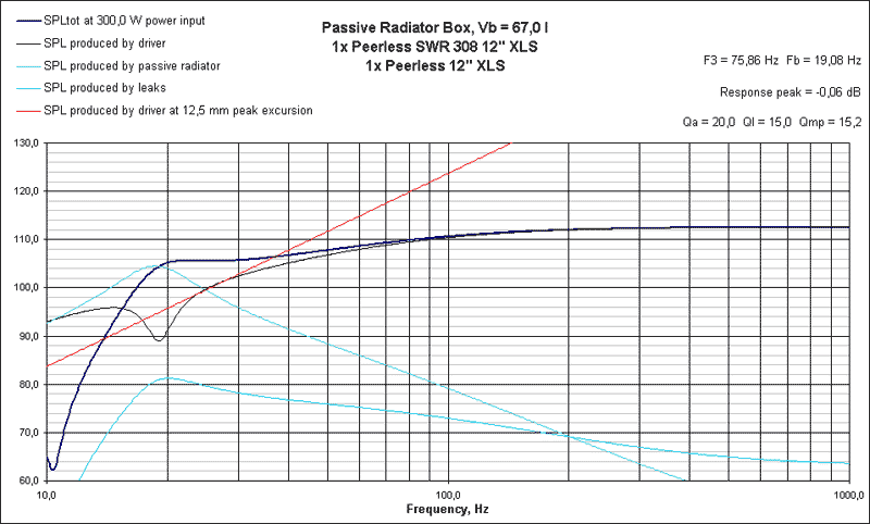

I have used UniBox 4.04 and Subwoofer Simulator to calculate the size of the box and the corresponding graphs. Both programs are giving me almost the same result (all specs. within one percent) and to me it looks very nice (remember, I'm new to this stuff). I would be happy if some of you guys could take a critical view at my design and tell me if I'm missing something obvious?
Finally a few stupid questions ;-)
SPL
When looking at the SPL Total, is the graph taking into account the rather steep drop in the drivers frequency response that starts at appr. 100 hz?

What does it really mean that there is thse huge peaks and drops in the curve?

...and you might find, once room gain is added in, that the sub has a big bump at the bottom.
This is serious... I have just used Room Response Calculator v0.6d to calculate my room gain and in the subwoofers intended working area I have just 4dB difference in gain (peaking at 20 hz).
I have done a simulation in UniBox 4.04 and if it does become a problem I can (apparently) just fill the box completely up with damping material which will reduce SPL with 2,5 dB. I guess that should compensate or am I missing something?
The reason I consider this solution is because I'm going to move to a bigger place very soon and get a much bigger (+twice the size) audio room and I think this will reduce room gain.

As for your other questions, Claus:
You're referring to the plot in the Peerless datasheet? The drop is due to the measurement method Peerless used to aquire the data. The plot in the pdf doesn't have to do with a 67l box with passive radiator
Your software calculated the net volume inside the box (it wouldn't make sense for the programm to calculate your gross volume anyway).
The peaks are the way a loudspeaker "reacts" on voltages at different frequencies.
The fact that there are two peaks (and a drop in between) shows that your software simulated the behaviour of a vented (bass reflex) box. Speaking of equivalencies, the passive radiator acts like a huge port. So everything is pretty normal with the impedance plot so far.
