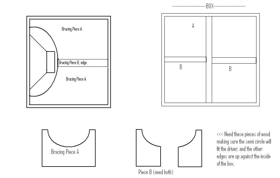

How do I brace it properly? I know now that I need a horizontal and vertical brace in the middle of the cab but if not what should be the width and is this sufficient in my 24 x 16 x 14,74'' cab?

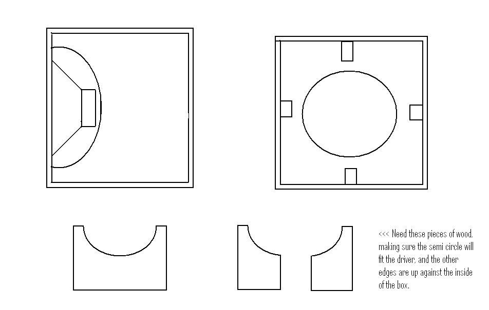

Drawn up a quick diagram for you.
Feel free to ask about it.
Chris
Edit - note, this is fairly elaborate bracing, but it is very good at what it does (I used it for only one bit of my sub, which is why the other panels vibrate), and the panels braced are rock solid no matter what the volume.

If I understand this right... I need to make rectangle with a quarter of a circle (so it won't be in the way of the driver) And put it on each side of the enclosure to form a kind of half sphere behind the driver? this image is only 2D it would be the same the other way around ( vertically) is this about what it's supposed to be?
Nearly. The part at the bottom of the brace would reach the bottom of the box, so all panels are braced together. But yes, the half sphere behind the driver is correct.
Chris
PS - sorry for the diagram before. This one is better.
