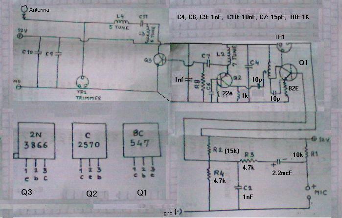

I have used a 2 stage MFB filter with a band width of 30khz.. So the pass band is exactly about 23khz to 53khz.. and have also put 50ms preemphasis across the encoder input...
BUT, i dont know if there already exists a pre-emphasis in my MONO FM xmitter ..?? Because i havent located such parallel RC combination neighter at the input...I HAVE ATTACHED MY MONO XMITTER CIRCUIT DEGISN WITH THIS POST.... So pls look at it and help in locating its pre-emphsis stage, if its really present..!!
And finally, i have purchased the MONO Transmitters from a electronics kits shop quiet some time back when i got the taste of wireless electronics.. The transmitter is actually for transmitting VOICE Conversations (by connecting its input to a condenser mic) and not for directly connecting any audio..
is that the problem because in such a case the modulator of the xmitter may not have linaer freq and phase charactersic upto 57KHz and might create some big problems...??
Pls reply..

moamps said:
And a modulator in Tx must have a linear frequency and phase characteristic up to 57kHz.
How can i assure that my Tx has linear freq. phase characteristic upto 57 khz..??
And one thing, the mono fm Tx that i have is actually for transmitting VOICE CONVERSATIONS....
so i doubt that the characteritics might be linear till 57khz..!!! Pls elborate on that...
-- Prasanna (xitronics)
diyAudio Member
Joined 2002
this Tx isn't intended for stereo FM. Q1 is oscillator in grounded-base connection with FM-AM modulation in base. Frequency band that can be modulated is limited with R3C2 LP, which is around 30kHz. Also, modulation linearitiy is very poor with high level parasitic AM.
Usually, varicap-controlled/modulated oscillator is used in stereoFM transmitters.
A good book on small transmitters is:
R.F. Graf, W. Sheets "Build Your Own Low-Power Transmitters"
ISBN 0-7506-7244-7
Milan
