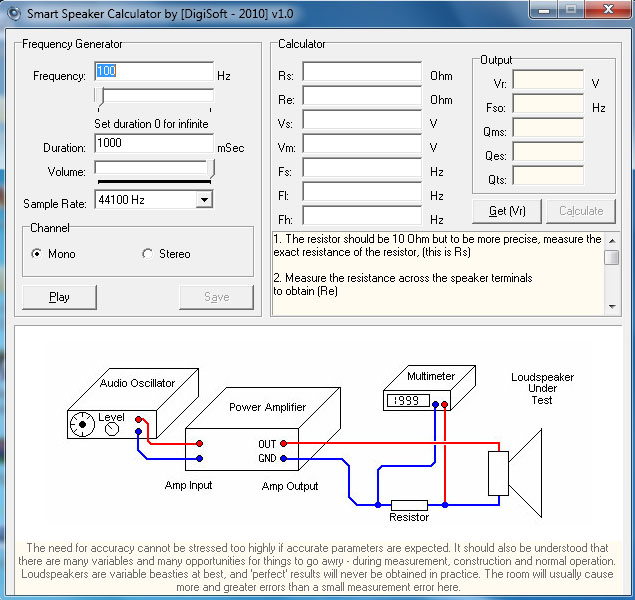

My software for calculation Thiele/Small for unknown speakers
SmartSpeakerCalculator for Unknown speakers
This is the software I build today to find the Thiele / Small parameters of unknown speakers. This method is very accurate if it is made in perfect conditions and very precise equipment. It is very useful when you have speaker without parameters and you want to make box for it.
Please post your comments and suggestions. In the next version I'll include Vas calculations.
Enjoy and post your comments.

Ok So I've measured my 12" Bass using my software and I got Qts of 3,5857 😱
Is this really bad bass?
Rofl, a Qts of 3 would be bad enough... 0.3 would be decent driver Q, are you trying to say you measured a Q of over three thousand or just over 3? 😀
You need to operate in a dead quiet environment when testing driver Q, the driver needs to be in free air & suspended vertically as it would be mounted in the front of an enclosure.
I test in virtually the same way, except i don't use a power amplifier, just the function generator output (50 ohm) & the same 1% 10 ohm resistor & multimeter. You need to operate at very low current as well..
Well my speaker was at floor. Could it be the problem?
Can someone measure speaker with this software that has already manufacture Qts and tell the results?
The Q for my speaker was 3 :S not over 3 thousands 😀

If the note on the bottom of the software is really important "The need for accuracy" then you must understand that you cannot get accurate data from a single frequency measurement using a multimeter! There are lots and lots of better ways to do the measurements than that.
