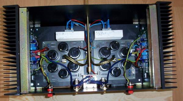

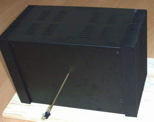

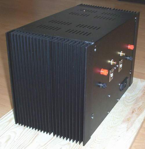

I decided to show you pictures of my small Aleph-X. Small, because its voltage rails are about 15V and 1.6A bias per side. It gives me 12W rms or so at 4 ohm load. It is enough for me im my 20 m square room.
There is no front panel yet, maybe it would be made from wood. Currently my AlephX is unbalanced however I am going to make a BLS preamp.

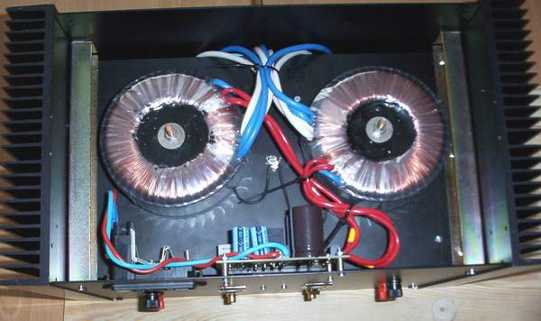

More technical info:
Two 300W tranformers, two diode bridges , two power supplies with CRCRC filters (20mF R 10mF R 10mF) on each rail. R consist of two parallel 0,22 ohm resistors.
Differencial dc on the output are about 20 mV at start and stay very stable. Absolute DC start with 4V and decrease to about 30-40 mV after 1 hour play.
My AX is unbalanced and has two 4.7 uF input capacitors on each channel. One side of each channel is grounded before the input capacitor.
I have slight hum (my loudspeakers are 4 ohm, 90dB) and think, that I should increase the capacitance of filtering capacitors and resitance of R.

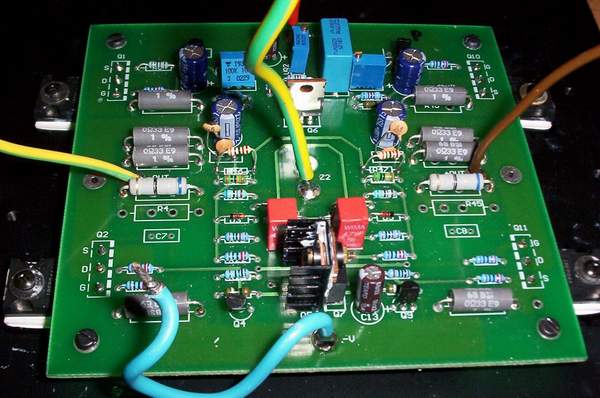

Power transitors are IRFP044 and are biased at 1.6A (0.33 ohm bias resistors).
PCB is a slighty modified HIFIzen design (added input capacitors) – very thanks hifiZEN for inspiration!
