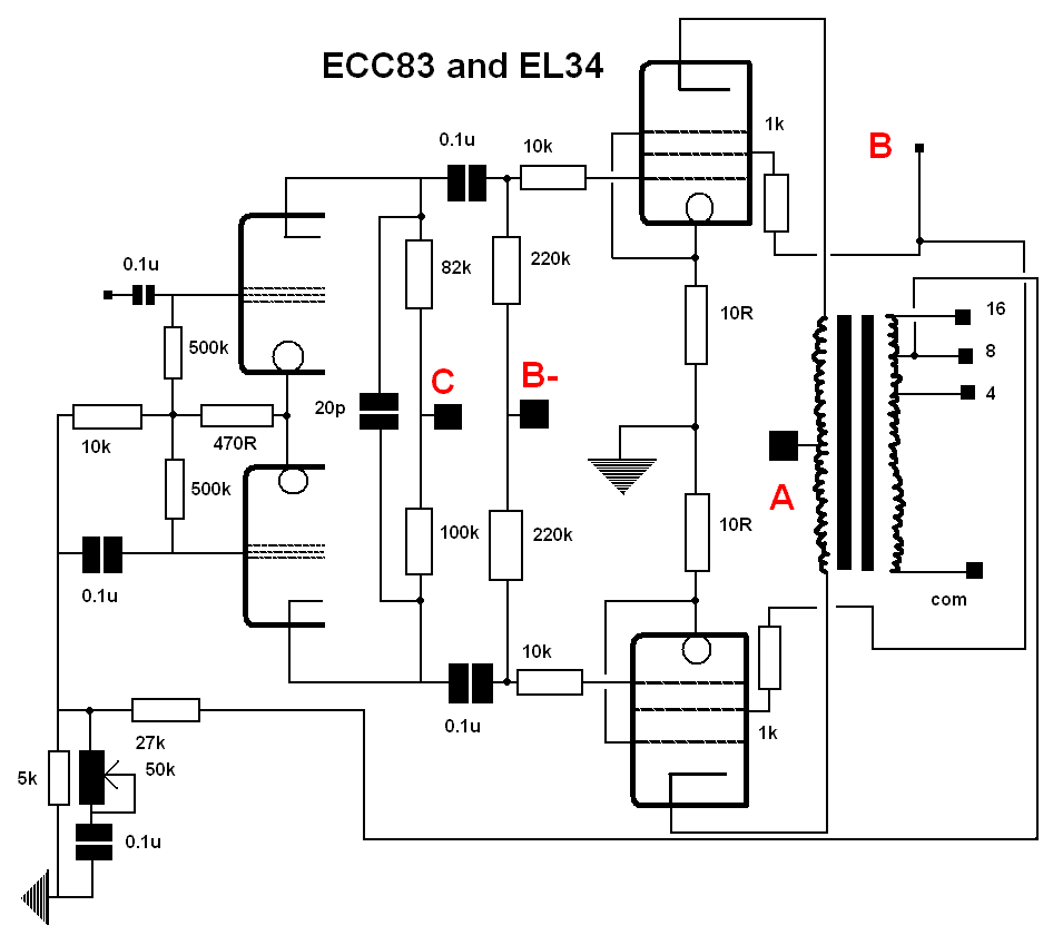

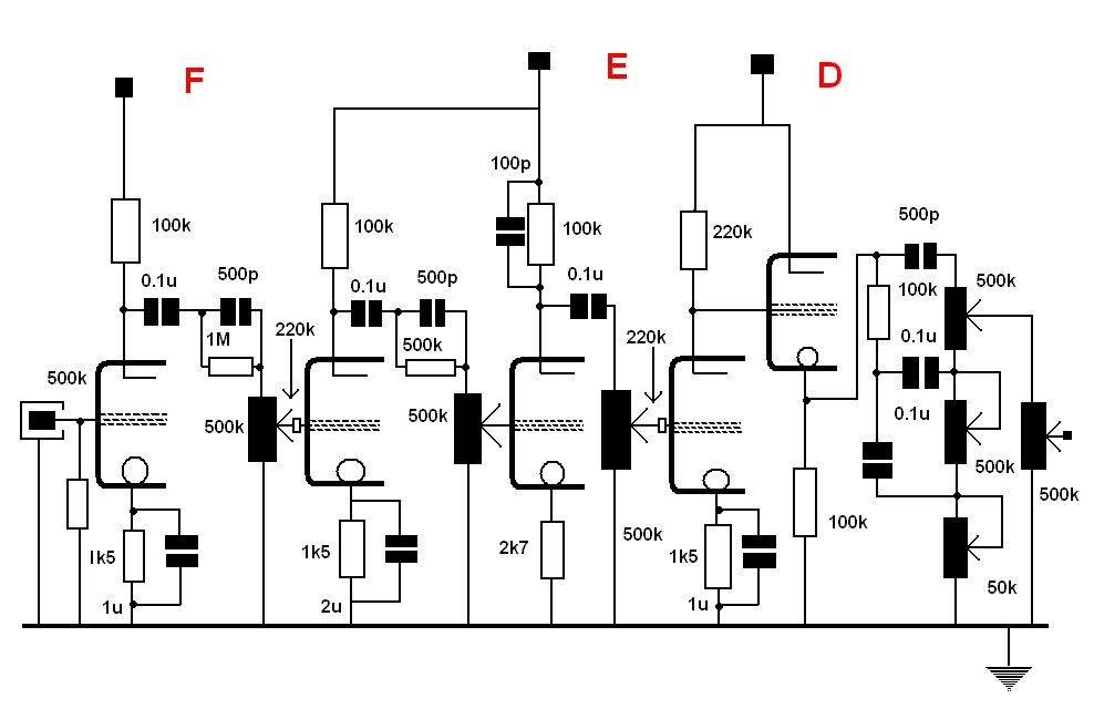

my second design circuit(hifhgain guitar amp)
preamp
