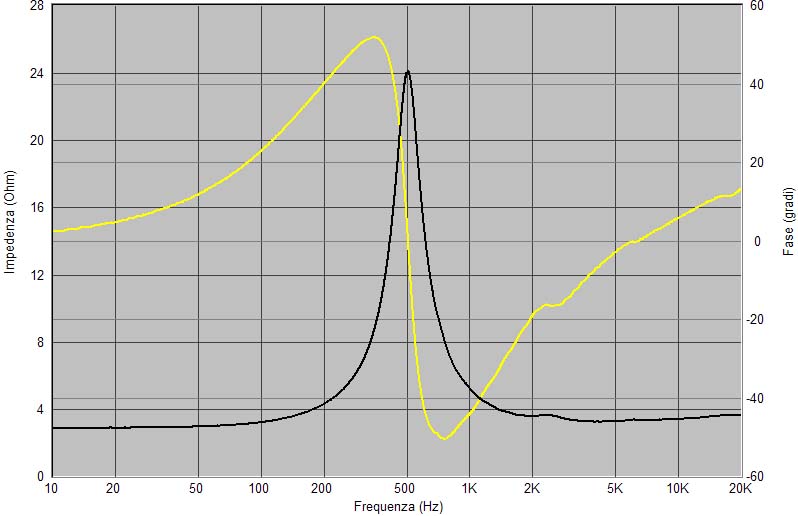

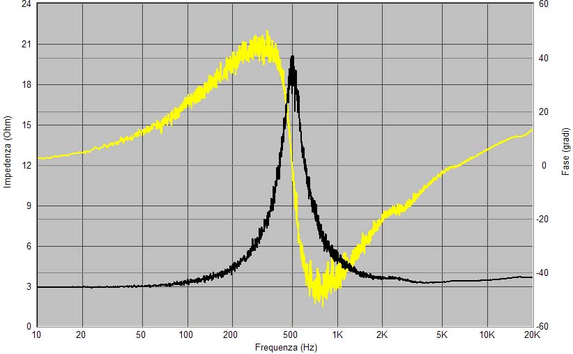

In fact, more than one year ago I bought these tweeters but they had the membrane a bit defective so I asked to SCAN SPEAK to repar them. After 3 months they substituted them and I saw the SPL and I thought it was very good. But now, I measured impedance curve of both speakers and I saw that one speaker have a perfect impedance but the impedance of the other speaker is full of garbage !!!
:bawling: :bawling: :bawling:
I repeated the measurements but it was the same result !!!

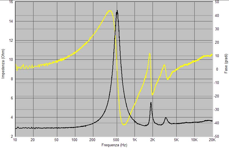

Here are a photo of the impedance measured

Does this tweeter have ferrofluid damping? Perhaps it's been contaminated or, as others have suggested, you have a piece of schmutz in the gap. Also possible that something else inside the tweeter has come loose (hopefully, not a winding of the voice coil!).
Before sending them to SCAN-SPEAK to substitue membranes the impedance curve were perfect for themselves !
But the membrane were a bit scratched so I asked a warranty change of them. Now a TW seems Ok, but the other have this strange impedance.
The tweeter is bad. Looks like a classic loose voice coil turn or something else loose - hence the multiple peaks. I doubt debre in the gap.
At any rate, always us a cap in line with a tweeter. Its effect can be easily seen and removed if desired. But a blown tweeter is virtually unrepairable.
