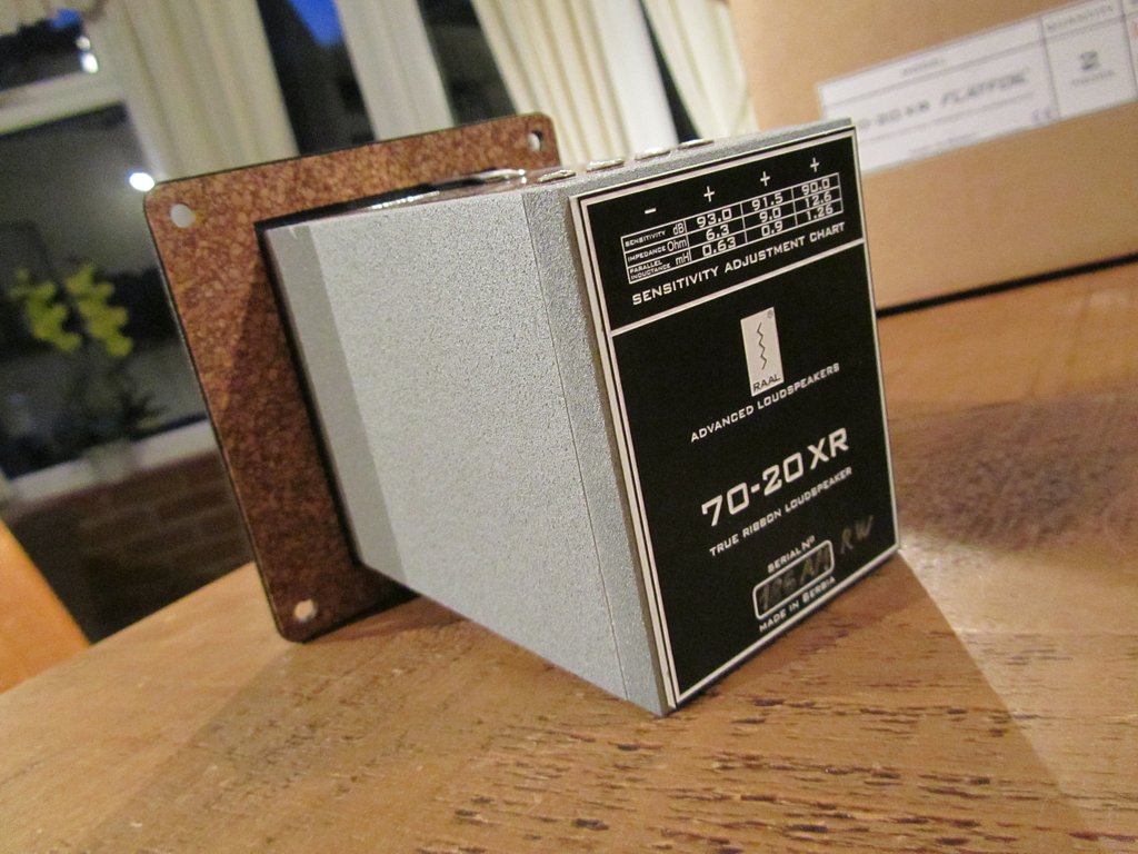

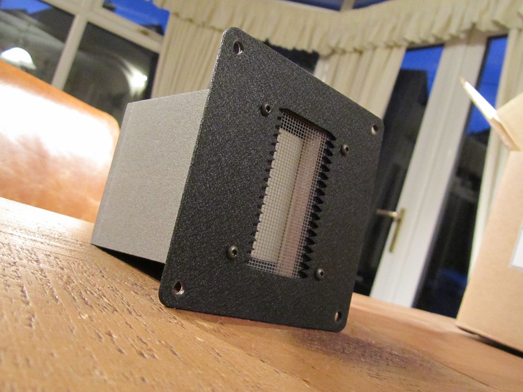

ShinOBIWAN in the UK is using the OEM limited RAAL 70-20XR ribbon tweeter. The shorter physical height plus wider ribbon might be a better match for a 7" midbass than the production RAAL 70-15D you are considering. You can send him a PM for additional information and purchasing options.
Your Scan-Speak AirCirc 6600 dome tweeter is a very, very good choice, but part of DIY is dreaming.
