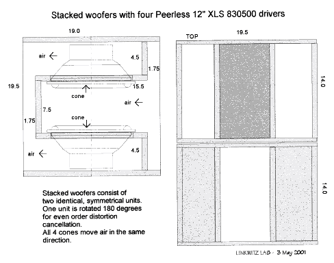

Thanks, .. I don't have a lot of room (floor space specifically), so some sort of compaction is necessary when working with these large drivers to avoid ending up with a wall of speakers, literally speaking !! .
Thanks for clarifying what you mean by impulse compensation. A real W (drivers facing each other would work better but I like the aesthetics of the design with drivers at 90 degrees better. ... sacrifices !!
Would both the arrangements below exhibit it - I still don't get what the advantage of magnet to cone mounting is, compared to cone to cone mounting, as the net moment of force should be similar (though not identical) in both cases?
It's not mainly on magnet to cone or cone to cone - although that also plays a part.
It's the direction of cone movement, which generates a force in the opposite direction. If both cones moves in the same direction (like in a 2 woofer U frame) the forces will sum up. If cones move in opposite directions(as in a ripole), the forces will cancel. Anything else will result in a force that is the vector sum of the two - like in your W baffle.
bzfcocon said:It's not mainly on magnet to cone or cone to cone - although that also plays a part.
I agree and understand that. I'm aware that my 90 degree mounting will result in a net force acting in the horizontal plane. What I want to understand is the pros / cons of symmetric cone to cone (one of my figures, ripole etc ..) vs cone to magnet (linkwitz W) mounting.
I think that is a totally different issue.
The cone to magnet arrangement in Linkwitz's subwoofer should reduce even order distortion, by making one cone move out of the magnet, while the other cone moves into it. The magnetic field in the gap is not perfectly symmetrical around the cone stop position and this arrangement helps correct this to some degree.
bzfcocon said:I think that is a totally different issue.
Thank you, . that is what I wanted to know (".. The magnetic field in the gap is not perfectly symmetrical ..") , .. same operating principle as the so called"push pull" amplifiers.
