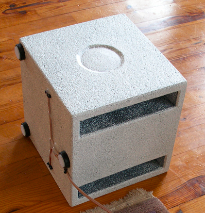

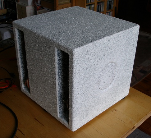

Several years ago, the N or W bass dipole was all the rage, in Germany with the RiPol seal of approval. I had no idea what kind of miracle it was supposed to be, but I liked the cube shape - and after a friend surprised me with his handicraft work, I was surprised too. In the following years I wanted to glue such a frame as a holder for the cheapest chassis: Visaton WS-20E in series connection. This experiment was not about abysmally dry low bass with punch, but simply about feasibility. And the question of feasibility and simulation. In the end I ended up with AkAbak (win16), the only program that really simulates correctly. Unfortunately, Axel won't hand over his script (or the script generator) and AJ-Horn's dad isn't any more helpful when asked, so I has to get to work myself.

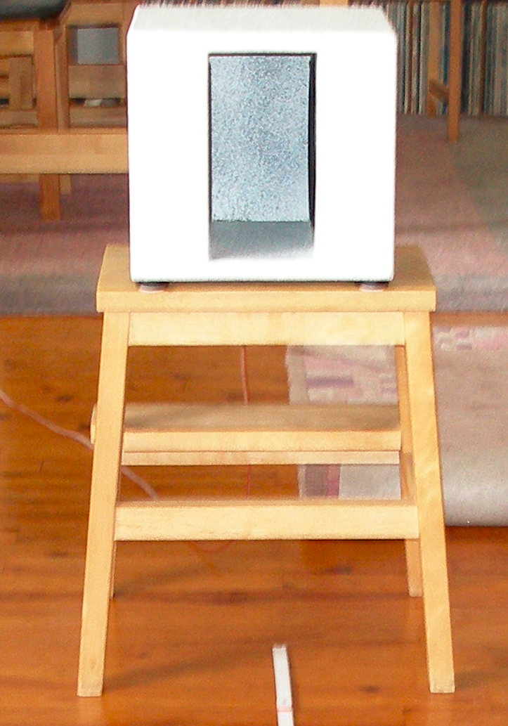

I rediscovered the project almost 14 days ago and since then a mono sub has been working in the living room to support the main loudspeakers whenever I switch on the chinese ReckHorn A409 wonder box.

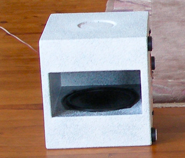

I didn't use x % of Sd and all that nonsense as a benchmark for the chamber sizes, but took the effective diaphragm circumference as a first point of reference. In other words, the rear chamber (Vh & Ah), or the folds, as you like ... has this circumference as an emerging rectangular area as the basis for all subsequent geometric dimensions.
As you can see, the front chamber (Vv & Av) is quite large. Why? Because I wanted a certain broadbandness of the sub-frequency range and no extreme attenuation of the driver's free-air resonance. At the moment the cube is set up to support the stereo speakers extremely cleanly from 20Hz to 100Hz - it acoustically places the instruments on a new acoustic basis. No more and no less, obviously the location and differentiation possibilities of the instruments and voices are very clearly improved. More air, more lightness ... interesting

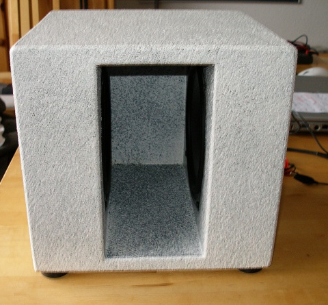

Surface and volume requirements (outside):
W:29,2cm * D:28,4cm
H:27,3cm plus feet
Dimensions:
Front chamber (inside)
W:12cm * D:26.7cm times H:23.2cm
Back chamber (inside), left
W:4.5cm * D:26.7cm times H:23.2cm
Back chamber (inside), right
