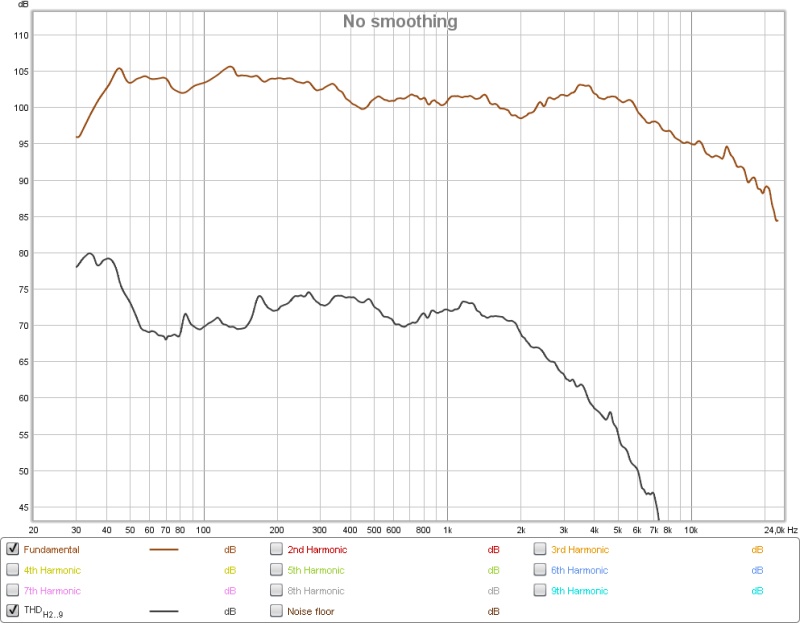

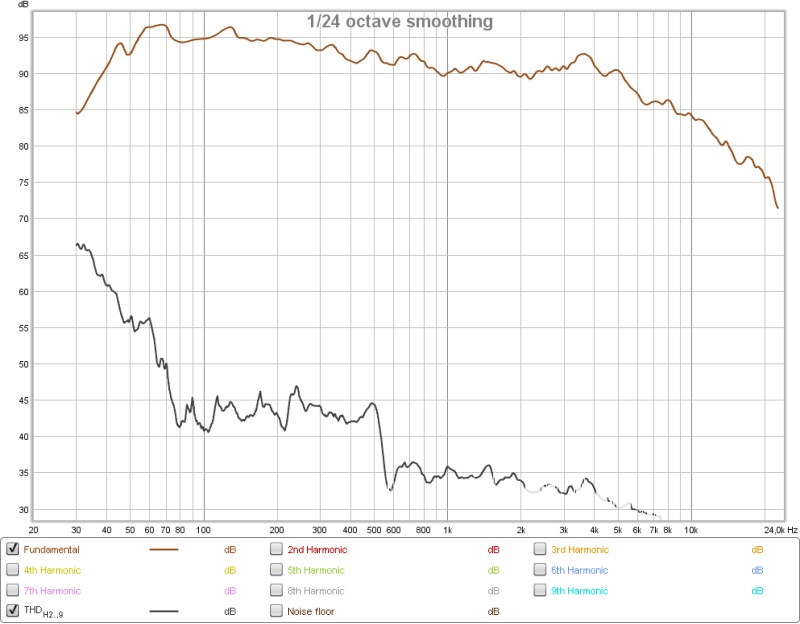

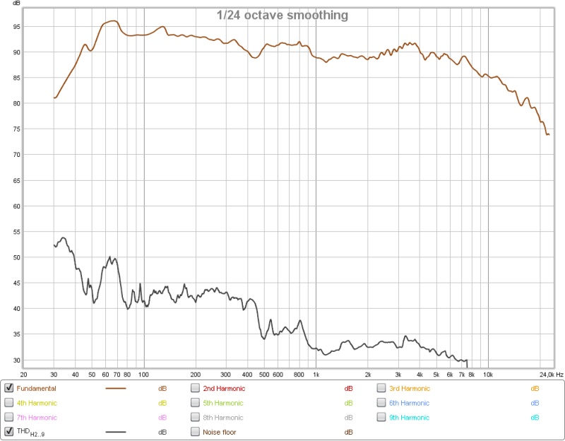

@lupi,

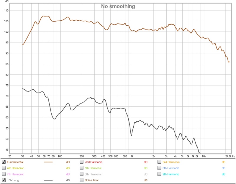

What type of amplifier are you using when testing?
The rolled off high end suggests you are using direct drive without any series resistance. Have you measured the distortion contribution of the amplifier when driving this very low impedance load at each of the output levels?
Also, can you check the boxes below the plot to show the distortion curves for 2nd and 3rd harmonic to see what distortion type is dominant?
Another thought concerns using the swept sine stimulus for distortion measurement. You need to have the signal level near the top of the available range so that that there is enough "bits" available to calculate the distortion properly. You might consider trying to verify the distortion trend with volume level using the spectrum analyzer for a few discrete frequencies.
The amplifier test was the first thing I did. On a resistive load of 0.05 ohm (the ribbon has 0.075 ohms) and at the highest level I used on the ribbon, the THD is always below 50 dB. Lower levels even less. You're right: I do not use resistance in series
Those graphics by mistake I did not save them. I send you one similar graph at the 6.7W level. Distortion is almost the second harmonic.
At the oscilloscope it seems (it's hard to see THD <4%) that the positive halfwave, and always that at all frequencies with high THD, is slightly crushed on the top. Not flat at all, but less sharp then it should. At 0.43W prevails second or third harmonic according to the frequency.
Yes, levels are close to the top, especially for strong signal measurements. I have a single frequency cancellation type distortion meter, and at the beginning I did comparisons with REW. With the bar levels just on the orange they get the best dynamic. In this particular case I did not consider it necessary to make a verification, as the THD is relatively high
lupi
Thanks for the new measurement, and confirmation that you are performing distortion measurements with REW using optimum dynamic range.

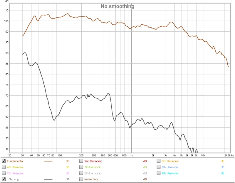

I noticed that the SPL for this new measurement is about 2.5dB higher than the 6.7W measurement in post#36. The distortion is also much higher...about +10dB in the midrange. Is it possible that your microphone was closer to the ribbon for this new measurement than for the older one? If so, I wonder if it is your microphone that is causing the unexpected increase in distortion with signal level. It is not uncommon for electret capsules to generate significant 2nd harmonic content with increased signal level depending on the internal JFET buffer configuration. I noticed this when performing near field woofer distortion tests with some microphones. You mentioned replacing the capsule in you microphone, so perhaps it is related.

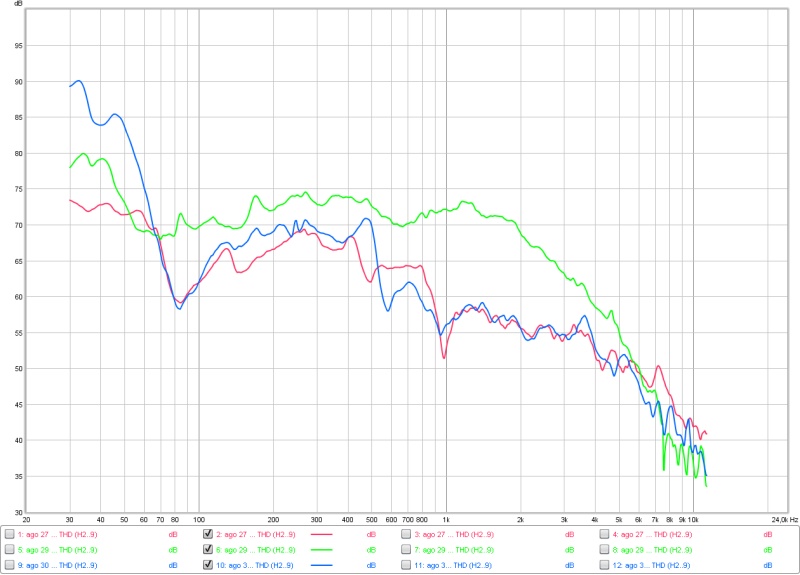

Hi bolserst
It is certainly possible that I have put the microphone at different distances. Always between 3 and 5 cm, but not always the same. I usually write the distance, but as I wrote those curves I did not save them.
A suspicion on the microphone came to me, and I had tried to move it away, but the THD at 6.7W did not diminish. From the last post I made 2 things at one time: I ordered a calibrated microphone, UMIK1, and I built another sandwich ribbon: Alu-depron-Alu, which I've already mounted on the engine. The UMIK1 has already arrived but I did just a few tests on the new ribbon, because of the work. From these tests I have the feeling that the blame of the high THD is to be attributed in part to the microphone and partly to the previous tape. As soon as I finish the job and clean the tables I will do other tests, including reassembling the old tape and making comparisons.

I read linkwitz, which refers to the WM61A capsule. I also ordered some of those capsules, but the delivery is scheduled in a few weeks

To come up with the increase in distortion with the signal level I first bought a new microphone, UMIK1, and performed calibration. Specifics say 1% THD at 133 dB SPL and 0dB gain setting. I've been looking for a "gain setting," but once I load the calibration file, the gain of the sound card has no effect, so I assume I'm in the specifications and I can overlook the microphone distortion.

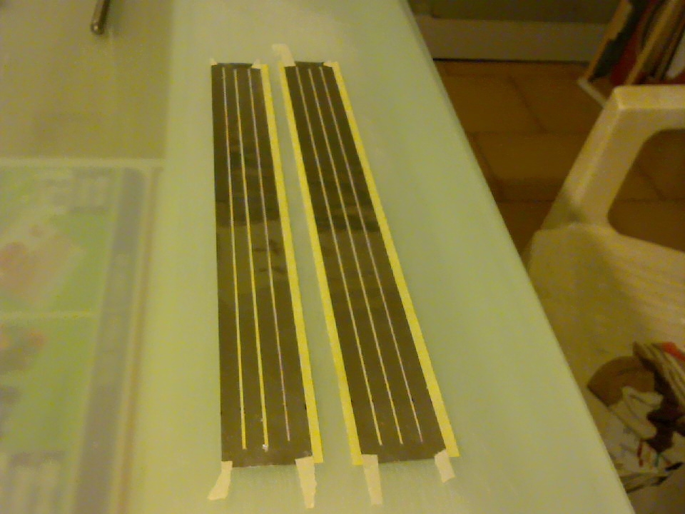

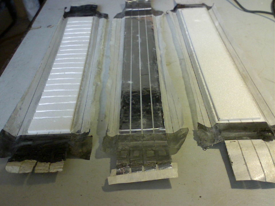

I made measurements on 3 ribbons, which I called risp. Ribb3, ribb4 and ribb 5.
All 3 have the same suspensions, both lateral and at the ends, and are divided into 4 strips electrically connected in series
--- Ribb3 is the one of the last measure I have posted, and it is: Alu thick 80 um + depron thick 3 mm transversally segmented, 0.075 ohm, left in the photo.
--- Ribb4: 30 μm Alu, 1.5 mm depron, 30 μm Alu. The upper Alu strips are welded to the corresponding Alu strips bottom, 0.098 ohms total. At the center of the photo.
--- Ribb5: Alu thick 80 um + depron thick 3 mm smooth, 0.072 ohm, right in the picture.

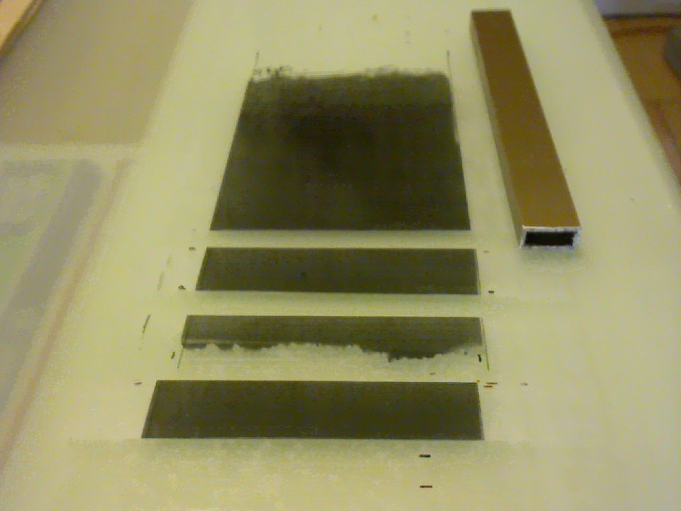

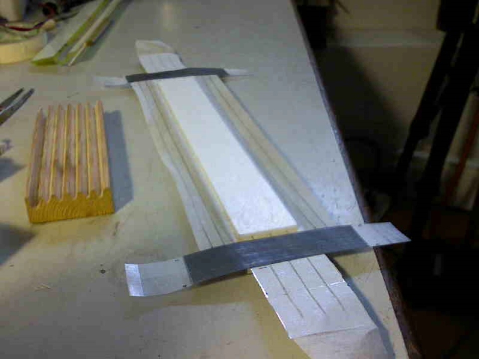

I did some photos while building ribb4:

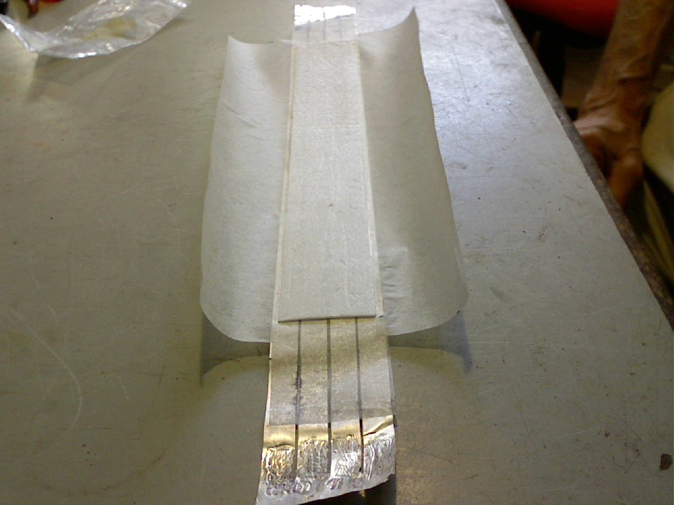

and ribb5:
The mic-ribbon distance is for all curves 7 cm, the signal level is 0.18Veff, so the power on the ribbons is not the same but varies depending on the resistance. Electronic compensation is always present.

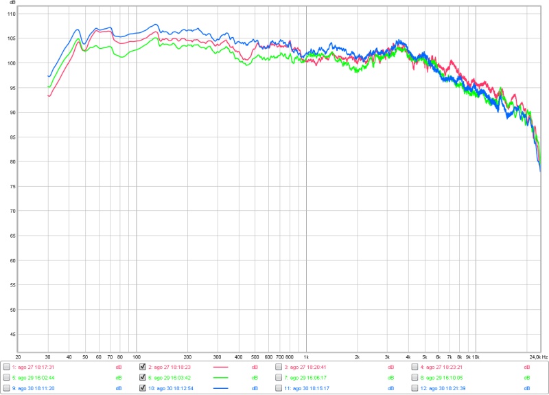

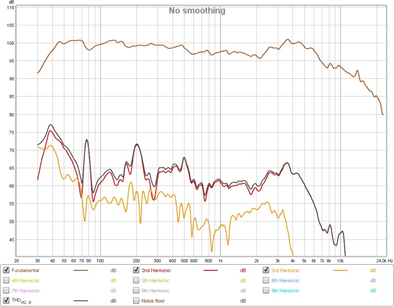

for the 3 graphics below the signal was 0.72Veff
The following graphs compare the SPL and THD of the 3 ribbons in the case of signal = 0.72Veff. Green = ribb3, red = ribb4, blue = ribb5
Ribb4 seems to me the best, especially under 70 Hz, so for the final version I will work for the type of sandwitch construction, though it is substantially more laborious.

To conclude the speech of the increase in distortion by increasing the signal level:
I spent a lot of time comparing the graph made with 2 different microphones, but I did not find significant differences in the THD, so I have to assume it's not a microphone artifact but it's a feature of the ribbons. The reason for this behavior has not been highlighted by the numerous tests I have done on various ribbons, and at this point I am temporarily off topic and continue with the beginning of the construction of the final, 112 cm long and 30 mm wide ribbons. It may be that drastically changing both motor and ribbon the above reason comes out.
I decided to reduce the width from 40 to 30 mm for less directionality, and I compensated for the surface reduction with the increase in length, which I initially placed at 92 cm.

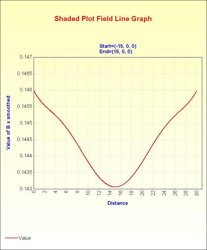

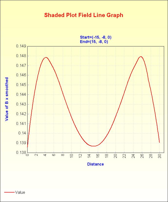

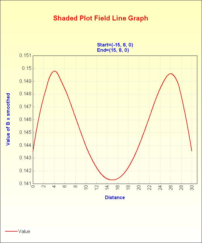

First, I have refined the magnetic field simulations by designing polar expansions as close as possible to reality, that is, with the curves resulting from sheet bending, and adjusting angles, taper and wings length for better uniformity of field . However, I had to choose a compromise, since to improve uniformity over a certain point we have to accept a reduction in the intensity of the field. The picture below is what I decided to accomplish
ribd46real1.pdf
The following 3 charts are for Bx along the 8mm below, center, and 8mm above lines. The maximum Bx excursion across the whole of area is about 8.5%, or, if you prefer, +/- 4.25%.
The uniformity of Bx is greatly influenced by even small changes in the geometry of the wings of the polar pieces, and knowing the precision of the mechanics I realized I should still be within 10% of the total. Going to the realization I ordered to a workshop the U with the angular wings. Initially I made asymmetric angles of 58 ° and 65 °, based on previous simulations.

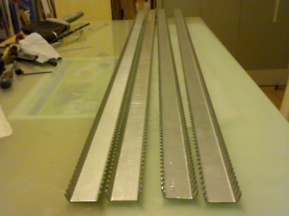

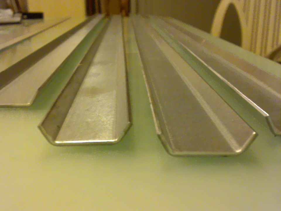

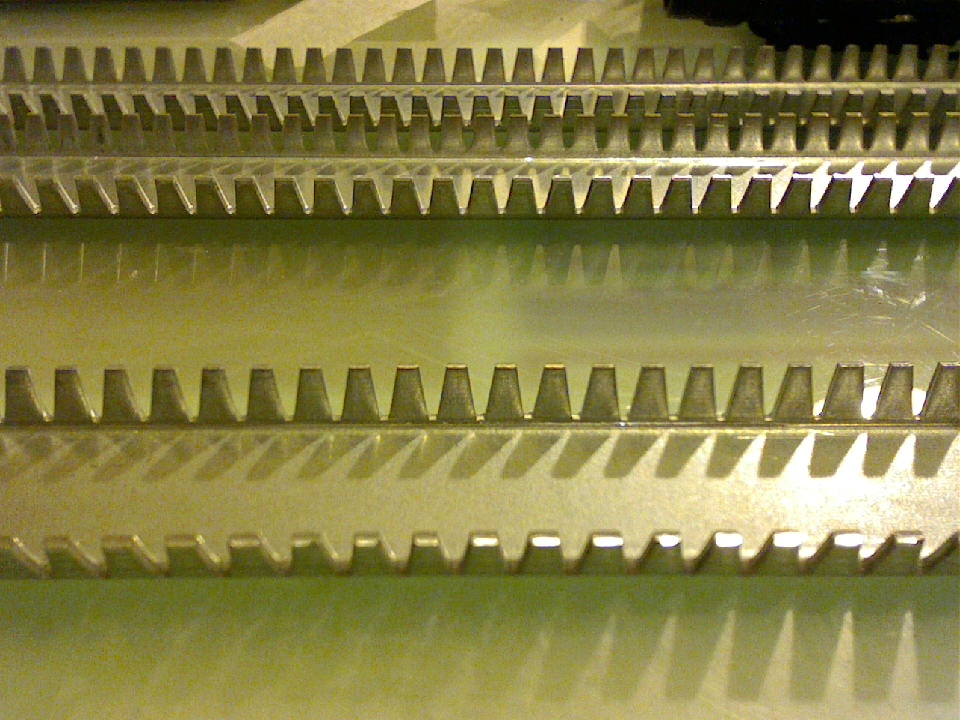

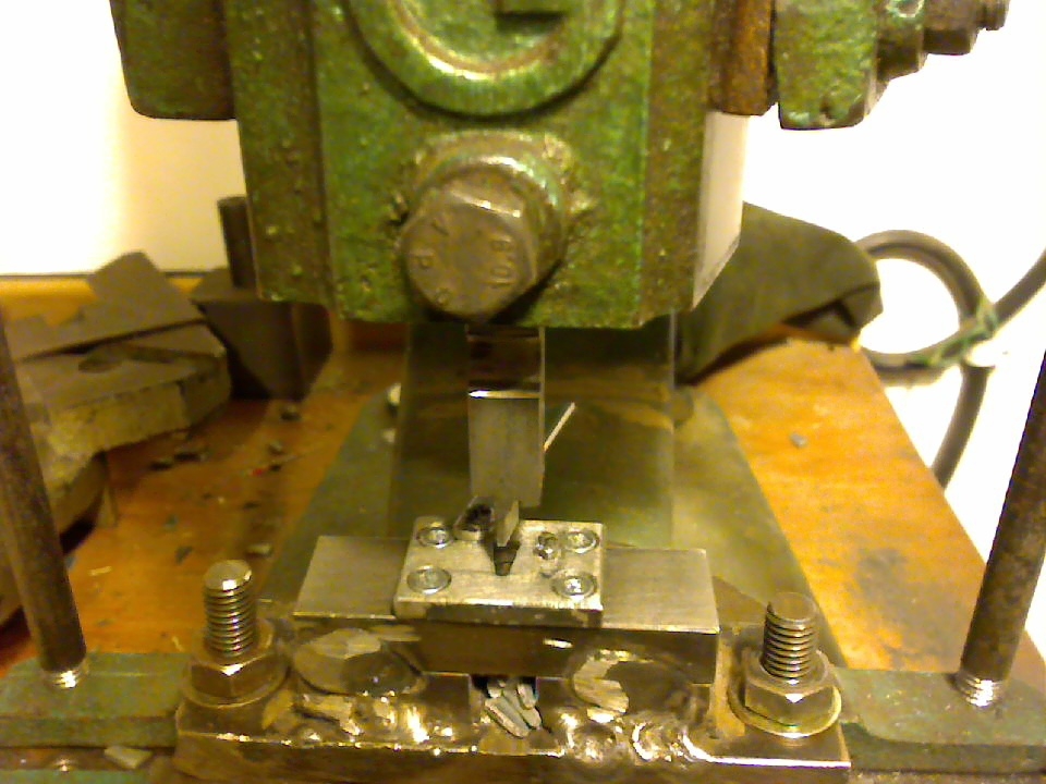

Later on, based on the latest simulations, I returned to the workshop and corrected the angles at 75°, symmetrical. I have tapered the U wings not exactly as by design but virtually, leaving the constant thickness and cutting V-shaped slits so as to minimize also the shadow effect. It's not the same thing but the differences should be small (I hope). I did not control it with a 3d simulation because it would take too, too long
V-cuttings I made them by means of a mold I built for this purpose, mounted on a small manual pressdie
In the end I have the 4 finished polar expansions, painting aside
