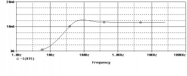

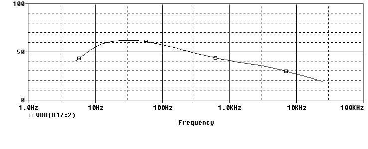

Sorry for delay in answering.
My computer was down and I format my 2 hard disk...
I still don`t know ahy my bass il weak (not as mutch as you can think)
I exclude plate choke because i already use them in my dac. The bass in my dac is ok.
I do 2 error in my schematic. The Zin is not 100K butk 50K (i use two 100k in parallel) And the running current is not 16mA burt 26 mA.
I include a frequency reponse of the value I simulated.
Now. I try to add a 1.8K after the LCR for adding load as suggested by a member. (don`t remember witch one...)
All Eq became worse. Around 8Db error on curve.
I remember when I designed this RIAA setup I had 2 option.
1-A 0 impedance source driving the LRC(600ohm) and finish by a 600 ohm load. then, next stage. This is why we see a cathode folower driving a stepdown transformer to keep Zout as low as possible.
2- a out of 1.8K (of the Zout of your driver, 1.8K in my case) This drive a 1.8K LCR without a ending load. As you see in my other post, the theorical value are good.
I run a simulation and probe the current in the capacitor (6.8uf of the first stage) . As you see, it draw less current in bass area than in high frequency. So the weak bass don`t came by dre driver saturation or difficulty to drive LCR.
I run a test. I add a serial resistor on my powersupply to see the effect on sound. My battery+a 50ohm in serie. I didn`t notice any change in tonal balance. So adding big capacitor on the B+ should not help the bass.
I`m not an expert but I thinkink remove the 470Uf on the cathode and running the 2 stage in superpath. What will be the effect on local feedback (I don`t know how to calculate local feedback in tube circuit.)
I have another theorie for my weak bass. The value of the inductor are nominal value at nominal current. So a LCR don`t draw nominal current in choke. In this case, the value of my inductor will not be correct. My simulation program don`t take this phemomen in account. That could be my problem... but how to fix that...
Does it make sense?
Does it make sense?
Errrr...Not to me but then I never really understood how you got it so close to RIAA spec in the first place.
From what I've seen done with the 600 Ohm version feeding a sim with inverse RIAA network it can be tweeked to ruler flat response.
Every single person writing about these LCR seem to be very insistant on the importance of proper termination.
So I am left very puzzled indeed.
