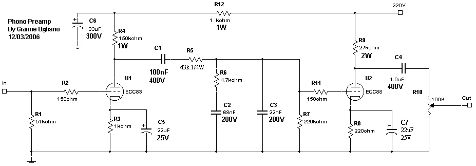

here's the schematic:

It's interesting to do some simulations for the power supply. A few minutes with PSUD will convince you that at these low currents, three cascaded RC sections will have two or three orders of magnitude lower ripple and noise. The Rs are necessarily large values because of the need to drop voltage and that makes ripple currents low. For fun, start with an RC input and two more RC sections with about 3k and 100uF in each section. I like to put small resistors (a few ohms) in series with the filter caps to swamp out any nonideality that they have; in PSUD, you can do that directly in the cap specification. Anyway, that will get you down to a couple of microvolts.

OK, first off, this is an OK schematic right? It's getting a lot of flak from different people, mostly in that the output Z is high (I don't know how to work Pspice so I haven't simmed it), that 12AX7's are bad, that feedback is bad, etc. The guy who built it really seemed to love it, which caught my fancy.
I'm not sure, I just figured 10W was safe. 280V * .003A = .84W so 2W would probably be fine. Thanks for pointing that out 🙂
I also hear I should parallel a 20K resistor to the first 22uF cap in order to get a good current draw?

The resistor is not dropping 280V, it's dropping about 10V. 3mA x 3k, more or less.

What do you mean, the "dynaco format"? Is that the whole idea of building up gain, then using the feedback to cut out the EQ? I'm shopping for a better schematic, so don't feel bad about not pulling any punches 😉
Two 12AX7 in cascade, no buffering of the output or the drive of the feedback loop. There are a couple of variations here, mostly detrimental to performance.
The problem is that an RIAA stage with low noise, accurate equalization, low distortion, and good overload characteristics is hard to do. Morgan Jones's designs in his book seem excellent. So do Allen Wright's in "The Preamp Cookbook." I think he publishes some of these on his website, www.vacuumstate.com . You'll notice cascodes, current sources, complex buffers, and active regulation. Like I said, hard.

I'd look at Allen Wright's FVP or Morgan Jones's Practical Preamplifier. They're reasonably simple, use reasonably easy-to-get parts, and are well-engineered. In the case of Jones's design, it is explained in enough detail that you can make your own adaptions or modifications with confidence.

FVP can be used with MMs. I didn't look at what Allen has at his site, but the schematic in his book indicates that with a 47k input resistor and a 100R resistor in the source of the input FET, the gain and loading are optimized for MM.

sorenj07 said:It's getting a lot of flak from different people, mostly in that the output Z is high (I don't know how to work Pspice so I haven't simmed it), that 12AX7's are bad, that feedback is bad, etc.

First, let us get a few things v-e-r-y right here. The output impedance will be about 1,1K at 1 KHz, 12 K at low frequencies. I do not think that is unduly high.
Secondly, I have seen some inappropriate applications for the 12AX7 in power amplifier input stages, but nobody complains about that. For this application there is nothing wrong with it. It is a low noise low microphony triode.
Thirdly (and something I am getting a bit irritated with - not with members posting here, though), is this feedback-is-bad syndrome. It is only bad in the wrong application in mediocre circuits to begin with. Mostly it is an urban legend perpetuated. Let those who claim this give their technical reasons.
Giaime, I think the cap you are missing is perhaps h.f. attenuation for the RIAA characteristic over the 220K feedback resistor? This is taken care of in the 47K-1N5 network at the input. I prefer the network over the feedback characteristic, but it would need a small series resistor as a supersonic roll-off or a 10 pF cap over the 2nd triode's a-g1 for stability reasons. In the passive application as here the - 3dB point might depend slightly on the phono cartridge's impedance at h.f.
I use this circuit exclusively, merely because the feedback decreases what distortion might occur at headroom signals. But my main reason is because by shaping the coupling time constants instead of just making them large as here, one can also get a very handy 12 dB/octave cut below say 30 Hz. So your very expensive turntable is rumble free? You could get the same rumble-free performance from something for hundreds of $ less by including a rumble filter at no extra cost. Why not? Also it partly safe-guards your expensive loudspeaker from the odd stylus bang.
Unfortunately, Sorenj07, I cannot post my similar circuit just now because I am not at home. I will be able to in a week or so. If you are still interested then, my pleasure. In the meantime, I would say carry on. (The comments you already got regarding the power supply filtering apply.)
One last remark - I have not analysed your dc heater power supply, so again my comment would not be of immediate value, but one must be careful of a too raw dc heater supply. Dc can appear very pious, but one must be careful of proper filtering otherwise the charging spikes can create more noise than would a well laid out ac supply. I have generally not found an advantage (strange as it might seem) unless one uses some 15VAC input with proper filtering (large caps, fairly high series resistor) and uses the heater as a series 12V load. A spikey dc is certainly worse than properly laid-out ac with earthing through a selected mid-point via a parallel some 200 ohm pot.
