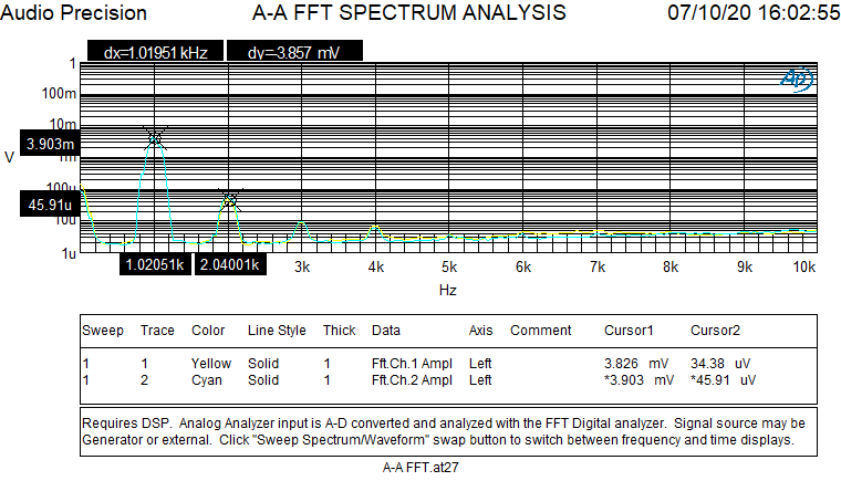

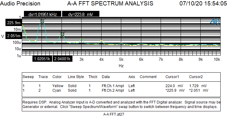

Here's a comparison of the Line-Out (with the internal amplifier) and the Phono-Out. Gain is ~35dB. Comparing the two outputs it would appear that the little phono-pre THD is ~0.1%
