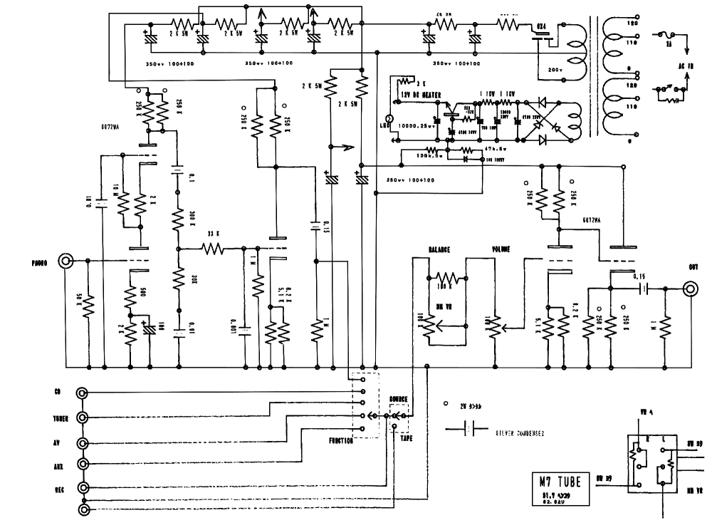

I'didn't connect the resistor from heater to ground, but I've followed the Audionote M7 method as shown below in the picture but I changed all the voltages. Today I've twisted the output wire with another wire and lead to ground, it works . The humming reduces, but still audible, I can feel the speaker driver cone has very weak vibration when I touch the speaker cone. Should I connect the ground from each board to the chasis body? Because right now I only connected the power supply board to the body chasis.

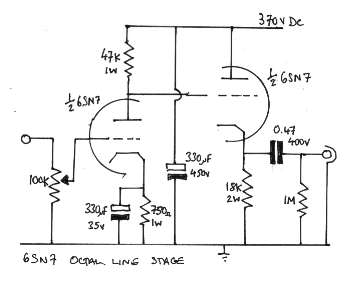

I got 2 schematic diagram and both is very similar, only the 1st stage cathode resistor is different, one is using 750ohm and the other one is using 1.5k, and the input voltage is different. I'm using 750 ohm for the 1st stage cathode resistor, but got humming, don't know whether is the resistor makes my pre-amp humming.
You should lift the filament potential. It may cause it to hum if there is excessive potential difference between cathode and filament.
Of course, the B+ ripple should be very minimal. I would say a CLCLC filtering is extremely good for this kind of line amp.

I used number of 6SN7's in my amp project. I don't have much problem with them except those one made by EH. I had to lift the filament from ground to +80V in order to get rid of the hum. The hum was caused by excessive high potential difference between the cathode and filament.

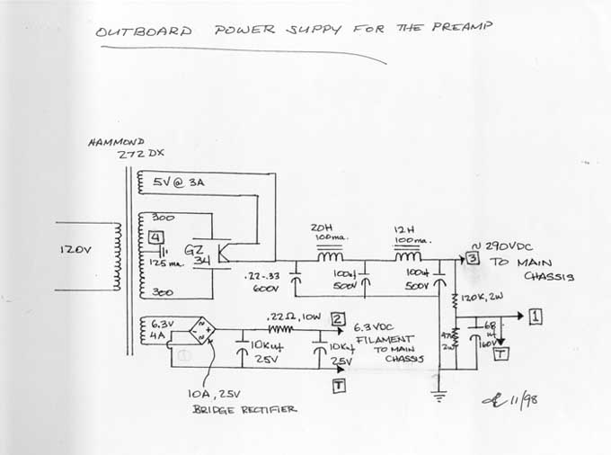

anyway, back to Matt's problem... since even rebuilding your amp did not remove most of the hum, may I suggest that you look into your power supply, I have tried (successfully) using as simple as a 5Y3 and a CRC (22uf-1K-22uf) for a 6sn7gt preamp in the past without any problem. heaters were DC and was lifted about 1/3 of the B+.

so it's hum level is already down if you have to place your ear next to the speakers. anyway, what I meant was a when you series a 100K to a 47K resistor and put their ends to b+ and ground, the junction of the resistors would end up somewhere around 1/3 of the B+. Bypassing the junction to ground also helps in reducing hum if it is still audible. This junction is where you will connect one of the filament rail.
