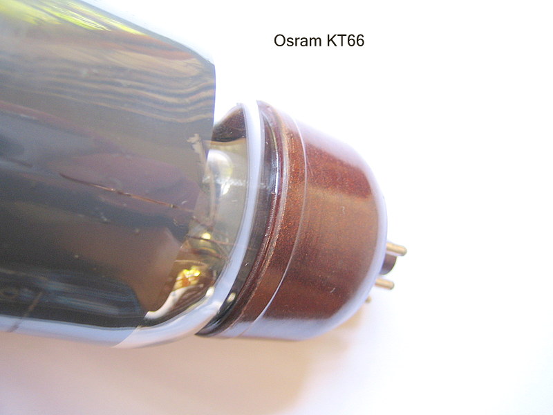

Amp number one is done and currently warming the room. Think I have at least 2 duff kt66 valves and possibly a bad rectifier.
The bakerlite base is loose on one of the KT66s and it creates all kinds of noise....
Another acts like a lighthouse with a winking bright spot. Very festive. It also creates quite a fuss.
If the space between glass and previous seal is not too big, an easy way to reseal is by simply allowing acetone (thinner) to flow in - sparingly! The old sealant is not soluble in acetone, but it does seem to 'soften' it sufficiently to restick. Super clue (cyano-acrelate) is tempting, but there has been an alarming number of reports that the glass cracks at the seal line. The maximum temperature is also too low for power tubes. Other materials like automotive silicone and Araldite have been used.
If the 'looseness' caused a noise on the output, resoldering the leads in the base pins might help.

I agree with Johan's suggestion of repairing loose valve bases with infusing some acetone to re-activate the original adhesive. If I were to do this, I would also rotate the envelope clock and counter clockwise with minute movements only as far as the envelope wires allow. This in order to 'spread' the acetone evenly. This will be a careful, delicate repair in order to avoid not breaking pin wires.
After this procedure, I would also tape up the glass envelope crosswise from the tube's top to the tube's pins with masking tape and allowing the remoisturised original adhesive to set properly for a few days before use. Two suitable elastic bands can also be used inplace of the masking tape.
Before Johan posted his acetone method, I had the same problem (loose bases) with two Osram KT66'es but I used slow setting Araldite (no affiliation) to re-glue.
I carefully cleaned out all loose old adhesive using a watchmakers broach (something like a very slender steel spike). Afterwards, I blew out loose particles between the base and glass and mixed up some Araldite.
I worked the epoxy into the gap, using a sharpened and thinned bamboo toothpick and wiped off the excess with a barely damp lintfree cloth and a bit of lacquer thinners.
Slow setting Araldite will take several days in moderate temperatures to set really hard after about 4 to 5 days.
Here you can see the result.
