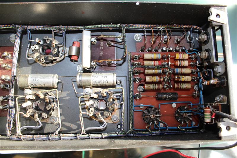

Are the power supply capacitors electrolytics? Somewhere I read they are not, but my source might be wrong.
The power supply capacitor was always a 16 + 16µF 450V dual electrolytic capacitor. It was contained in a round can about 38mm dia x 65mm long. (In comparison a 8µF 700V paper-in-oil capacitor of the time was 123mm x 10mm x 60mm rectangular, far larger. The Quad could not have contained non-polarised caps in that small a place.) Although having occasionally worked on Quad IIs since 1958 I have never seen a different type power supply capacitor.
Electrolytic capacitors were recognisable by the annotation P and E at the 'live' terminals. The "E" capacitor had an etched + foil, thus having a quite bigger foil area and consequently higher capacity for the same physical size. It could however not handle the ripple current of the plain foil type. Thus the P terminal was the input capacitor (at the rectifier side) and the etched foil type the capacitor at the amplifier side of the filter. That arrangement does not appear to exist any longer.

Great info guys and Ideas guys, I now feel the need to be clever and make the upgrades look original.
Have not been feeling up to playing for the last 2 days, but have been thinking a lot about how to make things look nice and stock; it may just be too much effort to achieve what I am after but I am going to give it a test and see what I can come up with.

Perhaps useful: At an early stage sit down and make a list of what it is you are after. Then group the conflicting matters and consider objectively which you prefer, or fit in best with the whole.
If at the end this steers you too far away from the original Quad aims and characteristics/limitations .... rather build a new amplifier. Beware of the quick-sand of a stir-fry result. It is a contradiction that one can suddenly become aware of significant (audible) improvements in a classic circuit of that reputation.

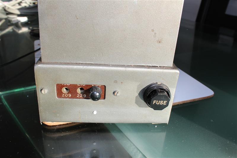

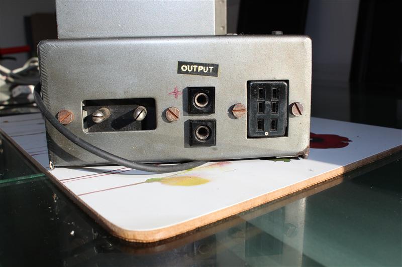

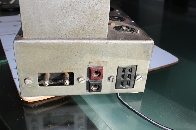

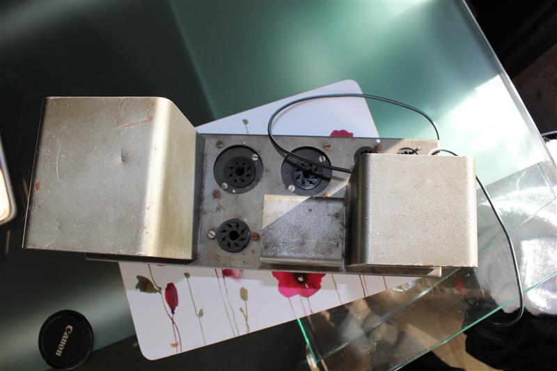

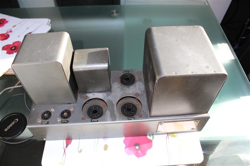

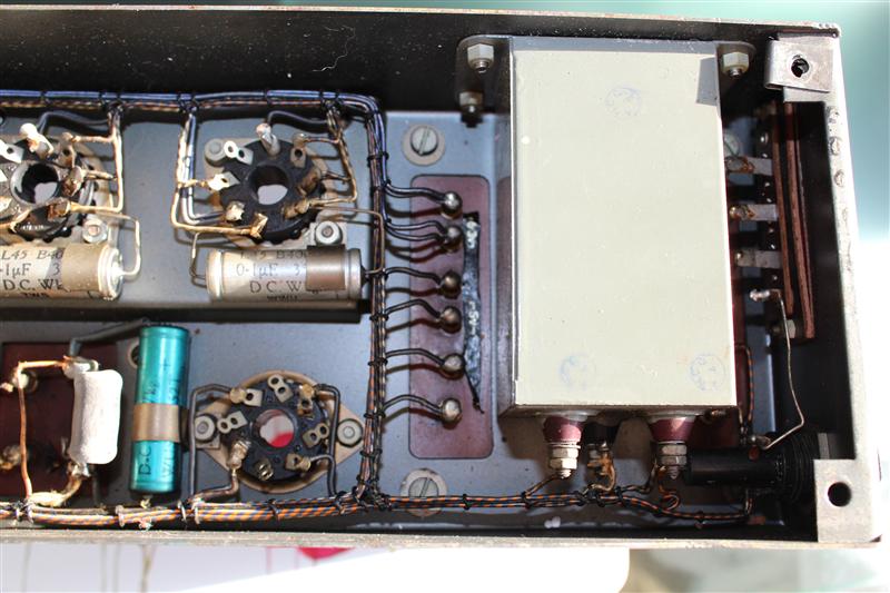

Here is a funny thing, well made me smile anyway;

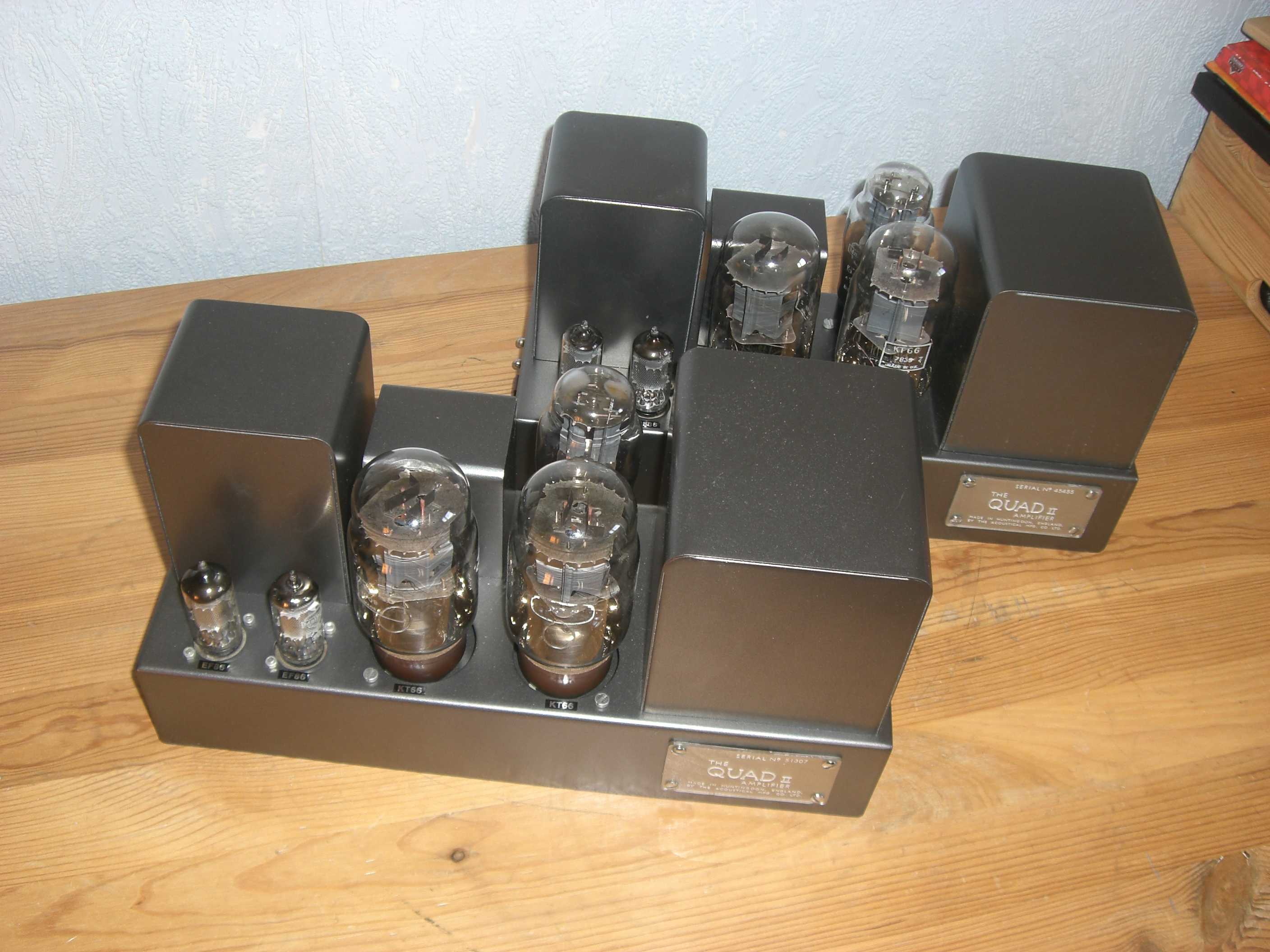

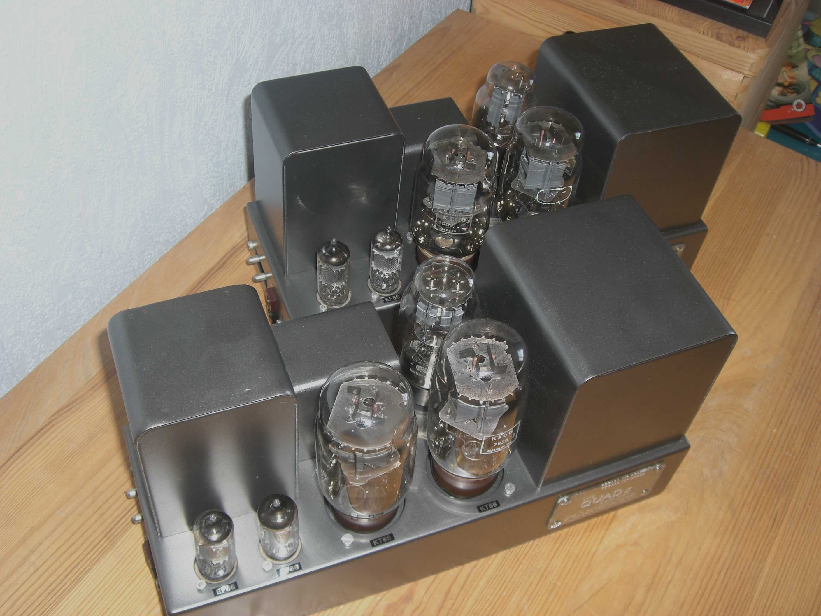

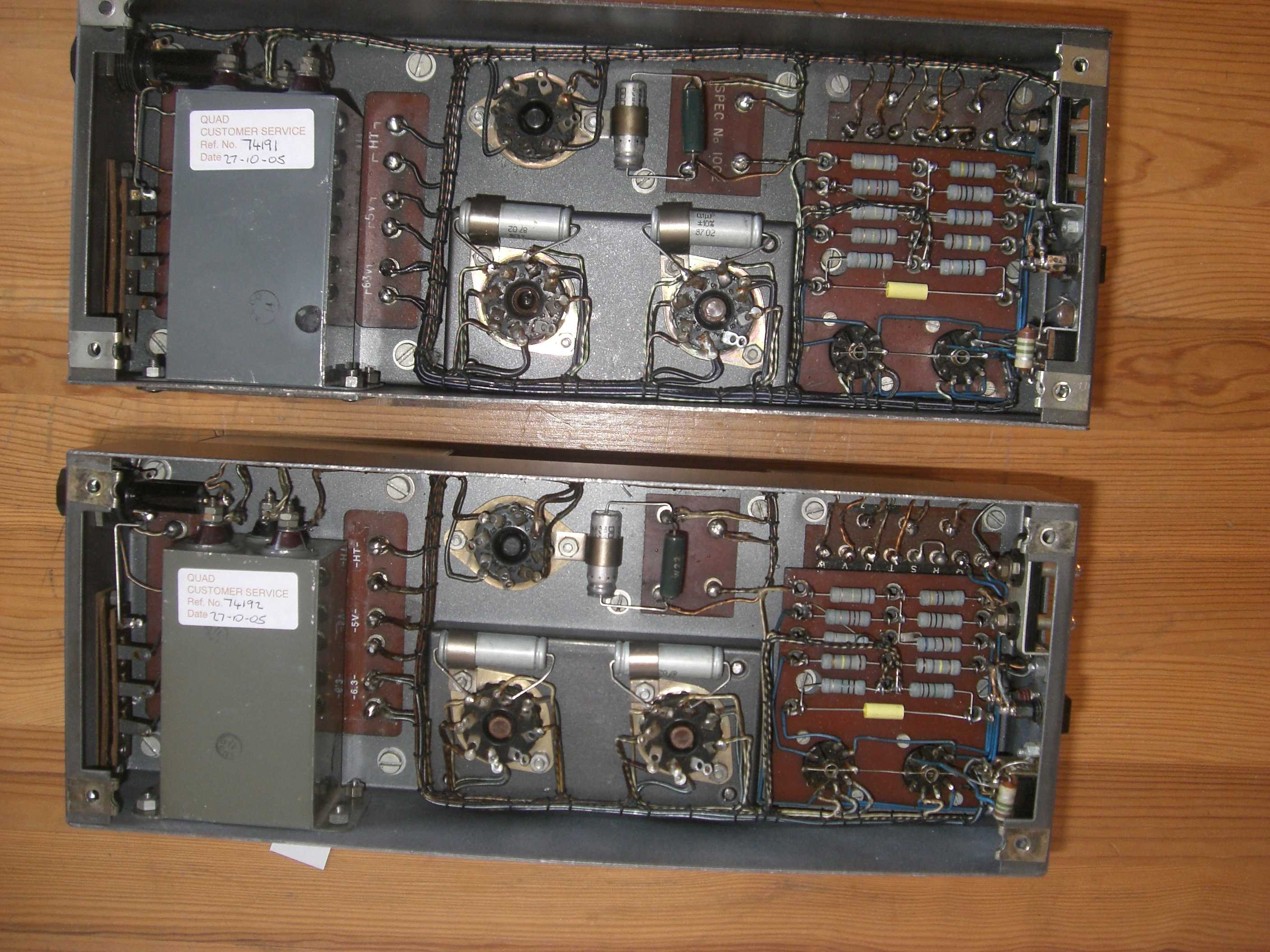

I have been rather unwell over the last 2 years and have lost a fair bit of memory. Since the last 6 months I have been getting back on my feet and got a new workshop up and running a few weeks ago and started to unbox my old projects.
ooooh, a pair of dismantled Quad 2's! After going though and checking the parts were all there (1 bit missing) I decided to have a search around the internet for Quad 2 restorations, I stumbled across this thread and started to read. On page 2 I realised the author was me..... oh my.
Anyway I am back and will continue where I left off, I have done a little over the last week so will update the thread tomorrow with that !
Hi Stuart I am missing the 2 big TCC caps and one of the tag boards, I think they were being worked on before I was ill.
Welcome back! Hope you're feeling better and ready to have at your Quads again! Will be following your restoration with interest. Done a couple myself and FWIW whether PIO, poly or electrolytic caps, the Quads will be just fine and sound great....I had three on the bench once all done to the different cap materials demanded by their owners and you couldn't distinguish the difference between any of them...either subjectively or on the scope.
