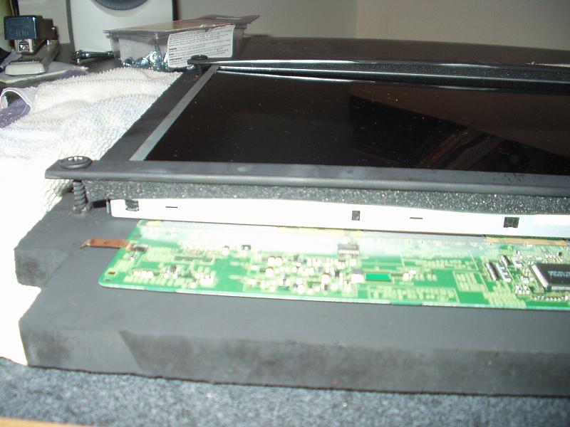

Proview 15.4inch lcd

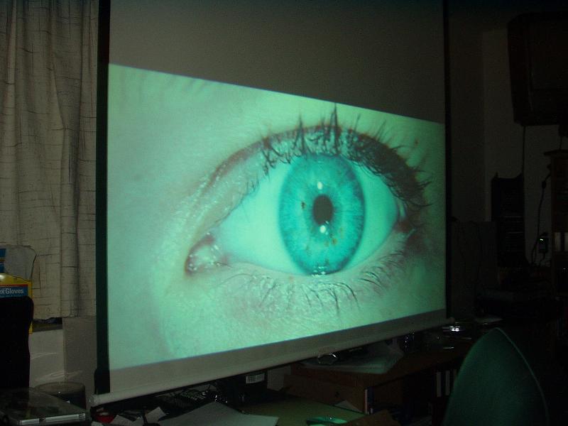

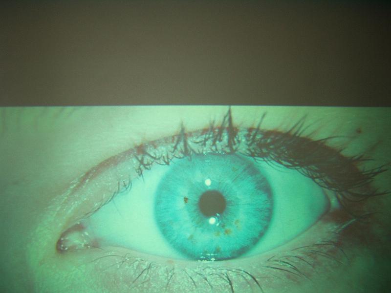

I did a test with Resident Evil Apocalypse where in the beginning it shows a picture of Alice's eye. The detail from the panel was awesome. The two 80mm fans keep the projector running really cool.

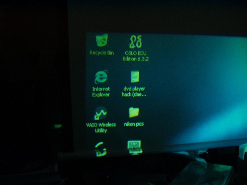

What is great about this monitor is that the montior will maintain the aspect ratio of the input signal and not stretch it out across the entire 1280x800. The image I took, the monitor was in 1024x768 and the corners looked perfect, which is good for playing computer games! You only notice un-focused corners when you are full at 1280x800, guess its the FOV of the 80mm triplet.

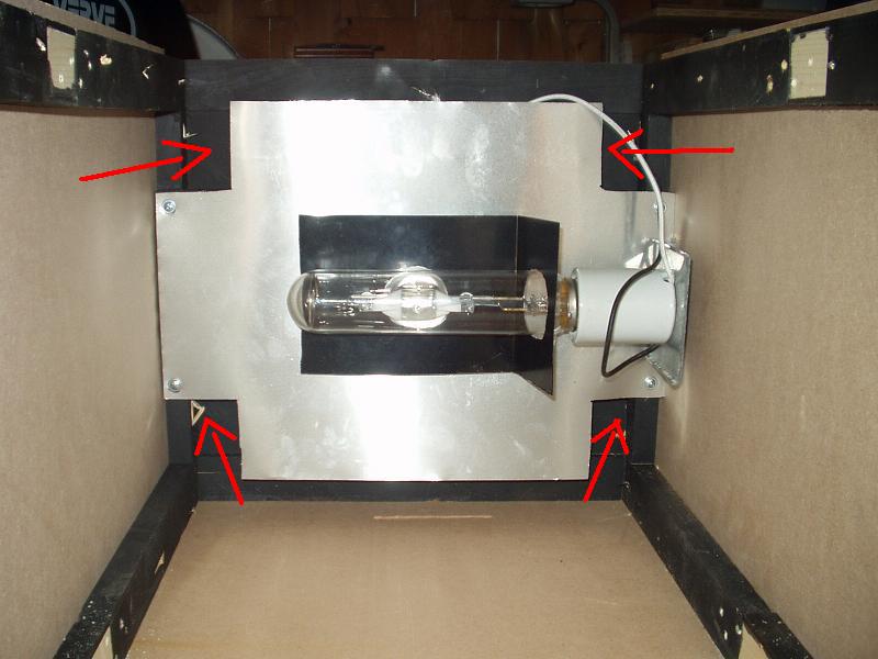

I'll eventually post pictures of the box when I have all the lenses in there permantely with keystone feature/focus movement. I give credit to Inkog for the light box setup with the fans, it works really good. The fans I have (2x80mm right now) are 3000rpm and only 25dba each.
I recently put the box on the ceiling. It's a little heavy, around 35-40 pounds. I will post more pictures and more results as soon as take it down and fix the keystone problem. I hope this encouraged some people to go for this screen, it is really awesome. Here is a shot of the lcd mounted. Rubberfoam weather seal from home depot works wonders 🙂

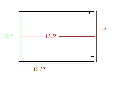

why is your box that big? From another thread, the stripped size was 13 1/4" x 8 3/8", approximately. So technically, you can build a box using 1/2 '' MDF for 14 1/4'' x 9 3/8 '' x whatever length for the lenses right?
That is a good assumption except that you need to incoporate the fresnel lens sizes which should be slightly bigger than the lcd. Then you have the mounts for the lcd and both lenses. But yes, I could make it much smaller, but that will be for a future project. I am just happy this one turned out so good. As for the video, I need to Flaskmpg it because as it stands it is ~7mins long and 150mb
