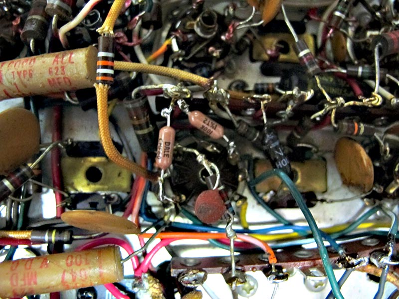

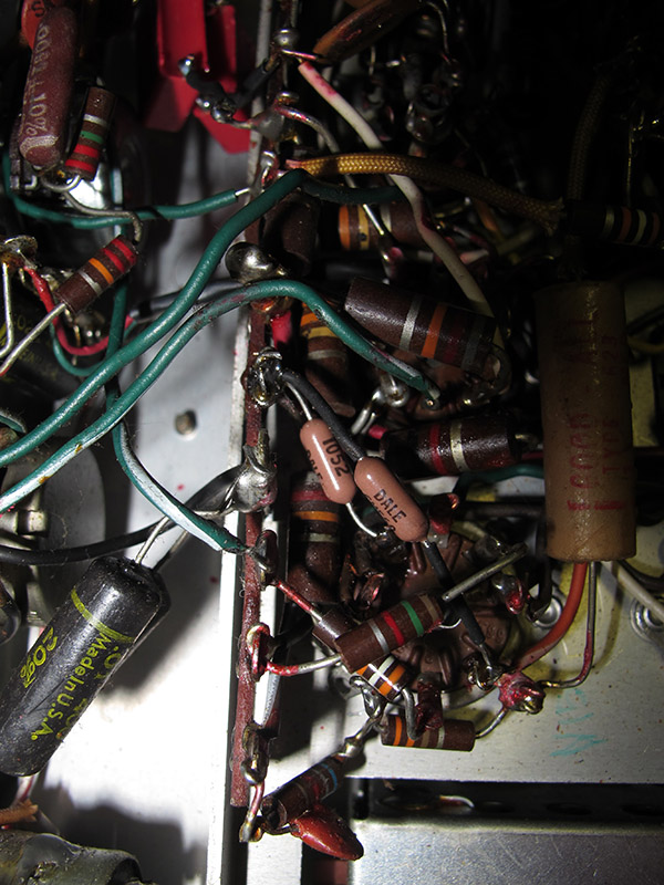

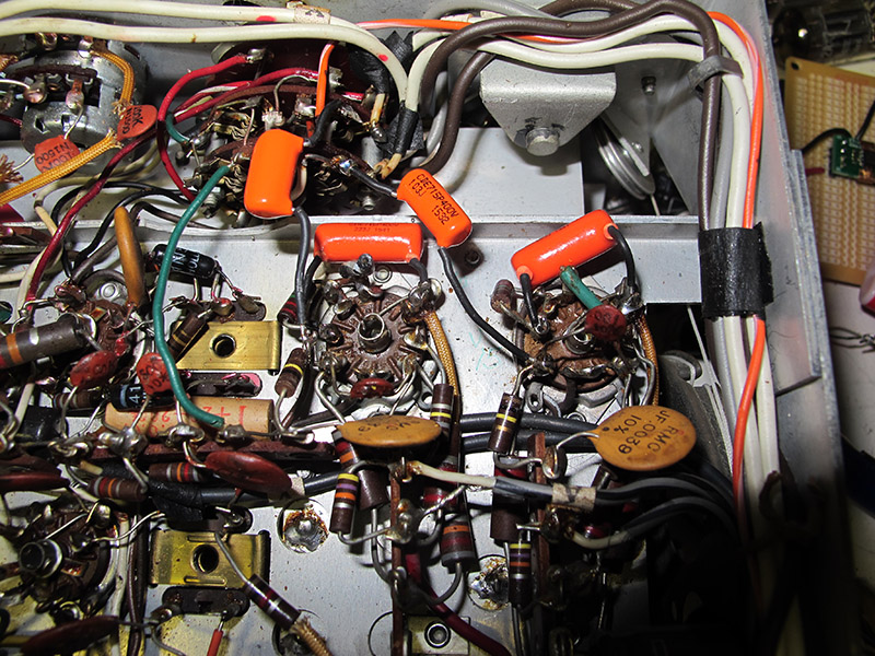

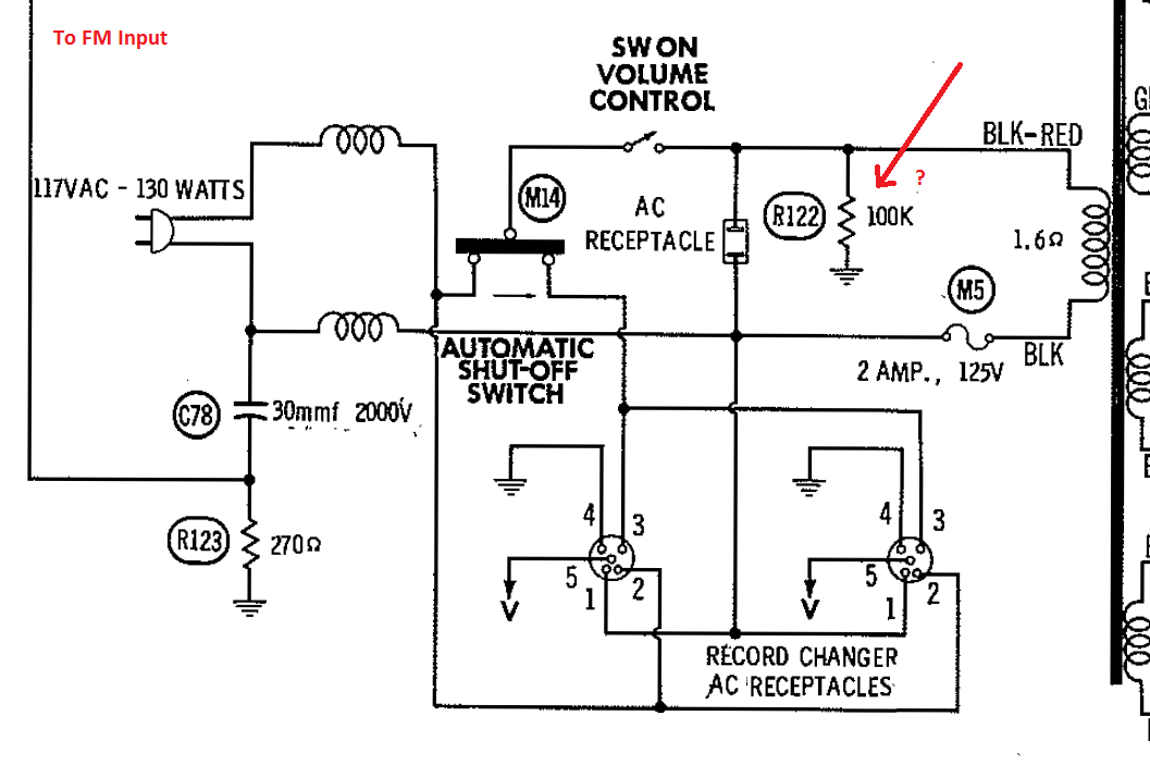

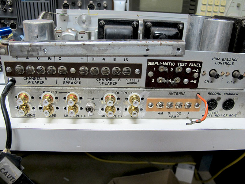

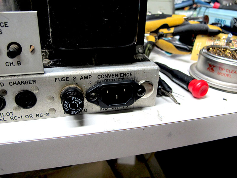

jackinnj Member Joined 2002 tech-diy.com 2017-07-08 4:17 am #21 2017-07-08 4:17 am #21 jackinnj said: New Panasonic ECG 330R resistors in the cathodes, new DC balance pot, replaced the cathode bypass electrolytic cap with 100u 100V Muse. Some results: Click to expand... Correction 50V Muse jackinnj Member Joined 2002 tech-diy.com 2017-07-12 1:49 am #22 2017-07-12 1:49 am #22 Some polypro orange drops, and replaced the phase splitter resistors which were mucho out of balance: Attachments Pilot_OrangeDrops.jpg 249.6 KB · Views: 136 Pilot_AnodeRes1.jpg 137 KB · Views: 144 Pilot_AnodeRes2.jpg 173.6 KB · Views: 143 jackinnj Member Joined 2002 tech-diy.com 2017-08-23 10:21 pm #23 2017-08-23 10:21 pm #23 I wonder if this 100k resistor is to just bleed off a little current when the auto-shutoff is engaged: Attachments Pilot602_AC_In.png 133.4 KB · Views: 142 jackinnj Member Joined 2002 tech-diy.com 2017-08-24 1:34 am #24 2017-08-24 1:34 am #24 RCA Connects replaced, put in a binding post and a standard AC input receptacle, properly polarized: Attachments Pilot602_Back1.jpg 147.1 KB · Views: 121 Pilot602_Back2.jpg 116.8 KB · Views: 99 Prev 1 2 First Prev 2 of 2 Go to page Go Status Not open for further replies. Share: Facebook X (Twitter) LinkedIn Reddit Pinterest Tumblr WhatsApp Email Link
