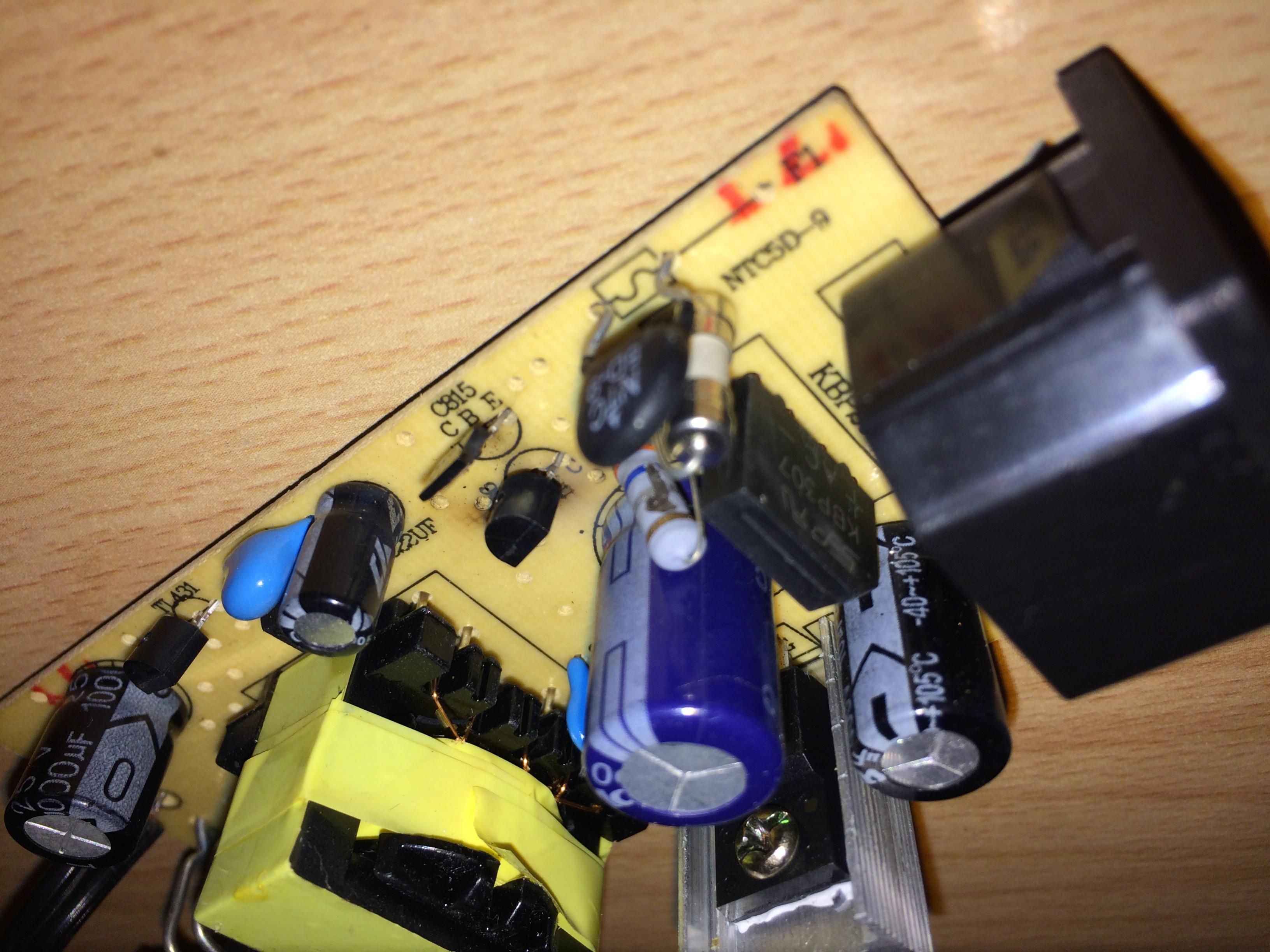

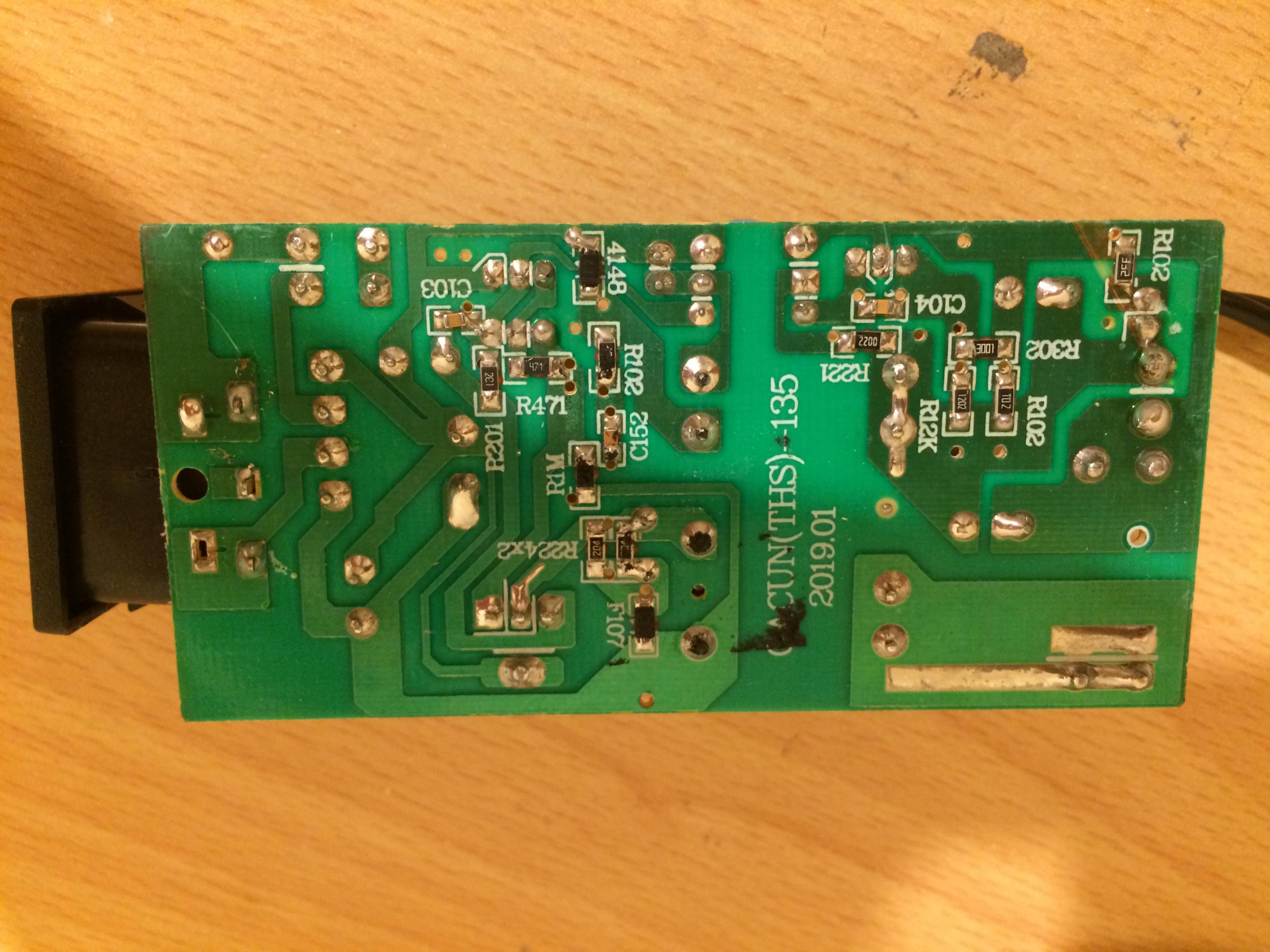

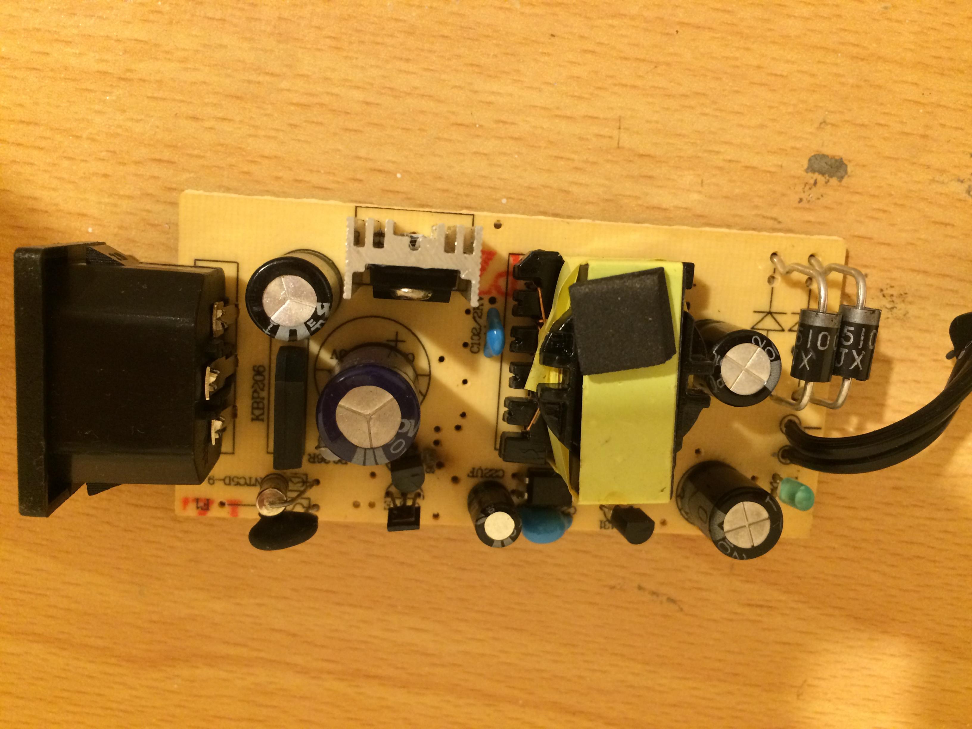

my power-adapter burnt as i plugged it to wall socket

@NareshBrd, the psu burnt as i turned on the electricity , there was nothing connected to it .. i was just trying it as it has a led on it, it immediately burnt, i think maybe internally the polarity was connected in reverse, negative on positive and positive on negative, i was advised as it's from china to check the polarity of it's wiring as it seems to be happened with others but i don't have a multimeter and gave it a try so it happened lol

The failure mode of the first post power adapter is due to a design fault. Input filter is missing, primary side filter capacitors have a high ESR, and the main power mosfet and/or bridge rectifier don't have the required voltage safety margin. If the wall plug contacts are dirty or the power cord is not plugged in firmly, the small arcing due to the initial high current draw will cause a voltage spike on the power mosfet supply rail. This ensures the destruction of the mosfet, the semiconductors connected to the gate of the mosfet and also the low ohmic value power resistor. This part is meant to work as a makeshift fuse, since the real fuse on the input is usually a slow-blow type with excessive rating. The design is not compliant with UL and CE regulations, but unfortunately i've seen it often inside cheap power supplies that don't have a recognizable manufacturer or have a fake label. My first advice to friends that find this type of supplies inside a direct China import package is not to use them. The second advice is to discard them, really. But if they "must" use them, the only way to pospone the demise is to never ever turn off and unplug. The only part that is worth saving may be the plastic enclosoure with the mains connector. I once fitted a DC blocker circuit inside one of these.
yes, for sorrow, although the build quality look so good and the components on the board are very sturdy doesn't wobble and are not messy, looks like a quality thing other than some good adapters i've seen before .. i'll just throw it away avoiding using any of its components that may are defected, i'll just keep the cables and the heatsink and the connector .. someday i should get a multimeter

The 'ceramic capacitor' looks like a Thermistor. NTC = negative temperature coefficient.
Can't make the other out. If it is in series with one of the mains input lines then it will be a fuse.
Fuses like that are not to protect circuitry, they are to protect the user. Semiconductors fail many many times faster than it takes a fuse to blow.
