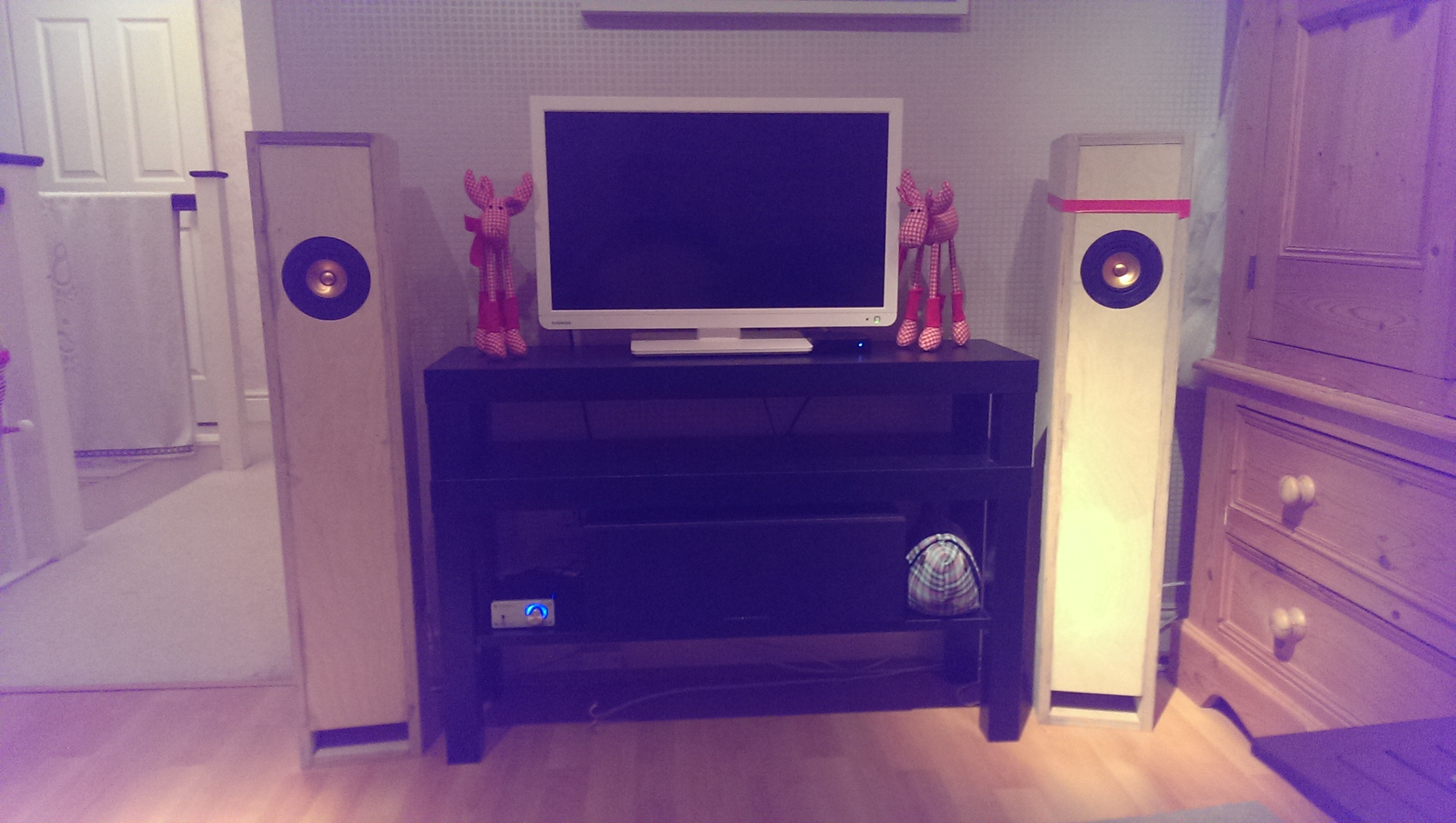

Thanks for the replies.
Looks like I chose the wrong design - should have checked here before committing myself 😱
From further listening, it's clear that I'm not going to get the required bass from this combination.
Adding in my passive woofers and active sub really transforms the sound into something approaching very nice.
The Pensils are pretty huge in the context of my room, so it's a shame that the size doesn't add anything useful except put the drivers at the correct height.
So, my thinking is to either:
1. Use the drivers in a new mini enclosure that can sit on my existing stands.
or
2. modify the pensils to make a smaller enclosure within the pensil enclosure (sealed or BR or other) with internal bulkheads - perhaps I can then add some passive woofers into the bottom half of the enclosure?
What do you think?

Martin: to echo northernsky (and my own earlier note), you can expect some overall improvement after the rather lengthy break-in, but it won't be a life changing experience.
Due to the limited floorspace seen in your photo for additional woofer enclosures, and the time/materials invested in the Pensils, if you still find them lacking after break-in, I'd be inclined to modify them, and add small woofers to turn them into a 2-way system. I personally like XO below the telephone band, but that tends to make component values for passive filters rather large, and costly if using films, etc. First candidate driver I can think of would be one of the 6" SilverFlutes or locally available equivalent, mounted on side panel.
Before that, though - would there be an opportunity to test these enclosures in an entirely different system - say a friend / relative's? It's always nice to isolate a problem / confirm the diagnosis before attempting a cure.

Hello and Happy New Year to you all!
Finally got back to my partially run-in A6m pensils and am beginning to appreciate their charms. They are certainly an easy listen and really get my foot tapping, which is my unscientific way of telling if I like them or not 😉
So, my plan is to forget about the LF extension and use them with my active sub, crossing over at about 120hz.
What I'd like to do is partition off the pensil enclosure to form a smaller sealed or ported box within the pensil box. Later I'll either cut the pensils down to make a pair of small stand mounters or add a helper woofer to the bottom section.
My question is, if I put a plastic tube behind the A6m or a couple of 18mm ply partitions inside, what is the ideal/optimal box size for this driver?
e.g. If I put a 120mm dia PVC tube behind the driver and seal it, I'll get a volume of only around 1.6 litres, less the volume of the driver itself. Seems a bit small?
Any ideas?
Martin
Any ideas?
Martin
I just made a simulation using winISD and the optimum vented enclosure looks to be 3.9 litres with a single port dia 25mm x 65mm long.
If I put 2 bulkheads in the pensil 6 enclosure, 200mm apart, I should get to 3.9 litres.
Do I need to compensate for the driver and port volumes?
Do the above figures look about right? I also have tuning frequency of 66.97 Hz and Ql of 7.00. There's also vent match of 0.13.
Martin
Martin
Greets!
Different programs calculate different alignments depending on several things, so having a 'bigger is better' [BIB] philosophy, the largest I get is ~4.716 L net/61.85 Hz Fb using the published Mmd, Cms, BL in lieu of Fs, Qes, Cms, Qts for Hornresp to calculate a bit more technically correct set of specs:
Fs = 61.38 Hz
Qes = 0.46
Qts = 0.4
Vas = 4.85 L
Factoring in a 2nd order 120 Hz high pass and a ~14 W acceptable THD limit, the vent can be reduced to 19 mm diameter x ~33 mm long.
Note that <5% vent mach is the goal, though 10% for subsis often good enough for most folks.
Yes, ideally the volume of the driver, vent, bracing, etc., should be added to the calculated net cab volume [Vb].
